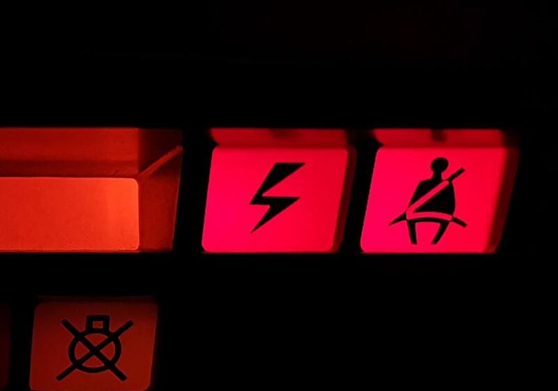

Alternator bulb can always be converted to LED providing an exciter resistor is put in parallel. Actually how many modern cars do it out of the factory with LED dashes.
Useful to know.  Figured something like that would work, just not something I'd ever given much thought to before.  The old school symbology used on the ignition light on this car pleases me far too much.
Confusingly the battery symbol is also present on the dash - it however is an overcharge warning.
They're labelled backwards in the handbook too!  I'm chalking that up to British Car Syndrome I think.

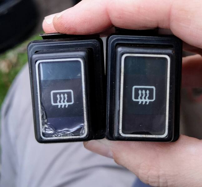

While digging around for something else I came across someone on eBay who had some switches available for a sensible price, so have ordered replacements for the rear window heater and main interior light switches as mine have cracked lenses.
There is a little crazing in the other two but it's not noticeable unless you're looking closely, whereas these ones look horrible just now.

My Scimitars (SE6 & 6a) had that lightning bolt no charge warning. So did Bedford TKs with the later round dials. Most other old British cars I've been in had a red light with IGN under it.

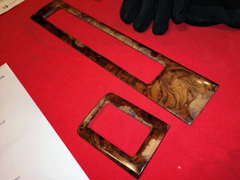

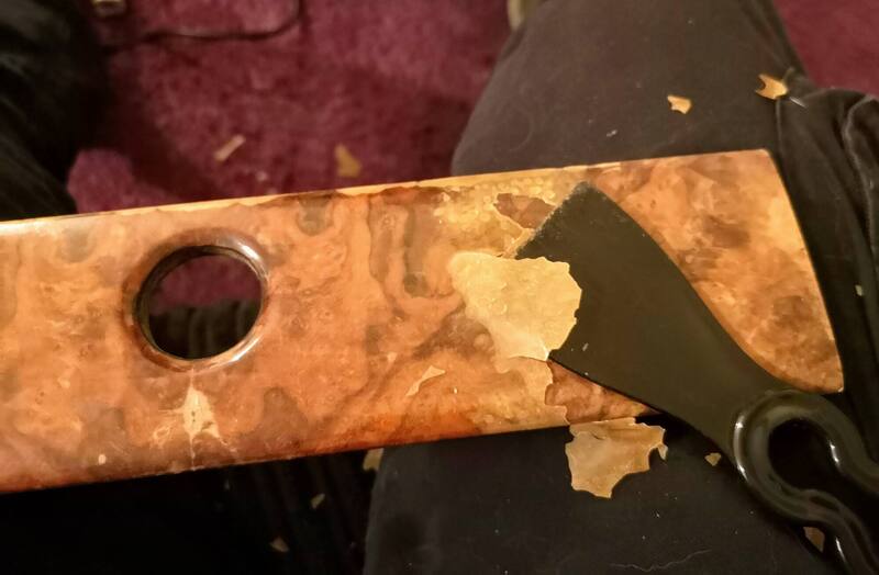

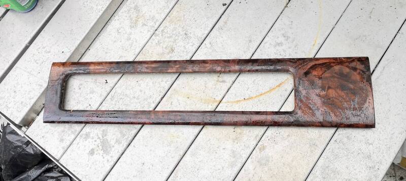

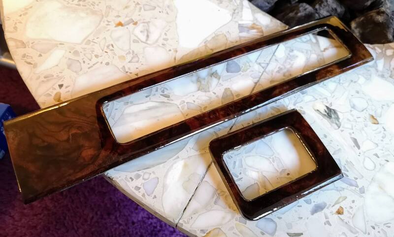

After quite a bit of experimentation I eventually came to the conclusion that the correct formula required to remove the old finish from the woodwork is a combination of carefully applied heat and patience. I'm sure if I could get hold of some proper old school Nitromors (the can we thought I'd found it turned out had dissolved the bottom out of the tin) or similar I'm sure it would be sorted in minutes...but the modern water based nonsense is a total waste of space when up against what I am pretty sure at this point is a polyeurythane clearcoat.

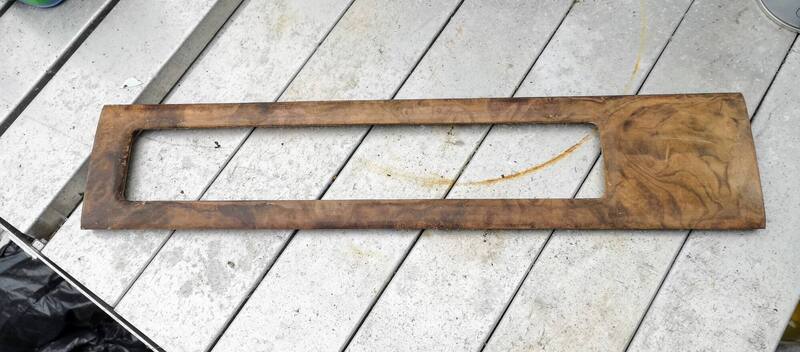

The starting point:
After the old clear coat had been removed it was given a gentle rub down with 1200 grit sand paper just to remove any bits I had missed and to key the surface ready for the application of the new coating.
Which is a little disheartening to be honest as it ends up looking awful when the first couple of coats are applied.
However after a few coats it did start to look better, though spraying one coat when the ambient temperature was too cold resulted in a satin-like finish at close of play a couple of days ago.
Today though it felt like we actually made decent progress towards it looking decent, reasonably warm but breezy weather was ideal to get several coats added to it which has resulted in a pretty decent finish.
I think this one better demonstrates the degree of gloss we've managed to attain (even though the camera has helpfully focused on the wrong surface).
Those pieces are sitting in the spare room just now safely tucked away while the clearcoat fully hardens. Given I now have a workflow which works reasonably well for this I'll look to get the remaining trim removed and put through a similar treatment shortly. While this isn't maybe a factory perfect finish I think it's fair to say that it will look a whole lot better in the car than the flaky mess that's currently in there.

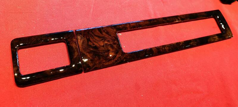

Got the first two bits of trim refitted into the Jag now.  Think it's fair to say it will be worth the effort once it's all back in place.
Glovebox lid and the trim from the offside air vent are now on the operating table waiting their turn.

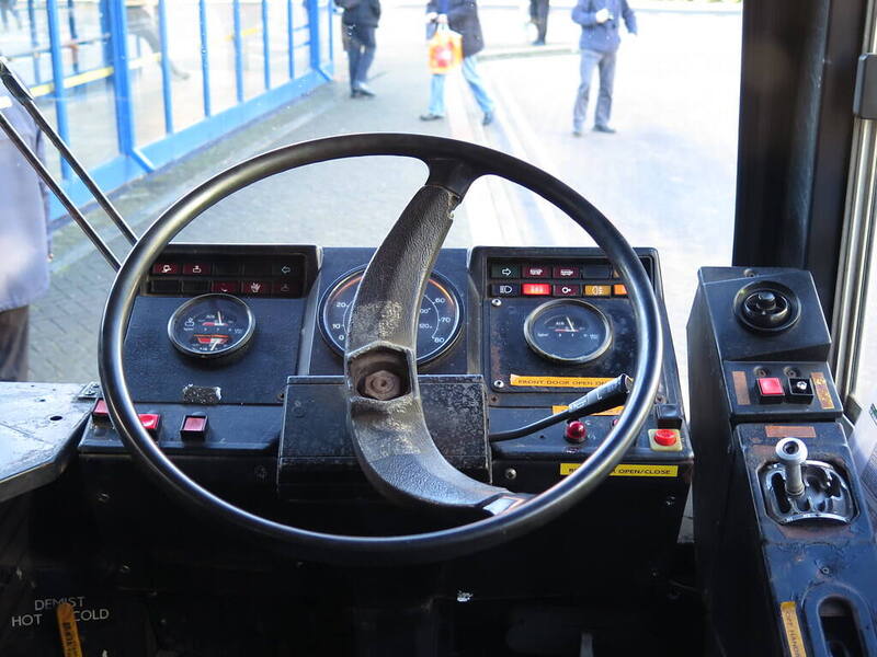

For those wondering what we are on about regarding the nicely integrated Bedford instrumentation... here's a nice clean example courtesy of VPR17X snapped at a show a few years back.
If memory serves, the ignition/no charge lamp which started the random tangent is immediately to the right of the large central warning light at the bottom of the cluster.  Which given it's probably fifteen years since I last sat behind the wheel of one is rather sad to think I can remember nonsense like that...

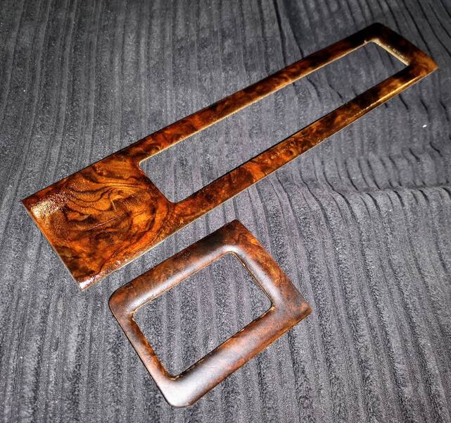

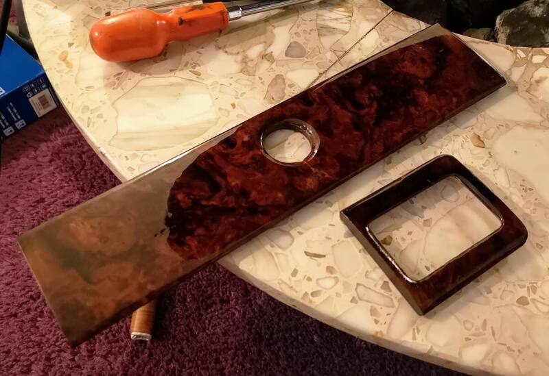

The offside air vent surround and the glove box lid have now been stripped back and are waiting their turn to be resprayed tomorrow.
I'll be finding bits of this stuff for years.
Having never been behind the wheel of anything newer than 83/4 A-reg when it comes to buses, all the other Leyland machinery have driven (which isn’t much) had had this instrument configuration.
I think the National 2 used this gauge and light arrangement, the two Titans and early Olympian I have driven certainly did. All ex-LT stock so there may be variances for individual operators.
It has been 5+ years since I last drove a bus. All semi-auto. Would love to get my hands on an Ailsa, especially a screaming on with an SCG 5-speeder
Yep, National 2 used the same setup of the Olympian etc you've shown there.  Got a whole set of those warning lights from a scrapped in the past and have used them in a few random locations over the years.
Glove box lid and offside air vent surround have had their first three coats of lacquer today.
Will probably get the same again tomorrow then be ready to be refitted.

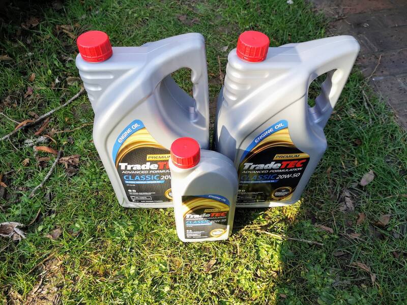

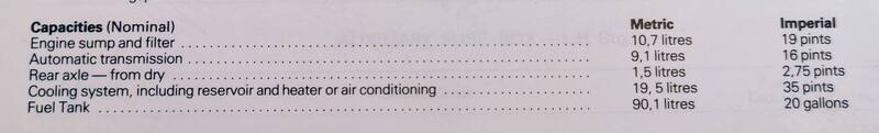

What is the oil capacity on this Zel? And what grade is it meant to run on? Thanks.
10.7 litres of 10W/40 or 15W/40 looks like according to the handbook.
Hot damn, that takes more than the boat-anchor bolted into mine. I'm guessing it has large filters and an oil cooler for the engine to add capacity also.

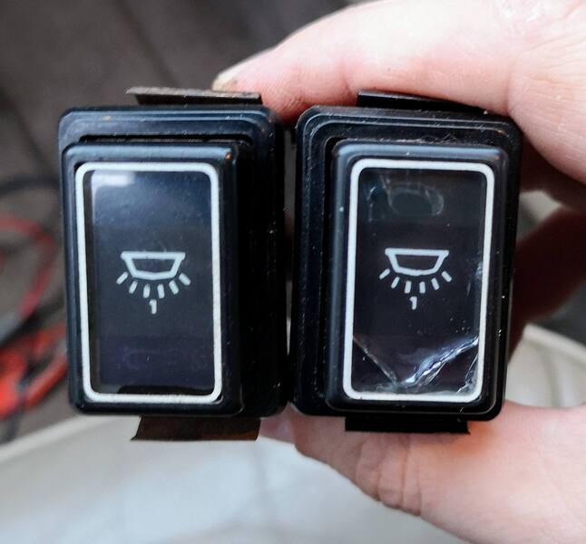

This morning a little parcel arrived containing the replacement switches.
Not hard to spot the difference.
The other two have a little bit of crazing in the lenses but nothing that sticks out so badly so I'll keep my eyes peeled for a hazard and interior light 2 switch turning up cheap.  I'm guessing these are prone to cracking like this based on the mental prices that new ones seem to be advertised at on eBay.  I don't care how special you think it is..I ain't paying £75 for a switch!

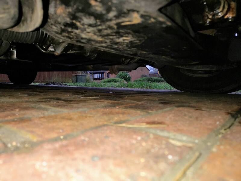

Then having a hunt for the oil leak.

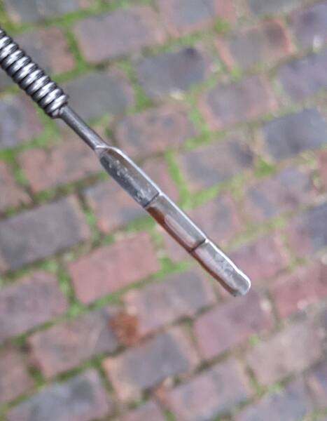

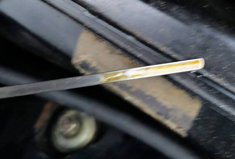

Engine oil level hasn't visibly moved on the dipstick...
(Reads slightly high due to the slope of our drive).
Nor has the ATF, which is slightly overfilled if anything.
The power steering fluid is on the "Add" mark, but hasn't moved since the car arrived here.

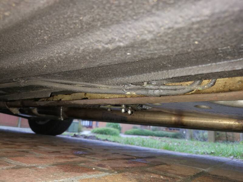

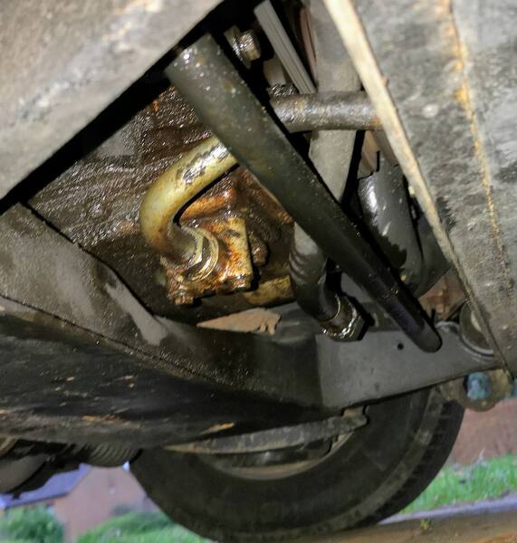

Looking underneath the car didn't immediately reveal anything obvious.  The marks on the ground were from where oil has dropped from the exhaust fasteners and heat shields.
The complexity of the rear suspension of this car is quite something.  It's one thing seeing diagrams etc...but actually seeing a car with two sets of springs on each side is still quite something else.

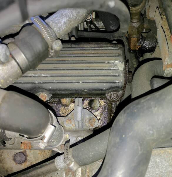

There were two areas I was immediately drawn to.  The first was the rear of the left hand cylinder bank, as I knew there was visible evidence of that can cover leaking.
Looks like that flare nut on the A/C line to the expansion valve needs some attention too as that is visibly oily which usually means refrigerant leak.
The other area that's obviously oily is the front end of the right hand bank.  While these areas are only, neither looked wet enough to explain the degree of splatter on the back of the car I'd seen.

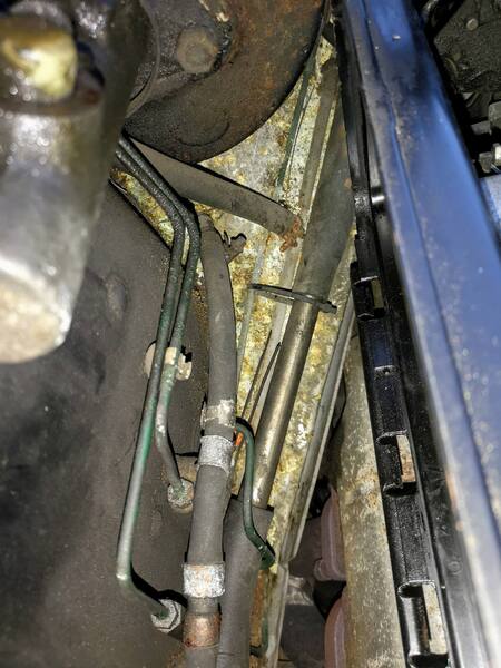

A common area to cause issues are the pipes to/from the front mounted oil cooler...which looks absolutely disgusting, but in half an hour of the engine running didn't produce a single actual drip...so I think a thorough session with the degreaser and pressure washer might be in order here to pin down where this is coming from.
So definitely attention needed there but I'm pretty sure it isn't the main issue.
Having a dig around did reveal a horrific mess below the brake servo though due to the small fluid leak spotted earlier.
That will want cleaning up sooner rather than later.

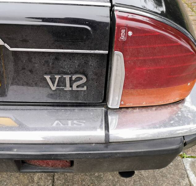

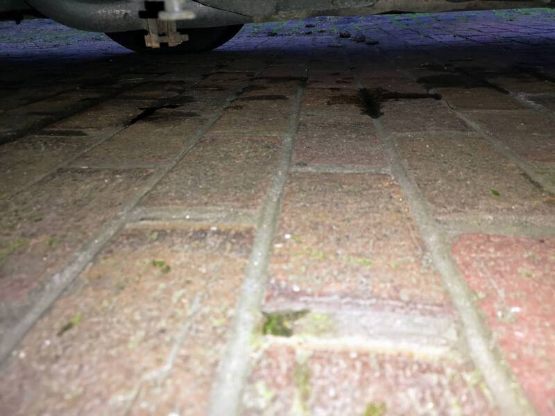

Eventually after the engine had been running for about 30 minutes I spotted a fresh drip on the driveway away over on the far side of the car.
Closer look revealed this definitely to.be engine oil.
This is right to the rear end of the left cylinder bank, and looking up from by that exhaust flange shows this assembly up there...
Which is the far end of the lines to the oil cooler.
My guess is we've got a failed seal in there which is allowing oil to be forced out at higher engine speeds.
Given this is a bit of a pig to get to without a ramp I may well chuck this at my local garage to sort as it shouldn't really be too bad a job on a four post lift.  I'll probably just get a set of seals for everything involved here so I've got everything necessary in hand.

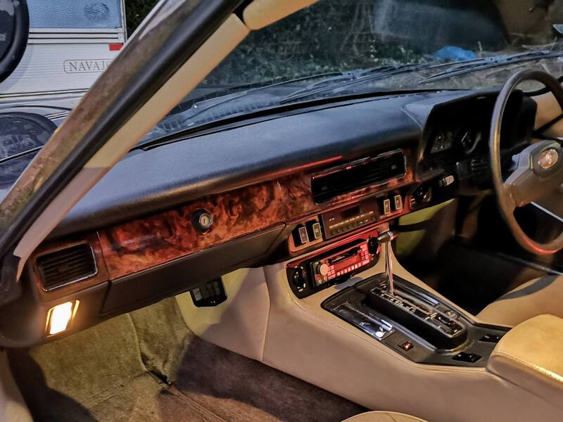

Only a quick update today.  I discovered yesterday that half the interior lights weren't working in the Jag.  This happening immediately after I changed one of the switches involved seemed far too much of a coincidence, so I took a closer look.  Sure enough, they're different.  The new switch only be four pins on the back rather than six on the old one.  So I switched over the cap from the old and new switches and put everything back together.  Problem solved.
I've also painted the area behind the switches alongside the trip computer black for now.  I will be looking for some veneer offcuts to rebuild the wood trim here in due course, but this looks better than the cracked, warped mess that was there for the time being.
The distributor breather air filter has also been swapped for something a little more standard looking.

Do you know why the old switches seem to be prone to cracking up?
Nothing definitive.  My guess though is that it's at least partly down to the lens only being held in around the edges, so if you press it by the middle of will flex a little.  Old age and/or the wrong type of cleaning solutions will probably make them more brittle.  Just know that between that I've seen them in similar states in several scrap cars and the price folks seem to be asking for them on eBay I have to guess it's pretty common.
They're odd switches...the connector attaches to the side rather than back of it and the illumination is totally external to the switch.  There's just a light sitting next to it which shines into the switch through a slot in the body.  Only other car I've seen with a similar setup was on a Lada Samara.

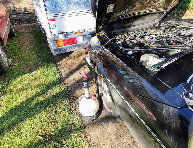

This afternoon involved a lot of standing around and waiting.
To put in perspective how much oil is in this engine...this much.
What came out wasn't that disgusting but it was definitely well due a change.  The fact that I had to resort to mechanical assistance to remove the oil filler cap tends to suggest it's not been off for a while!

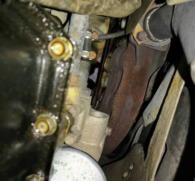

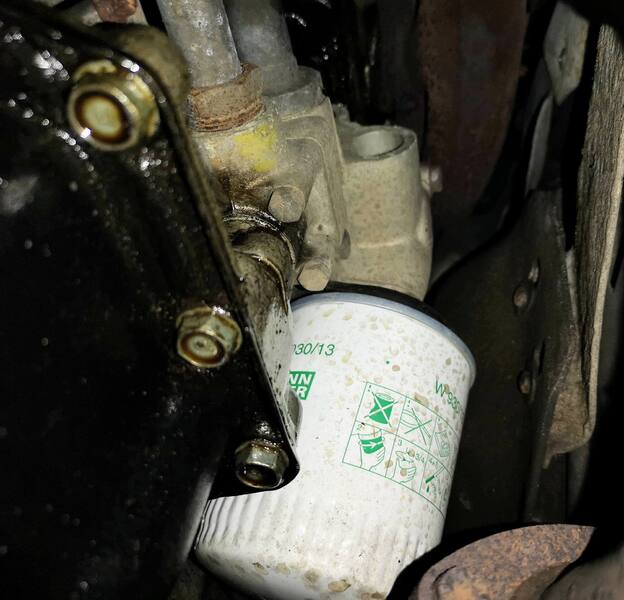

The oil filter is not the most inaccessible one I've ever encountered...but is close.  It would be dead easy if the left hand exhaust down pipe wasn't directly underneath it.
No access whatsoever from above!
 That circular thing you can just see through the gap is the top of the filter housing.

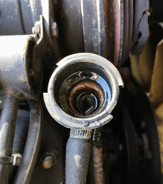

WhileI was waiting for the oil to drain I took the opportunity to check all the other levels, especially coolant.  Glad to report it's not moved at all since it was topped up.
Did spot something which will need to be remedied before I try to reinstate the air conditioning...jubilee clips aren't normally classed as suitable fasteners for HVAC systems!  This is on the high pressure side of the system too.  At least it's nice and easily accessible to replace.
