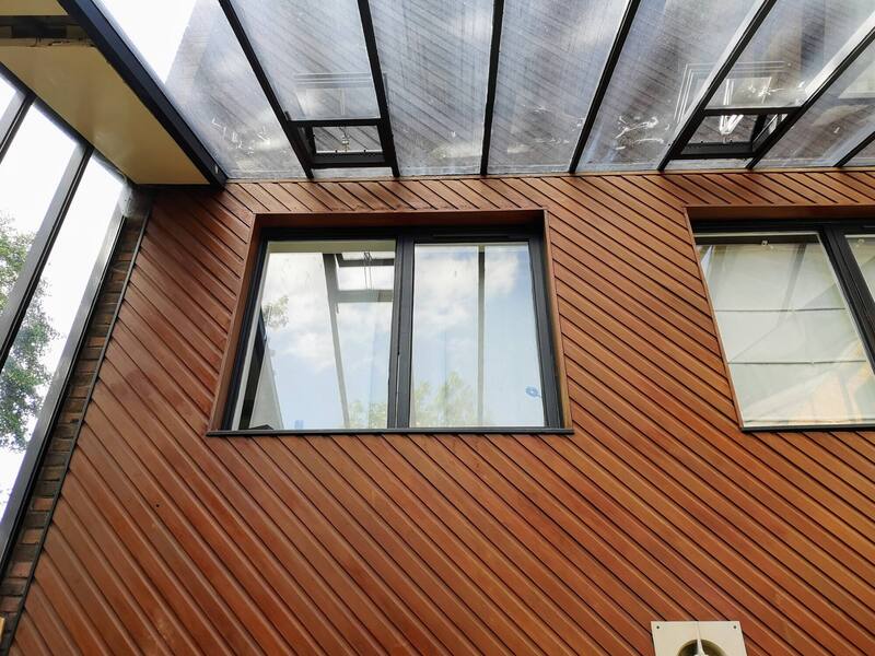

What kind of thundering poltroon stains teak? If the colour was the important thing why not use cedar or some other equally durable timber that's not wildly expensive and doesn't require denuding a tropical jungle?
It's a crying shame.  The timber looked like this all the way up originally.
The woodwork was stained black, fences were painted black, window frames were painted black, staircase was painted back, the panelling and railings around the landing have been painted black, all the interior doors were painted black...you get the idea.
I'm still surprised that the interior panelling in the conservatory didn't suffer the same fate!

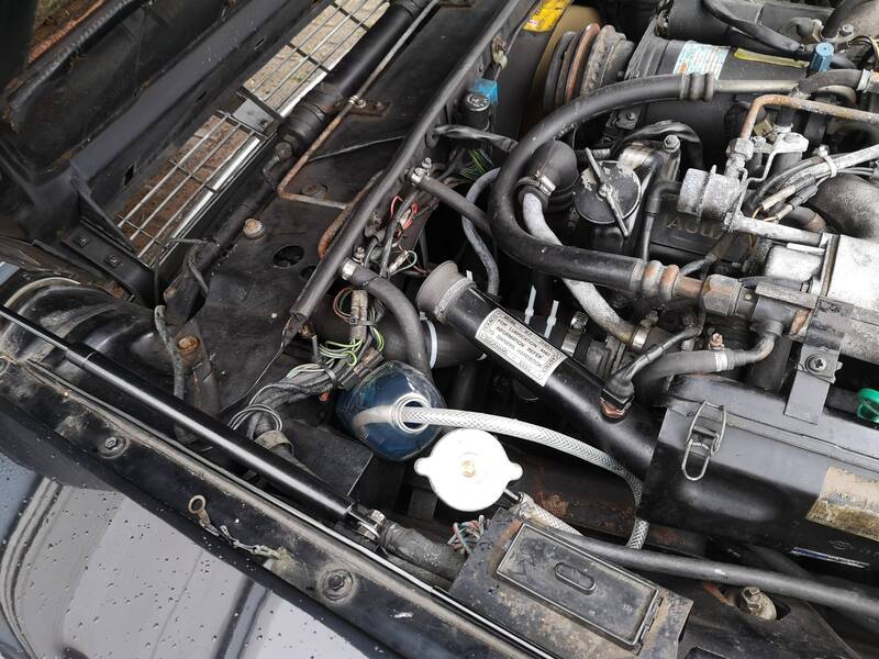

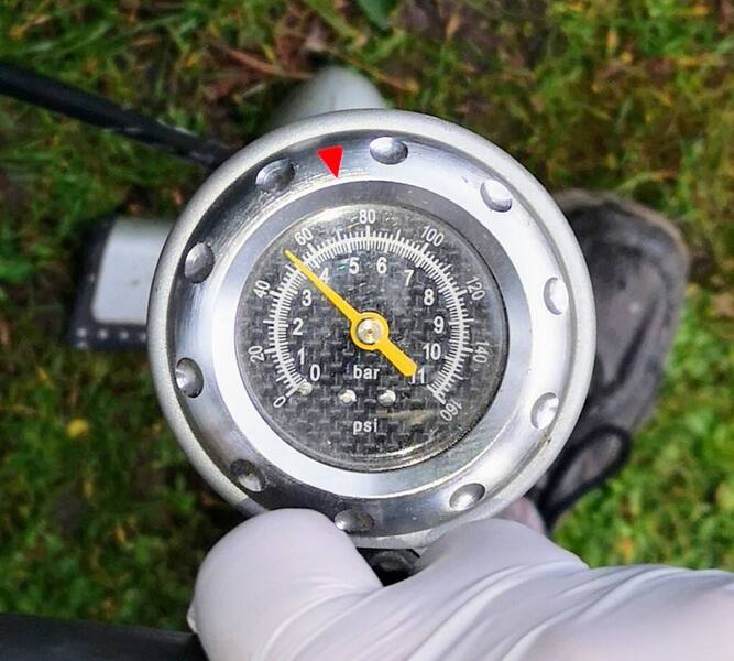

As noted a few posts back a few of the coolant lines on the Jag are showing signs of failure.  The left hand top radiator hose in particular was ballooning quite alarmingly.  While this is probably at least in part just due to old age, it felt like the system was maybe pressurising more than it should.  I'd also spotted a couple of drips from the outer seal on the expansion cap.
I had a sneaking feeling that these would prove to be connected.  This is because the expansion setup on the Jag is a bit strange (no surprise there...the whole coolant system is a bit strange), with the overflow tank buried inside the nearside front wing.  It's totally inaccessible without removing the wheel arch liner...and you could be forgiven for not even knowing it's there.  Through this tank is the only route for pressure in the system to vent.  Fine...except for the fact that the line between it and the cooling system is a thin rubber hose which is bent through a tight 90 degree bend right after it disappears from view from the engine bay.  As such this hose is very prone to kinking.  The bottle itself is also a cause of trouble as of course being totally hidden from view it never gets cleaned, even if the cooling system gets serviced regularly (let's ignore the fact that Jaguar *recommended* that two tins of Barr's stop leak be added after each coolant flush for now!).  So it tends to end up full of horrible organic slime.
Each enough to check though, just disconnect the hose from the header tank overflow line and see if you can blow through it.  It should be easy to do, accompanied by a gurgling noise from the dip tube in the hidden tank.  There shouldn't be any real resistance.
Oh.  We actually had this up to double that reading without any movement of air.
Well that won't have been helping anything then!
Play was stopped at this point by marble sized hail.  However I've cobbled together a temporary solution to allow me to drive the car for the next few days while minimising the risk of blowing coolant hoses.
Have also wrapped some cable ties around the hoses which are bulging to hopefully help keep them together until the replacements arrive (a full set has been ordered).
Any guesses on how many inches of solid mud I find in the bottom of the expansion tank when I get to it?

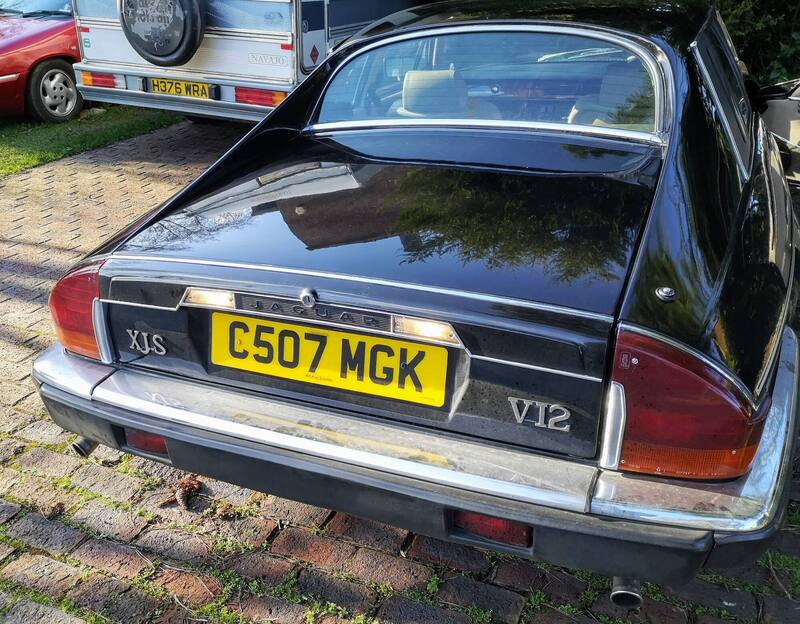

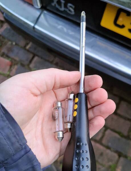

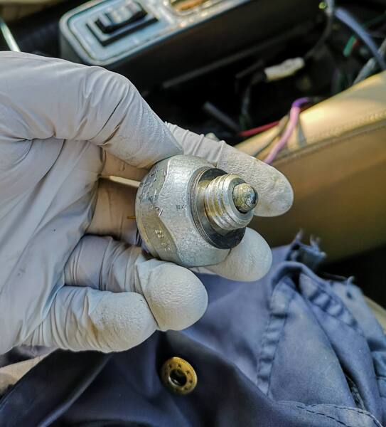

Noticed today that the reversing lights on the Jag are sticking on again...so until such time as I have the opportunity to investigate the switch, we've disabled them.
Will deal with that properly later when I've more time to look into it.

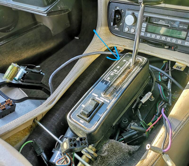

Today's task was to see if we could restore sanity to the reversing lights.  A quick search on Google revealed that the switch is on the gear selector assembly inside the car rather than outside... surprisingly sensible!
It lives on the left hand side of the selector towards the front.
It just screws into the side of the selector mechanism and there's no need to strip that down to remove it.
It was very obviously gummed up, requiring the plunger to be manually pulled back out rather than snapping back out under spring pressure.
Turns out all it needed was a good clean and a dose of fresh lubricant.  Ten minutes later everything was back together and the lights behaving as they should.
Tiny little task in the grand scheme of things but nice to have it ticked off anyway.
