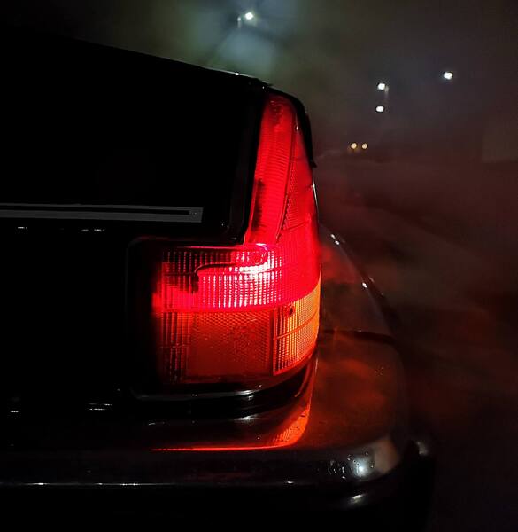

Re the rear lights - the US models did not have a separate orange section, instead it was all red, but it appears they used the same mould to make the UK lamps. You may find the tail light actually shines sideways enough to conform (unless there's actually a position for a 5W bulb back there) and normally the lamp has its own lens, unobscured by the retroreflector.

That section behind the retro reflector is baffled off.  There's a pretty deeply recessed space which looks exactly the right size to have had a little 5W capless lamp living in it.  The light from the tail light in the red section does show to the side somewhat, but more by coincidence than design it looks like.  I meant to get a photo with the lens removed but totally forgot.  Will get one tomorrow.

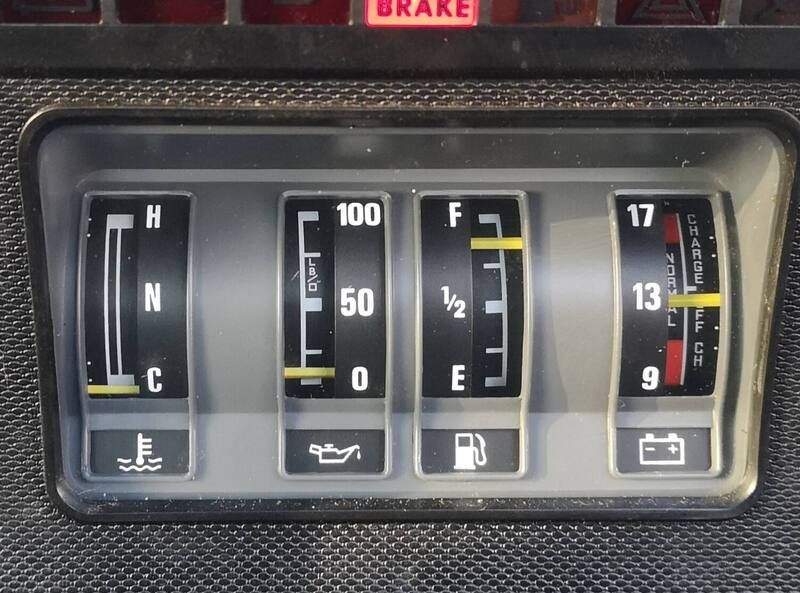

I wanted to at least try something with the oil pressure gauge today before starting pulling the cluster out to investigate that (there's definitely something amiss as all the gauges read slightly low - aside from the oil pressure one which does the opposite).  I can see that the gauge does react to changes in pressure, as it varies when running between being physically pegged against the top of the gauge and sitting on the 100psi marker.
So I wanted to see if I could null out the offset and still get a usable reading by adding an additional resistor in series with the sender.  As stated elsewhere, I have little interest in the actual numbers reported by it, I'm far more interested in learning what behaviour is normal for my car and then being able to spot any deviation from that behaviour.
One variable resistor to clip in series with the sender thrown together.
With this clipped in it was a simple matter to "dial in" zero on the gauge with the ignition on but the engine not running.
Sadly it appears that the response curve of this sender is incorrect (or there is something amiss with the gauge itself as we suspect) as this was the highest deflection of the needle I saw at any point with the engine running
I know these engines don't have great hot oil pressure, but I'd hope for more than that if stone cold.

Turns out the recess in the tail light reflector that I thought would be for a running light is actually a recess for one of the bolts that holds the cluster in!
Every day's a school day.  Does bother me that despite the lens wrapping all the way round to the side of the car that the indicators basically have zero visibility from the side.  I'm sure there's a reason it was designed that way, but it just seems odd.
The itty bitty sidelight has a small bit of lens off to the side that I'm sure satisfies side-on marker illumination- the indicator portion being made red satisfies the retro-reflector portion being red at the rear (red turn signal being common-ish here, more so in Canada).

That summary of the tail lights does seem to make sense.  The tail light is clearly visible from the side...shame the retro reflector came at the cost of any appreciable side spill for the indicators.

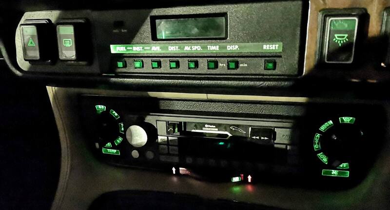

While I was looking at audio I had a closer peer at the head unit in the dark with a torch to try to confirm (as I've been unable to find a decent photo of this unit) that there is evidence of the buttons being illuminated.
Using a bright light source shone onto them reveals clear portions, so there definitely should be lighting in there.
The lamps were probably killed off by the illumination line being incorrectly wired up to the permanent 12V feed for goodness only knows how long.  I'll pull it apart at some point to restore functionality of the lighting.
Speaking of lighting curiousity got the better of me so I went digging to take a look at the light source for the fibre optics.
It's the silver and black cylinder just right of centre.  So pretty easy to get at (just three screws hold the panel above it on).  Pulling one of the lines and playing around even with the not particularly bright light from the torch on my keyring shows a great potential for improvement of the lighting.  The bottom of the temperature control here is being lit by my torch.  Top is the normal light source.
Camera has made it look way brighter than it is...but it's actually visible to the naked eye there...the lighting at the top of the dial wasn't visible above the ambient light to the naked eye.  Will be nice to give that a bit of a boost as I think the visual effect looks really nice... it's just laughably dim at the moment.

What type of bulb is it? 5W capless? Would one of the Chinesium "hyper-bright" green LED's to fit any Honda/Subaru/Nissan pocket-rocket suit purpose?
Posted (edited)
One of the little tiny bayonet things usually seen in the old Lucas dash warning lights etc, just a 6W version (or at least it should be...they're hard to find so often wind up replaced with lower wattage ones when they fail...and at 78K miles I assume this has been replaced a couple of times).  This is a 0.8W version, but the same type of lamp.
I reckon a 3W high power LED driven conservatively (will just utilise the existing green filter to keep the colour looking right) will do just fine.  Have a few in stock that should do.  The other popular configuration I've seen is an array of 5mm LEDs, one pointing at each bundle of fibres exiting the housing.  I suspect that would be overkill though... I'm going for readable levels of brightness, not making the entire cabin light up like a modern Audi...
Edited by Zelandeth
added photo
That has to have a lifespan measured in minutes. 6 Watts in a miniscule package like that- yeah, LED is a good solution.
Also, I have a few pieces of equipment with the very same illuminated buttons they used on the trip computer. Funny to see.

I was having a dig through my box of random lighting components to see if I could find an LED suitable for upgrading the fibre optic source with (unsuccessfully, have ordered some 3W warm white ones) when I found something which should improve things in the short term.
The page I originally read up on the system from apparently quoted the wrong lamp type.  It's not actually one of those teeny tiny ones, instead it's a BA9s 6W lamp.
Still pretty weedy though for lighting half a dozen bits of the dash with though.
What I found was an identically rated modern version in halogen form.  While the power usage is identical, the halogen one produces more than twice as much light.
With it fitted the difference was *immediately* obvious.  The fact that you could see the legends on the headlight switch light up with the lights even in (dull) daylight was new.
It had to be pretty much completely dark before you could see any sign of life from that before.
In full darkness while the heater controls still are utterly impossible to read (the text being about 8pt in size sees to that), are at least pretty easy to see now.
Really need to sort the lighting in the stereo next so I can get a proper full dash at night photo up.
