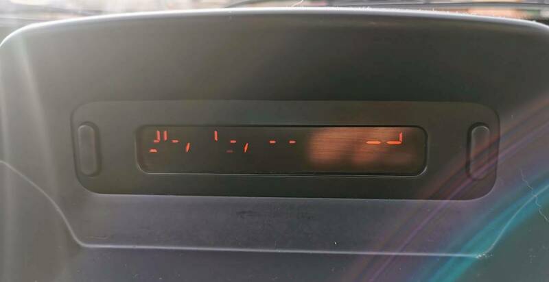

Well it looks like I've added an item to the to do list on the Peugeot.
That was working four or five days ago.  I'll need to investigate whether it's usually an issue with the display itself or a dodgy connector somewhere - but I'm guessing damp has got to one of the zebra strips between the display panel itself and the PCB it's mounted on.  That will definitely need to be sorted as it will drive my OCD mad.
Think it may be due to a lack of volts... my Berlingo display does the same when the battery is low. Try charging the battery and see if it makes a difference.
IIRC it's a 'feature' of those Peugeot Citroen displays.

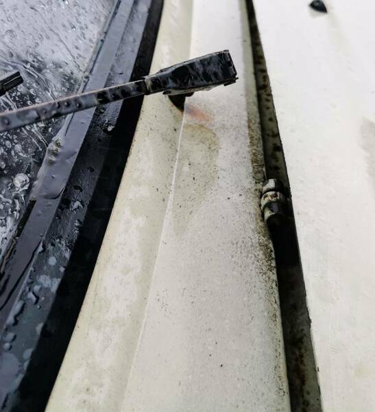

Sorry for the lack of my usual updates lately.  Firstly there's not been a massive amount going on.  The weather being so bloody miserable (seriously, why don't we just rename winter "the rainy season" as it would be so much more descriptive)has obviously put a damper on doing much outside.  Plus it's been an...odd...I guess you could call the last week, and it's messed with my ability to portion time and resources properly.  That's all massively off topic for this forum though.
The bloody miserable weather however has allowed me to further survey the water ingress issues with the Trabant.
The door seals have definitely made a huge difference.  There used to always be water visibly running in around them and pooling in the front corner.
There's still a bit dripping off the actual door card on the passenger door, but I think the seal itself is doing its job.  The window rubbers are absolutely shot on that door so I suspect there's an excessive amount of water getting into the door as the wiper seal basically isn't doing anything useful.
The vast majority of the water though seems to be coming from here.
I'm going to need to stand on my head to see if I can get a better handle on the actual source.  Windscreen seal is probably still my favourite but I'm not 100% certain.
Pulling the fuel tank to make sure there's not large chunks of the bulkhead missing properly wouldn't be the worst idea though.
Looking at the weather forecast it might be a while before I actually get the car dry again though.

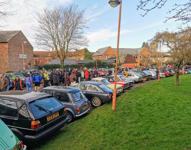

At the NYD show over at Stoney Stratford I managed to again forget to take any proper photos of my own car.  I have a history of doing that!
Biggest issue really is that the show has just become so popular.  It was absolutely rammed, to the point that even walking around was a challenge, never mind trying to get any half decent photos or actually talk to any owners for more than 3.8 seconds.  Those photos were both taken early in the day when it was still relatively quiet.
I really need to pull the carpets back out of the Trabant to get them dried out again - though at least the sponge-like underlays are still folded up under the sofa in our spare room.  There has been a little bit of an accumulation of water in the car again over the last few days.  Can't say I'm all that surprised based on how wet I got walking the dogs yesterday!
About the best thing you can do when you've got an issue like this and you can't immediately sort the leak or put the car under covered storage is to ensure that any water that does get in can get out again rather than staying trapped in the car.  Which is a bit tricky on the Trabant as there are no rubber bungs or anything you can easily just pop out in the floor pan.  Solution?  Drill a hole at what's the lowest point when parked facing up hill.
Will only take a matter of seconds to blob a bit of weld over the hole in future, but will at least stop water actively pooling until I can get a handle on where it's getting into the car in such great quantities.  I'll get the carpets back out hopefully tomorrow.
Ideally I'd like to stick the dehumidifier in there again, but there's little point until the weather warms up a bit as it won't do anything useful if the cabin is much below 10C.  I did have a look around today but none of the units stocked by Toolstation or Screwfix seem to be dessicant based, they're all heat pump units.  Need to have a shop around online.

Personally I would make a reverse teardrop there at that drain hole. Drains when parked and actively draws through when driving, sucks the water from the underlay.
That's the kind of solution you'd expect anyway.
I would take all the carpets out, and dry them out, but leave them in the house until all the leaks in the car are sorted.
A quick way to sop up residual water in a car carpet is to use a disposable nappy. Supermarkets and online retailers sell them quite cheaply in multipacks. Cut (carefully!) around the absorbant pad part of the nappy, so it can be flattened out. Lay it pad side down on the wet carpet, so that it is in close contact for as wide an area as possible. Stand a weight on it (a clean 5l plastic can of oil is ideal) to press the pad down against the damp area. The granules in the nappy will absorb and retain the moisture. Once absorbed, the nappy can be put in the household rubbish or be dried out and re-used. The pad of a nappy can be useful to apply in the vicinity of a leak as well, to capture and store the incoming drips to prevent them migrating further.
Puppy training pads are also good for drip capture. They can be cut to shape and size and be stuck in place with duct tape, to intercept drips and runnels.
The above are temporary mitigations, but useful in the of control of incoming water until a formal remedy can be applied.
