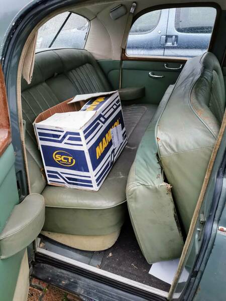

So we've got a delivery and collection mission coming up tomorrow, so the P4 has been loaded up with the various spares and such for the new owner.
Hoping to make it back somewhere around 1500-1600 with a bit of luck, hopefully the traffic goes will play nice tomorrow.

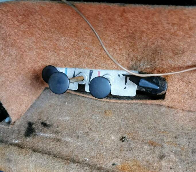

Something it also shares with the Lada is a heater which could double as a blast furnace.
It is *fiercely* effective.  First air cooled car I've driven which actually has a halfway decent heater, even if it did take me a few minutes to figure out the controls.
Which is a good thing as otherwise keeping the windscreen demisted might have been a bit of a chore given I've apparently got the optional indoor swimming pool specified.

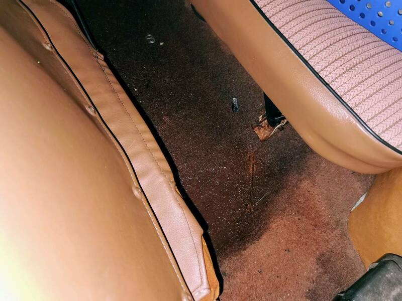

Not particularly surprised.  The windscreen definitely leaks and there's signs of water ingress from around the rear windscreen too - I'll look into that in due course.
