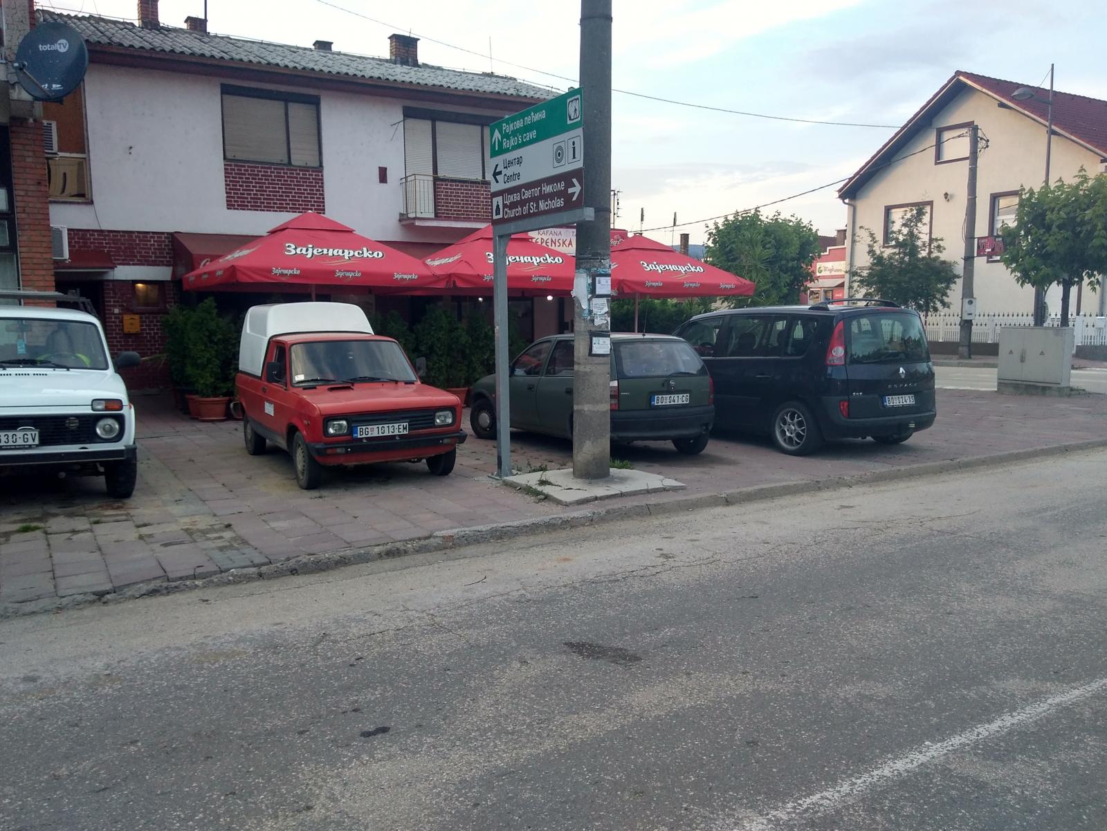

post-4555-0-82875600-1527570622_thumb.jpg Zastava pickup.

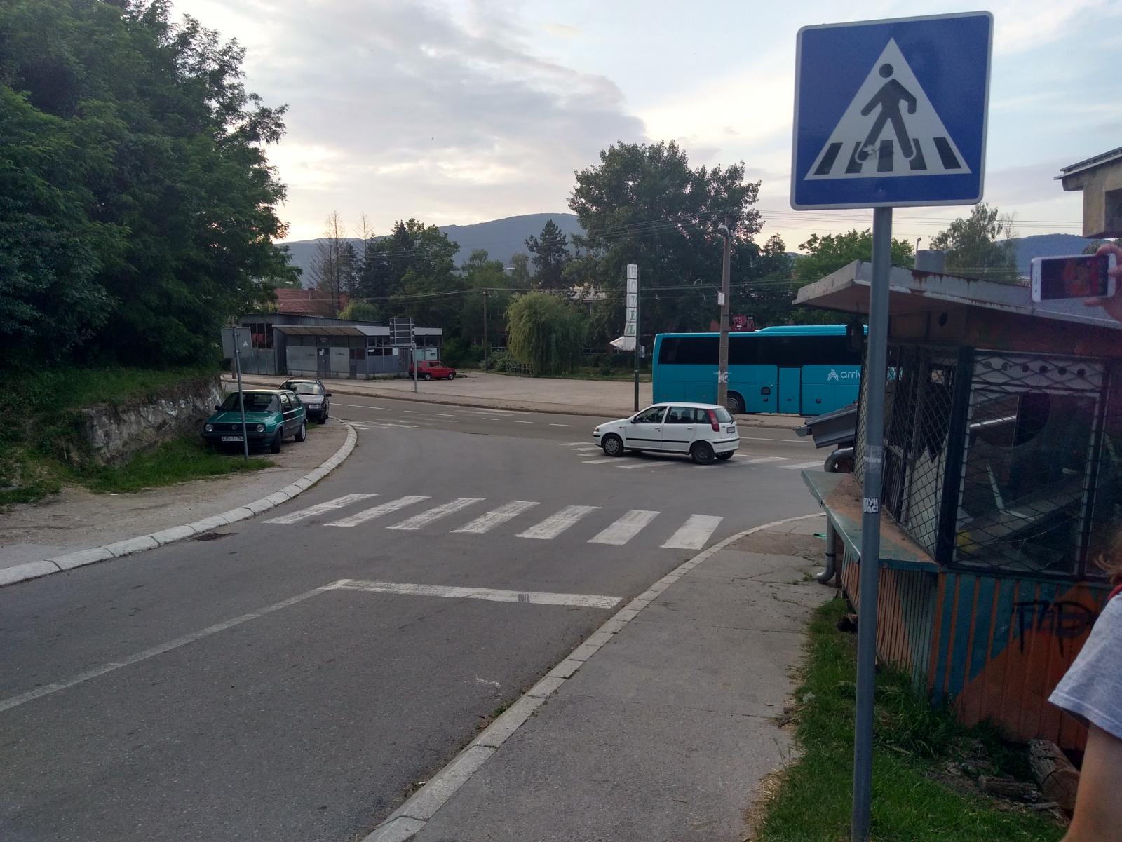

post-4555-0-88740900-1527570735_thumb.jpg Interesting parking spot in middle of junction, the local police did wander by later in an ageing Punto with rusty sills and blowing exhaust.
