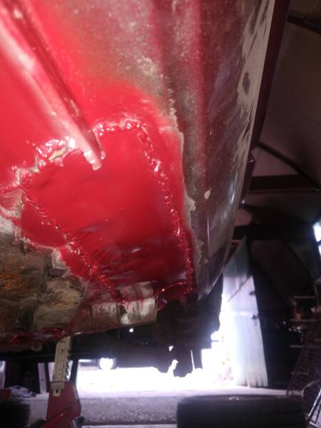

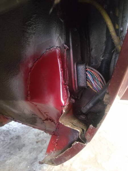

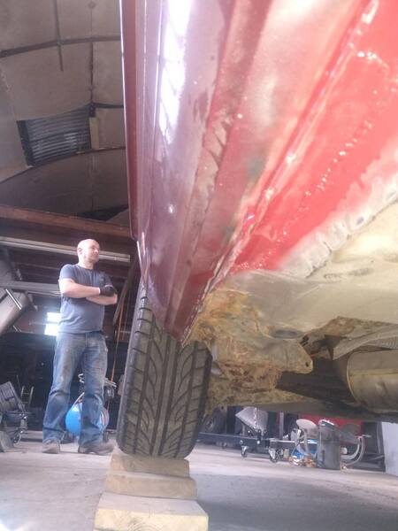

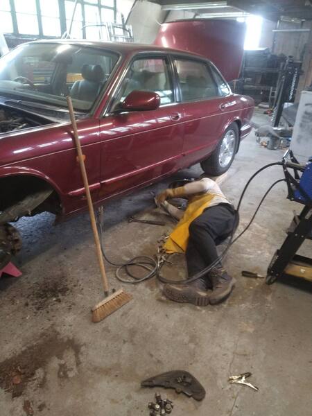

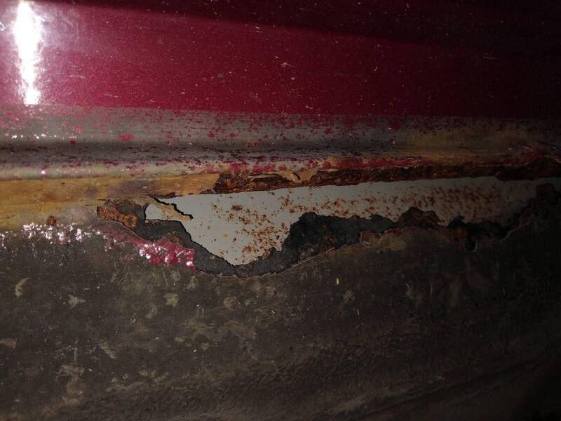

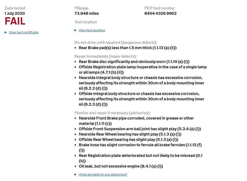

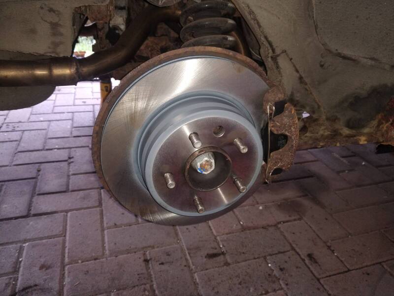

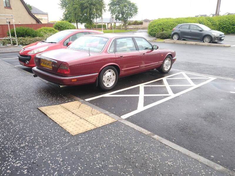

dome Posted July 15, 2020 Author Posted July 15, 2020 Ok, let’s go back 2 weeks today and see where my fleet is. Audi: fucking fucked mate Jag: awaiting MOT results-Crispy. Kangoo. Timing belt on but not tensioned, new alternator setup and EPAS to be installed. Number of roadworthy cars: Zero. So, where do we go from here? Jag first The MOT results were somewhat predictable. From speaking to the tester the inner wings were crunchy as was parts of the floorplan. I put on my big boy pants and gave it a poke. Yep, that's not pretty. Enter, stage left, a knight in shining armour in the shape of the warm and fluffy @Tickman He sent a message last Sunday. "looking for someone to weld the Jag?" "Why, do you know someone daft enough?" "Yes, bring it up" Clearly lockdown had got to him... So, a couple of hours later here was the scene at a top secret location, just off the A90 in Forfar. A day was spent poking, grinding, swearing, shaping metal and welding. The last two were done by Tickman as my skills don't run to that sadly. Yet. Tickman was so delighted* with the Jag he demanded he keep it for a couple of days to enjoy it. Or maybe there was more rust than first thought... I as dispatched home with the racecar Baleno GSR so he could have some alone time with it. Cough. A few days later I headed north to bring the Jag back home with a fresh, non crusty underside. Album cover... I can't thank John enough for his work. I wouldn't have known where to start with tackling this! Stuck the battery back on and... It wouldn't start! Dash was dead. After some frantic prodding of the 346 fuse boxes this thing has it was discovered that Tickman had set off the inertia switch whilst braying fuck out of it delicately shaping the metal. A quick click and she was alive So, back home and discs and pads had arrived. I pulled the back wheels off to trace the horrible noises coming from the back brakes. The pads weren't actually worn down as per the MOT test, the discs were knackered though from sitting and when i pulled the drums off out came the handbrake pins which had been rattling around inside the drums and catching Straight one Yeah, that's not right... The backing plates had corroded where the pins go through so I had to engineer* a solution involving nuts, washers and bolts to retain the drums. This was fun. Back together and new discs on. I did this on last Thursday night. I also slathered some underseal on. With the retest booked for Friday all I had t do was fit a new number plate bulb and things were golden. Up on Friday morning and I purchased a pair of bulbs from my local garage and set about RHS-the failed side-nae bother LHS, the side which had passed (and previously been working): Dead Voltage at bulb holder-Zero. Hmm. Voltage at connectors on the rear: Zero FFS! I pulled off the cover on the hinge which conceals the wires running to the boot-these are well known for failing. Sure enough three broken wires were found. I connected them back up with some crimps for a temporary* solution and aswell as working number plate lights I also had a working boot release. Winner! I dropped it off to the MOT station... Coprolalia, CreepingJesus, Broadsword and 12 others 15
dome Posted July 15, 2020 Author Posted July 15, 2020 And... here we go Whew! The Jag drives very well, as you'd imagine with such a low mileage. It's far from perfect but with a bit of a fettle it'll be a very pleasant way to waft around for someone. A proper clean is in order, along with a cleanout of the throttle body as it wants to idle at 2k rpm all the time. Current thinking is to have this around while I resurrect the XJ40 as it may be handy to have as a reference/temporary donor of parts whilst troubleshooting. Although the engines are different-the X300 has coil on plug and the XJ40 distributor. I may also take the full stainless exhaust off this for the XJ40. We'll see. Number of roadworthy cars - 1 timolloyd, Supernaut, cort16 and 23 others 26

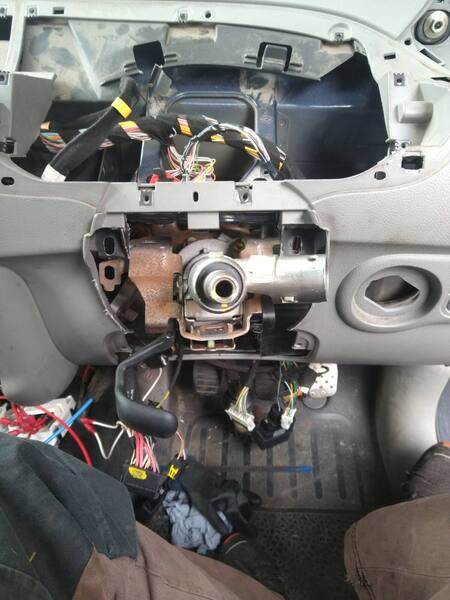

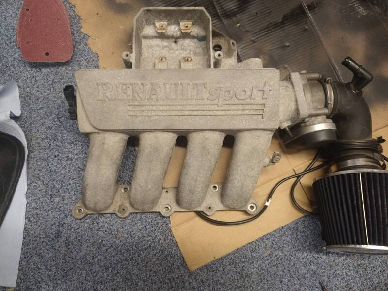

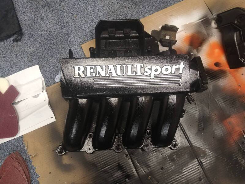

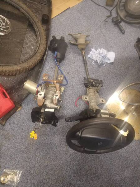

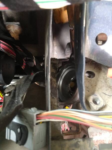

dome Posted July 15, 2020 Author Posted July 15, 2020 Kangoo up next. While Tickman had the jag I cracked on and tensioned up the timing belt. It’s not that bad a job the second time around, although the Kangoo definitely has more access. Also the full auxiliary setup was removed while I was doing this.the alternator gets right in the way normally. i also fitted the cup alternator setup-this does away with the automatic tensioner and replaces it with an old fashioned manual setup. Make some noise! It definitely seems to rev easier without having to drive all that extra gubbins off the belt. The characteristic whine on startup these things often have has also gone. Last Saturday I started the tricky bit-making the EPAS column fit. The old column was removed and compared with the new one. Yup, there's a big lumpy bit sticking out on the LHS of the EPAS column (on the left) Following tips from Facebook group I unbolted the motor and installed the column to see where it would foul You can see the hole the motor sits in in the centre of the pic with a soon to be departed bit of plastic trim in the way. The duct feeding the RHS air vent had to be cut too. I can live without it l Trial fit @Fraz was at a loose end whilst waiting for his new sprog to appear so popped over and helped me wire everything in ECU and controller in place. The aftermarket controller isn't visible but it's where all the wires running vertically on the RHS of the pic end up. The power wires were only added last week as i had to find the connectors for these. That was as far as I could get last weekend until I got the power cables so i thought I'd do a bit of titivation. Old inlet I had liberated an inlet from a Clio 182 in the scrapyard which with a bit of work looked like this. HOWEVER: It turns out my engine, or at least my inlet, is from a 172 and not a 182. Whilst it fitted on and bolted up it ran horribly with the new inlet. There is just enough difference to mean it won't work. If any Clio 182 owners want a shiny inlet drop me a message! I'll do the same to my 172 inlet at some point-it was just a case of painting the whole thing black and then sanding down/polishing the Renaultsport script. Last week I finally got the right connectors on it but the EPAS wasn't working A bit of troubleshooting found a dodgy crimped connection to the rheostat to adjust the assistance. This was rectified by me on Monday and it now works! It still needs put back together and driven properly but we're almost at 2 working vehicles! Yaay! Liggle, Coprolalia, Tickman and 12 others 15
big_al_granvia Posted July 15, 2020 Posted July 15, 2020 great stuff on the harry, john is a class welder, some quality workmanship... happy wafting in it

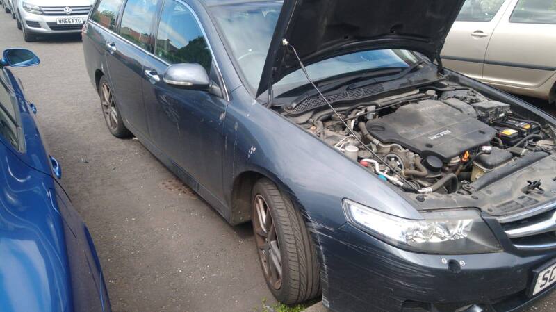

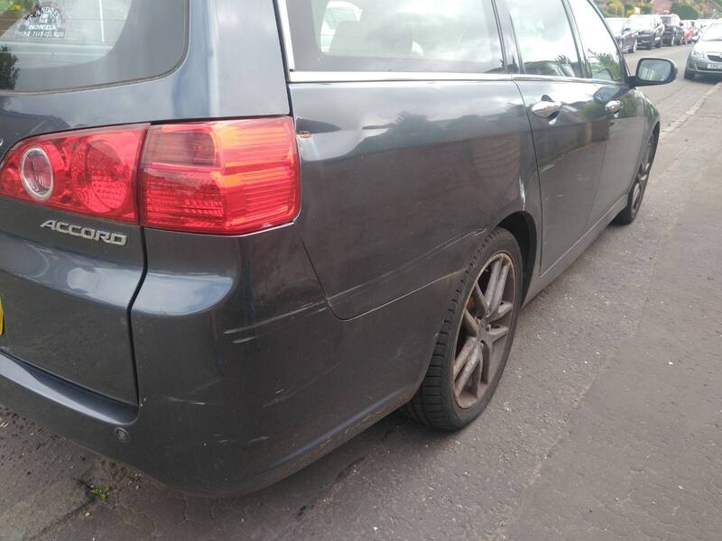

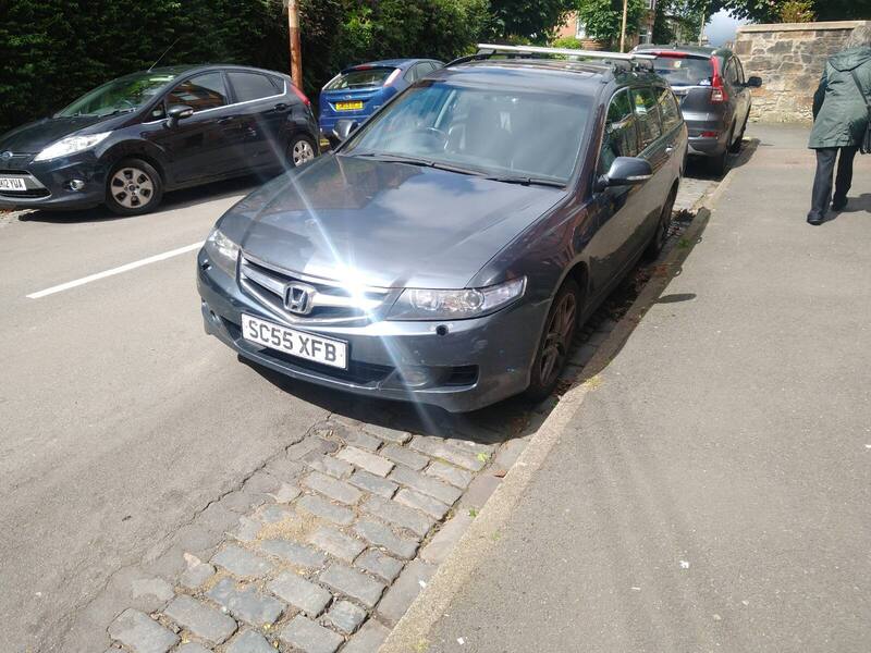

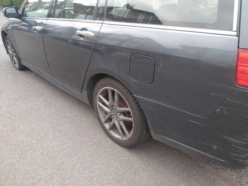

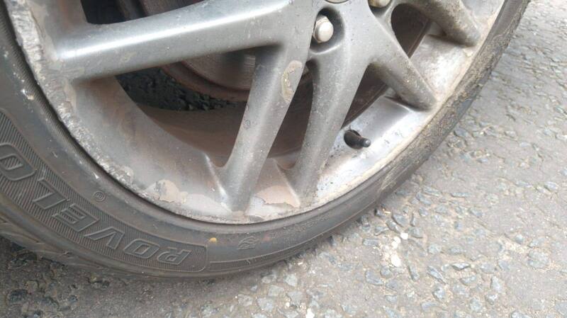

dome Posted July 16, 2020 Author Posted July 16, 2020 So, with the Audi dead i felt I needed (wanted?) a car I wasn't invested in. Just an car. For doing car things. My default choice in this situation would be Japanese. Working on them over the last few years has usually been a pleasure compared to Euro stuff. I wanted something i could chuck bikes/the dog in without worrying about it. The shortlist was Avensis Accord Spaceship Civic Cruise control was desired and toys would be nice. I like toys. Perusing the usual sites and everything in my budget was predictably shonky. I was in the process of asking @Fraz to look at an Accord saloon near him when i worked out that although the seats folded my MTB would struggle to fit. An estate would make more sense. Enter, stage left, another friend of ours in Glasgow who'd heard about the accord saloon. One who has worked for a Honda garage for a long time. He knew of a one owner from new Accord estate going cheap. was I interested? Why yes, yes i was. A 55 plate 2.2 diesel Executive Estate, it was bought by the current owner direct from the garage he'd worked at. Full service history, 44k miles. Yes, 44 ! He'd retired and stopped driving it, not that he'd drove it much anyway. It had languished on the street in Glasgow for some time now. I wafted across in the Jag on Saturday to Glasgow to have a look at this thing. If it was a goer I'd leave the Jag with Fraz and collect it at some point. Now, picture in your head an ex demo, top of the range car with one owner from new and low miles. Got that picture? Yeah, it's not like that... Every panel had a scuff or a scrape. And check out the wheels-amazingly fucked. A deal was done and I left in my new steed. Thankfully it drives very well-air con is ice cold and everything works apart from the radio which doesn't pick up reception. Cruise control, peeled cow, sat nav, decent stereo. It even has an ELECTRIC TAILGATE! A quick pit stop at Frazs hose and I checked the tire pressures. These ranged from 12 to, err 70psi ? there's a new battery and the old one was on the back seat. I'll weigh it in so that's cashback! Levels were all good so I started the journey back to Fife. Note the missing headlamp washers. Fill the screenwash and it all leaks out of these which is handy* 320touring, somewhatfoolish, BL Bloke and 16 others 19
big_al_granvia Posted July 16, 2020 Posted July 16, 2020 owner didnt stop when he heard the scrap then, its only cosmetics, stop any rust and use it as a snotter for doing the shitty work. if she is good mechanically then your laughing dome 1
Split_Pin Posted July 16, 2020 Posted July 16, 2020 Grand purchase, it is indeed nice to have a car that you aren't invested in too much. dome 1
Broadsword Posted July 16, 2020 Posted July 16, 2020 I'm really impressed by the way you tackled the Jag MOT fail. Those bits of rust are pretty typical of cars that are described as "yeah looks pretty solid M8, just a little hole in the floor", so the MOT could have been worse. Hero points to @Tickman for fixing the rust. Hope you enjoy wafitng around in it. These are so nice to drive. Split_Pin, LightBulbFun and dome 2 1
SiC Posted July 16, 2020 Posted July 16, 2020 Such good engines in those Hondas. As reliable as the VAG PD130 with plenty of go. Just don't let the oil level go to low as fucks the chain. Bit dead until around 2k rpm, remaps fix that. Suspected Honda did it to match their petrol engine style. Given the age and low mileage, this may suffer from the two issues these did - cracked exhaust manifold (this year was around the new part revision) and clutch. Both have had modified revisions by Honda that sort these out but given 44k may not have had them. Saying that, I (and 2 previous owners) got 97k out of my original OEM clutch on my Civic. dome 1
blackboilersuit Posted July 16, 2020 Posted July 16, 2020 GR9 purchase. Looks like if you could find a colour matched front bumper you could fix the screenwash issue and a lot of the cosmetics all in one go. Or you could just nip off the headlight washer hoses with a cable tie for a zero cost solution ? big_al_granvia and dome 2
dome Posted July 16, 2020 Author Posted July 16, 2020 21 minutes ago, Broadsword said: I'm really impressed by the way you tackled the Jag MOT fail. Those bits of rust are pretty typical of cars that are described as "yeah looks pretty solid M8, just a little hole in the floor", so the MOT could have been worse. Hero points to @Tickman for fixing the rust. Hope you enjoy wafitng around in it. These are so nice to drive. Yep, it's all Tickman! I've done a couple of hundred miles in the jag and i is indeed a lovely way to travel. There's a slight vibration at speed which might be the tyres, I'll investigate the grease nipples on the rear UJs too. Have grease gun, will grease. Broadsword and Jim Bell 2
Fraz Posted July 16, 2020 Posted July 16, 2020 Little did @dome know that as we were outside ogling a rough Honda diesel estate. Mrs Fraz was in the house in labour with baby Fraz ? it’s all about the shite cars for me! I should add that I am a responsible adult and whilst she was in labour it was the early “ I want to kill you” stages and not the “baby’s head popping out” stage. aldo135, sporty-shite, somewhatfoolish and 9 others 5 7
