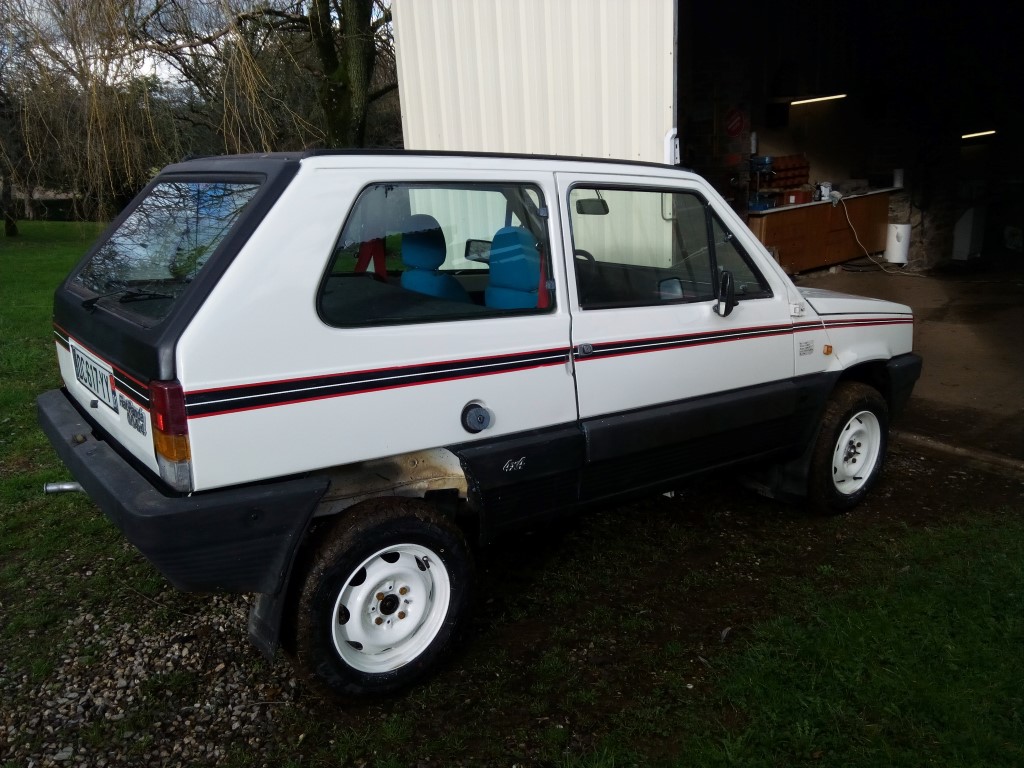

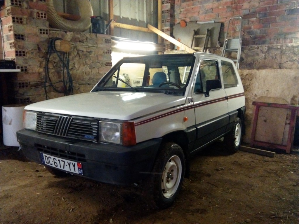

Daves Panda. minor fettling

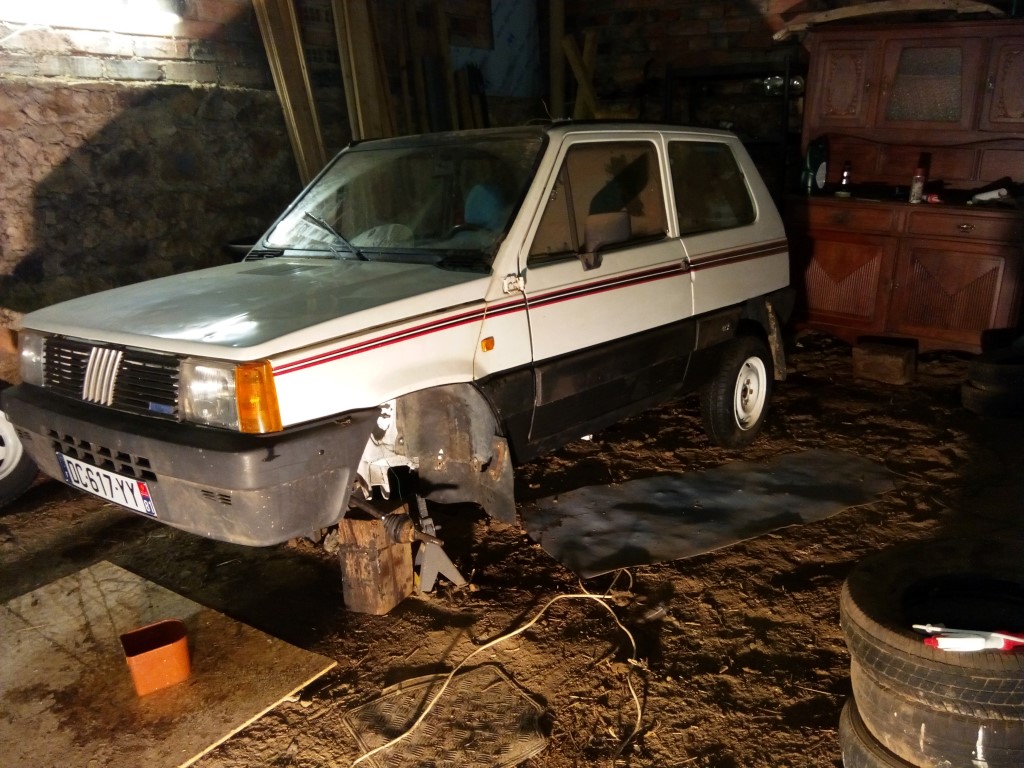

Still waiting for these bloody balljoints - they are all thats stopping me getting it driving. They were supposed to come today but obviously never showed up.
Once I have them I can fit the struts,driveshafts, bleed the brakes and its a runner.

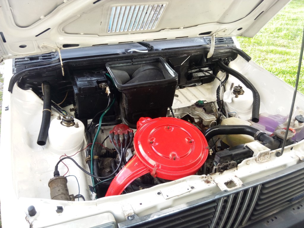

While waiting I started checking out the electrics and the flashers are weird. The left rear indicator refused to work and the hazards would flash for a while then stop. The left rear bulb, connectors and wiring were ok and I eventually traced the fault to a bundle of wires going through a multiplug under the dash. One of the pins had been pushed out the back of the plug and fixing this fixed the indicator. The hazards still wont play though....they will now only give a half-assed click from the flasher unit every now and then with no lights working anywhere. Switching on the hazards stops the indicators working.
Im not sure if this is another loose connection or the flasher unit itself. Under the dash there are two units...one metal cylinder with three prongs which seems to be the flasher and a plastic relay with 5 pins which does feck-knows what.
Anyone got a wiring diagram for an '86 Panda?

Get rid of the metal cylinder and get a modern 3 pin flasher relay. X1/9's used to have this issue all the time..

Sorry for the OT Dave. If it's got 3 pins I think that means it's already electronic. I bow to BC's experience though, it probably can't handle the current so an upgrade might help. I don't know what the other box is though, usually the switch cuts off the indicators (which is why they don't work)and shorts both feeds via the relay.

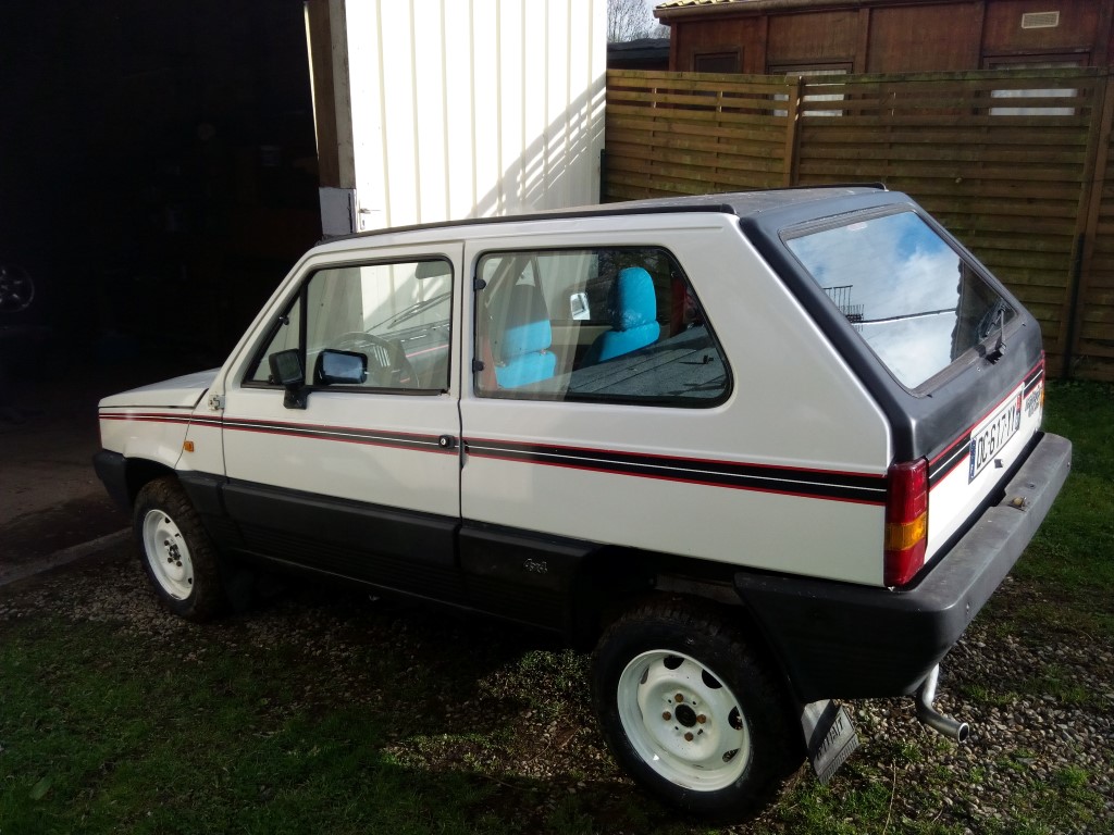

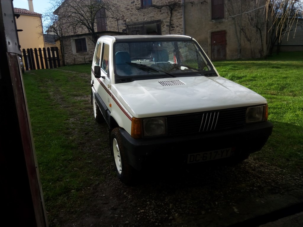

Aaaaand now I feel inadequate! Thats minty. I guess a full bare respray?
Interestingly his roof looks like its done with stonechip. I have only seen pics of one other which was an ad on LeBonCoin, but couldnt tell if the roof was painted or vinyl. Since my car was hail damaged, I wonder if the vinyl was added to cover the roof damage or if it was factory fit?

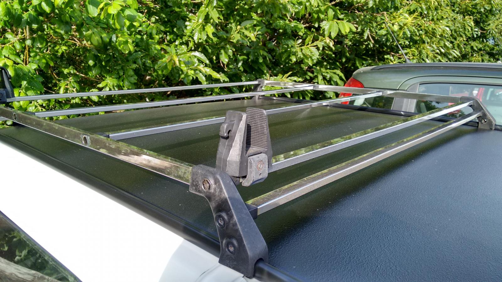

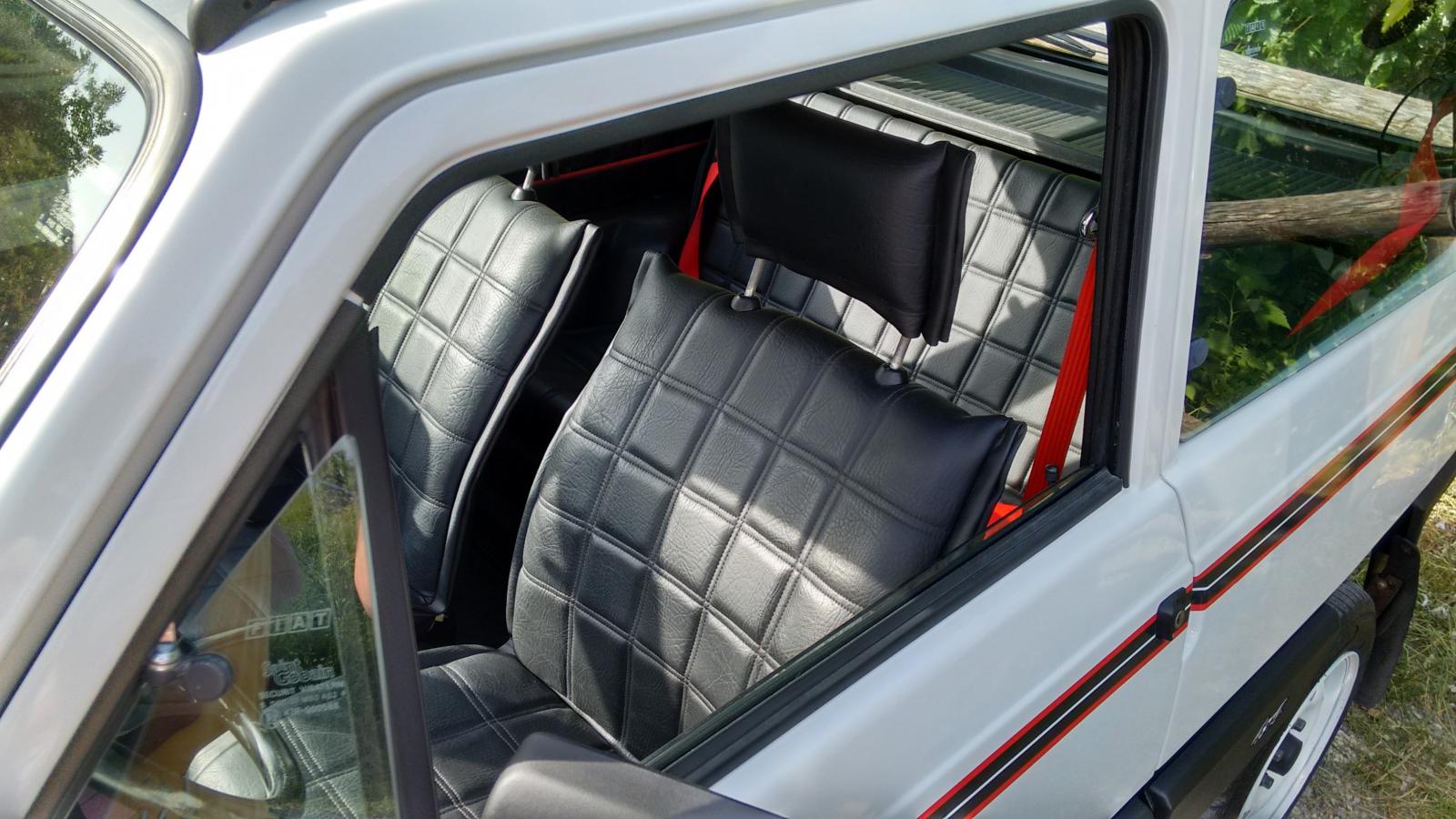

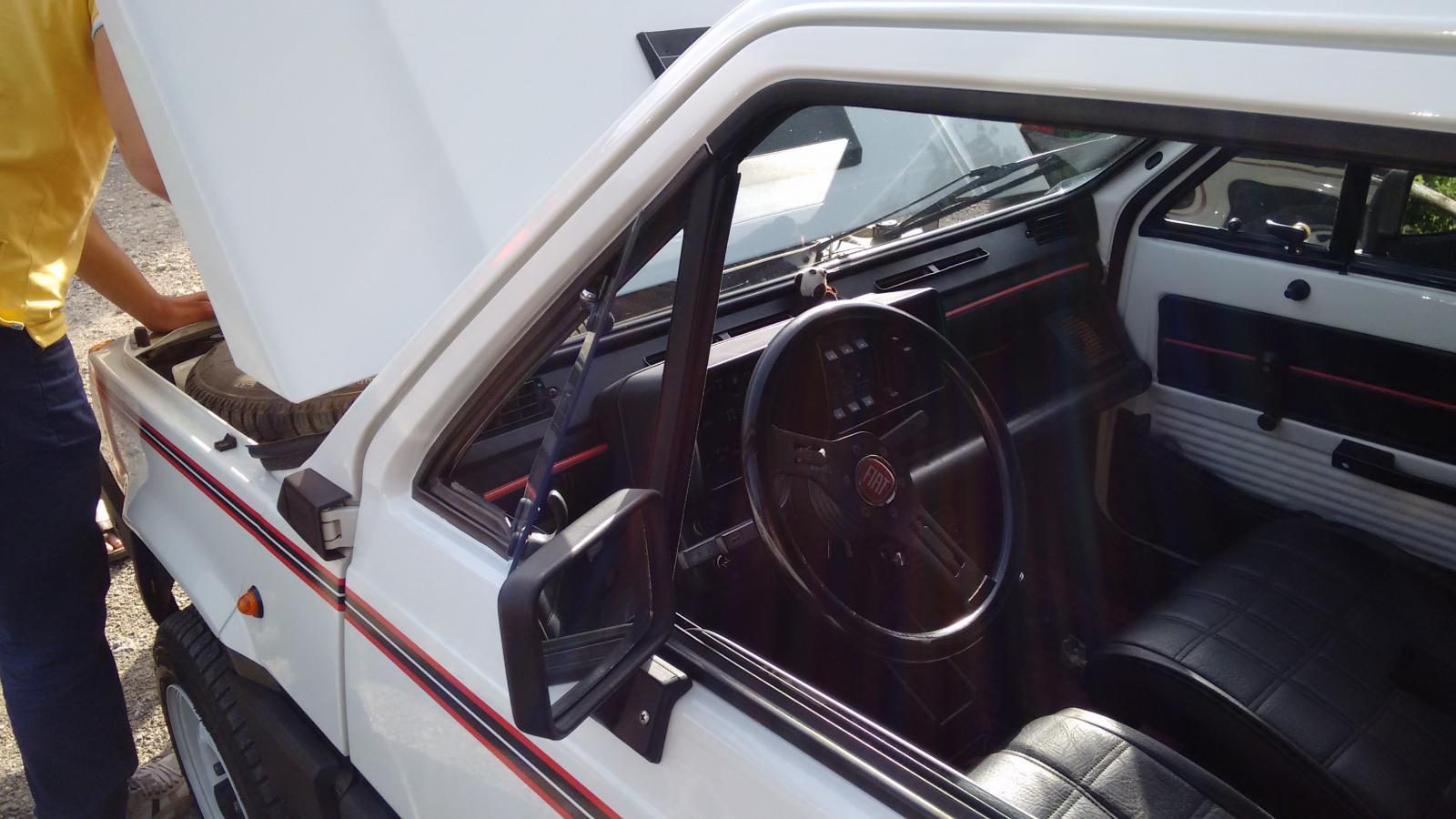

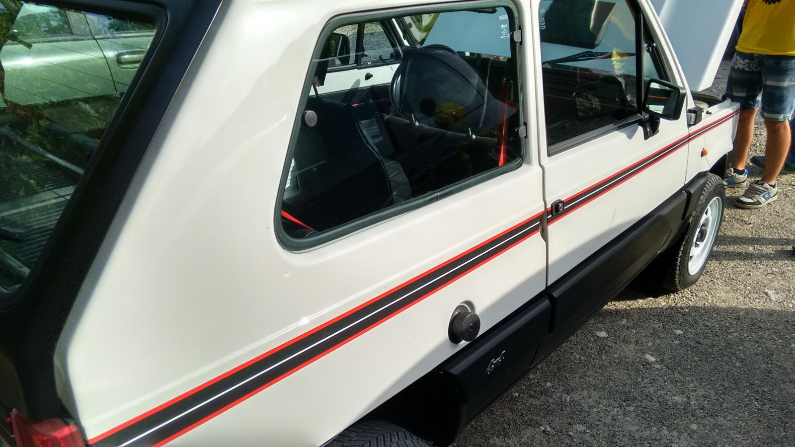

But those pictures that 'FFS' has posted are very interesting. That's a 'ski clip' by the way, attached to the roof rack (I've got four of them in a box, collected by the previous owner of my Sisley)...Also that is a 'Sisley' roof rack which appeared on the MK 2 special edition in 1987... What I mean is I've never seen that on a MK1 before...

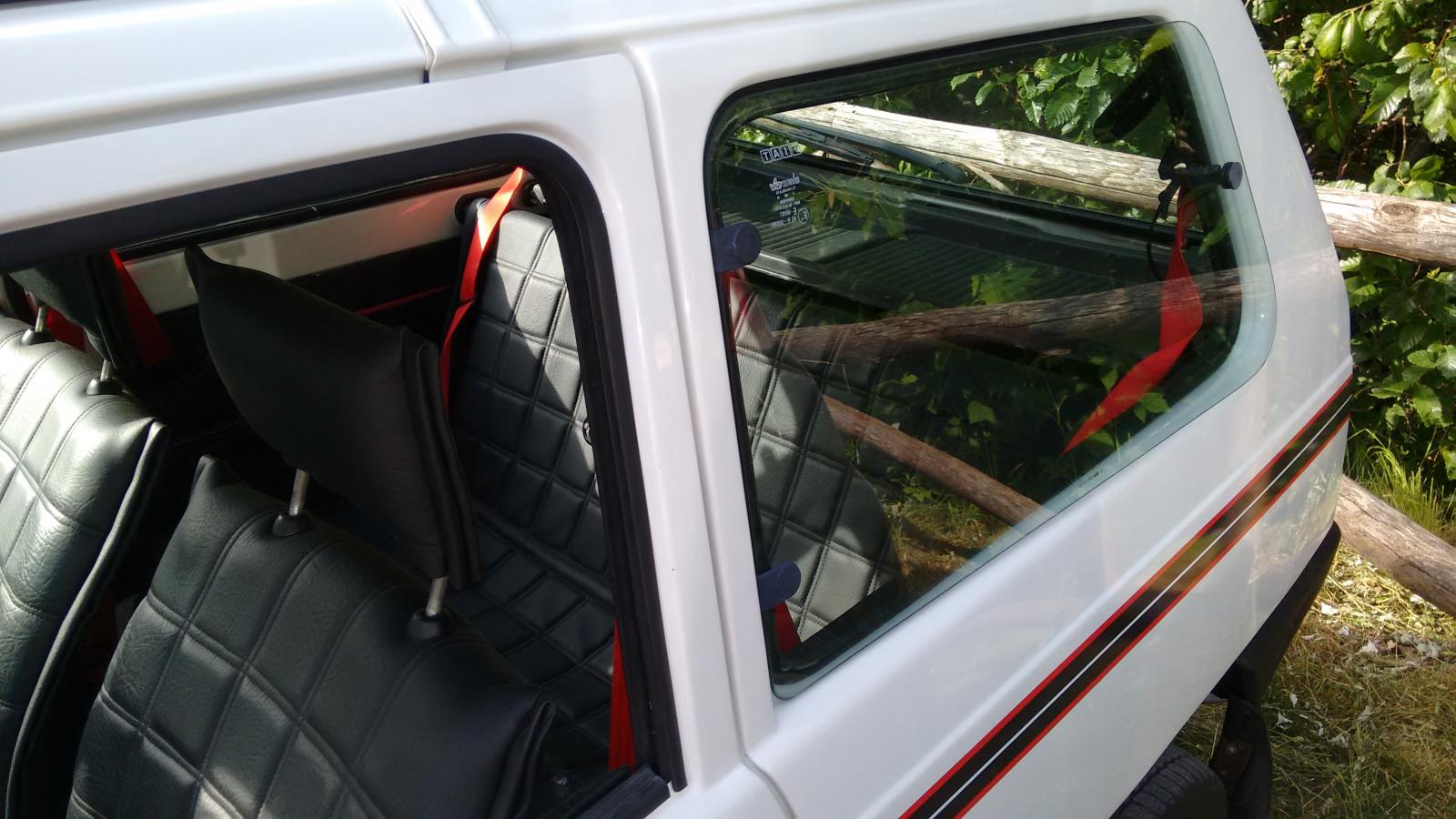

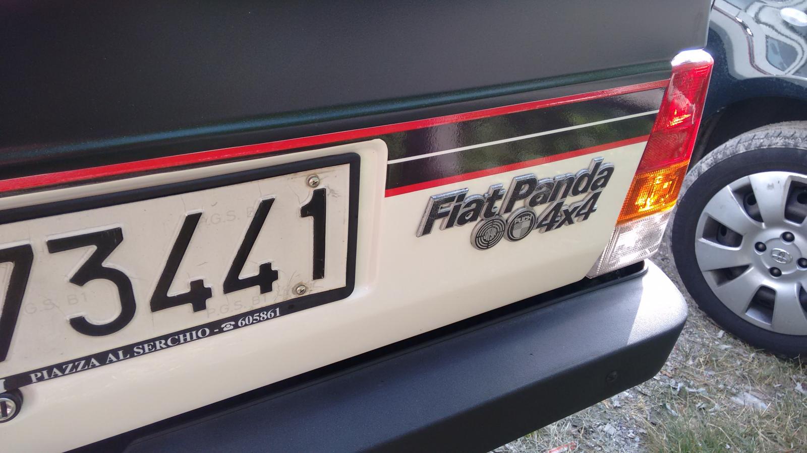

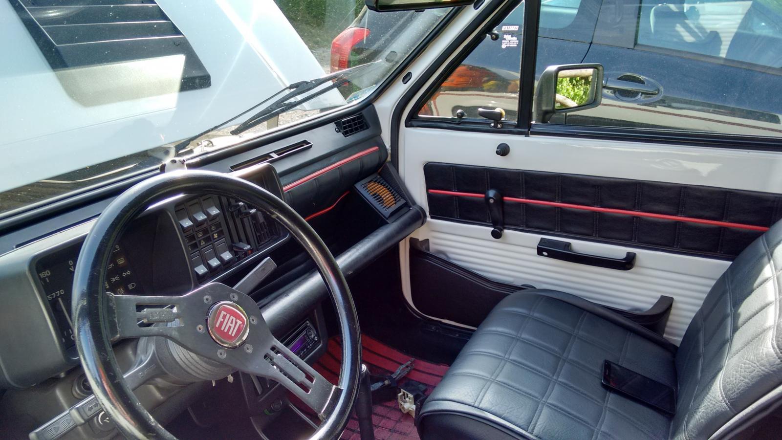

I did think Dave's example was a special edition, what with the red seatbelts and interior stripes, but there have been hundreds of special editions of Fiat Pandas over the ages it's difficult to be exact...
It's got to be this...
The site I lifted the images off says it has something to do with Belgium, but it could probably be anything...

The metal 3 prong cannister flasher unit is an old relay type, and with a bit of lack of oomph in the circuits it can cause the above issues. You can check earths, hazard switches etc, but this type of flasher unit causes these issues- for the sake of a fiver, change it first to a solid state one.

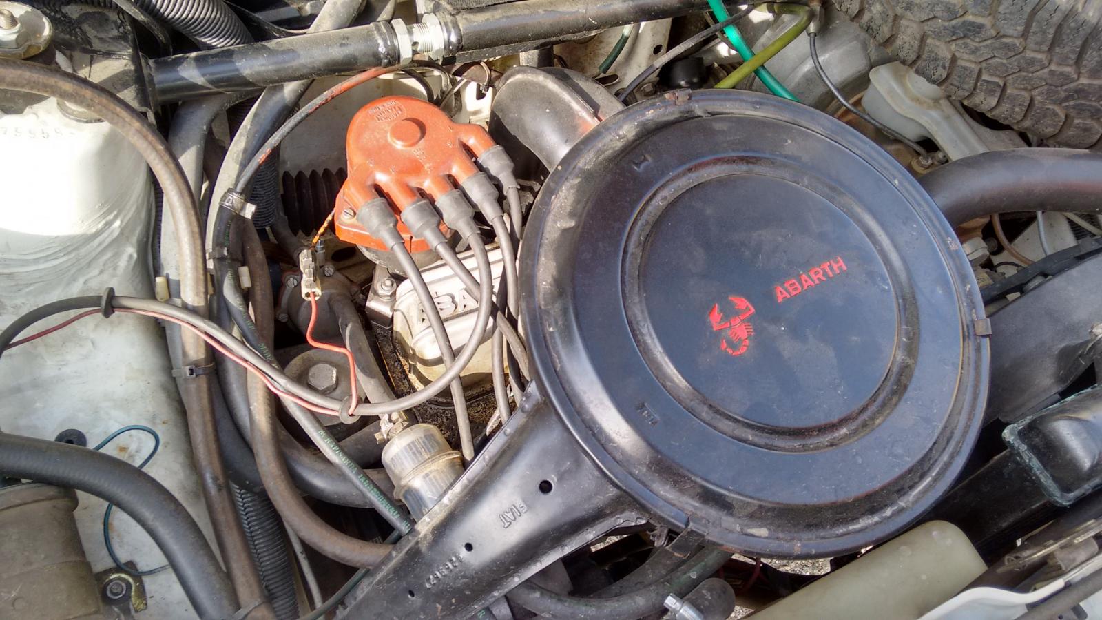

I was told that the roof was completely original though the rest of the paintwork isn't.  The car is a special edition, very special with the Arbath engine!  Roof rack is a bit rubbishy but the mini bull bars and overiders with headlamp washers in them make up for that.
I fell in love with that little car, and the uk mk1 that came on the trip too, took more photo's of it than all the others that came through out the weekend - about 40 I think.

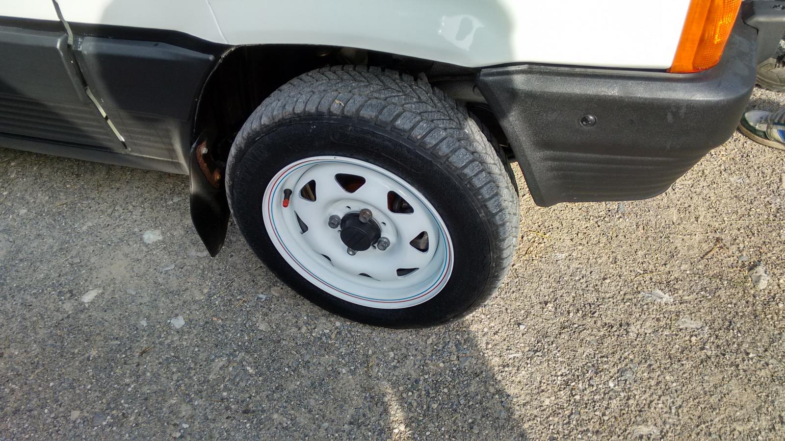

The Italians love to mod their cars but officially aren't allowed too - original engines and tyre sizes must be adhered to, cars can be seized  which break the original spec of the car!
They get around using bigger tyres by having the legally incorrect sizes  manufactured with correct dimensions moulded into them!
Still no balljoints. Fucking postie....last time this situation happened the parcel had been left at the mayors office and nobody thought to tell me. I only found out about it by chance. If it aint here tomorrow I will have to trudge to the main post office and see if they know anything about it.
Today was mostly spent getting waxoyl in my hair and eyes as I covered the arches prior to refitting the wheelarch liners and mud flaps. I am normally not a fan of mud flaps but these seem to be decent ones. I am missing the rear right arch liner, and when I was at the scrappy not a single one of the cars there had one....
I put the bumpers on, new reg plates, spent ages faffing to get the screenwash jets to work but they are both bunged up beyond saving so will need replaced. Tried to repair the rear side window catch but its buggered too, so I went to fit one I got from the scrappy last time I was there but obviously it doesnt bloody fit. They are a pain in the chuff to remove as you either need to drill out the hinge pins or smash the glass.
The funky hazard lights turned out to be a corroded connection in the fuse box.
I put the driveshafts in as I wanted to see if the gearbox is oil-tight. I poured a few litres of gear oil into the box and half a litre up my sleeve. Nice.

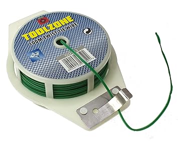

A good way to unblock screenwash jets is using a piece of thin, twist-tie garden wire with the plastic coating stripped off. It's flexible enough to pass through the jets and rigid enough to clean any crap out. This kind of stuff :
I use a pin meself, sadly what happens is you push the crap down the jet so it works for a bit, then the crap rises up again to re-block the jet. The only sure way is to remove the pipe and blow through it with an airline. Of course, the pipe will probably snap off the bottom of the jet...

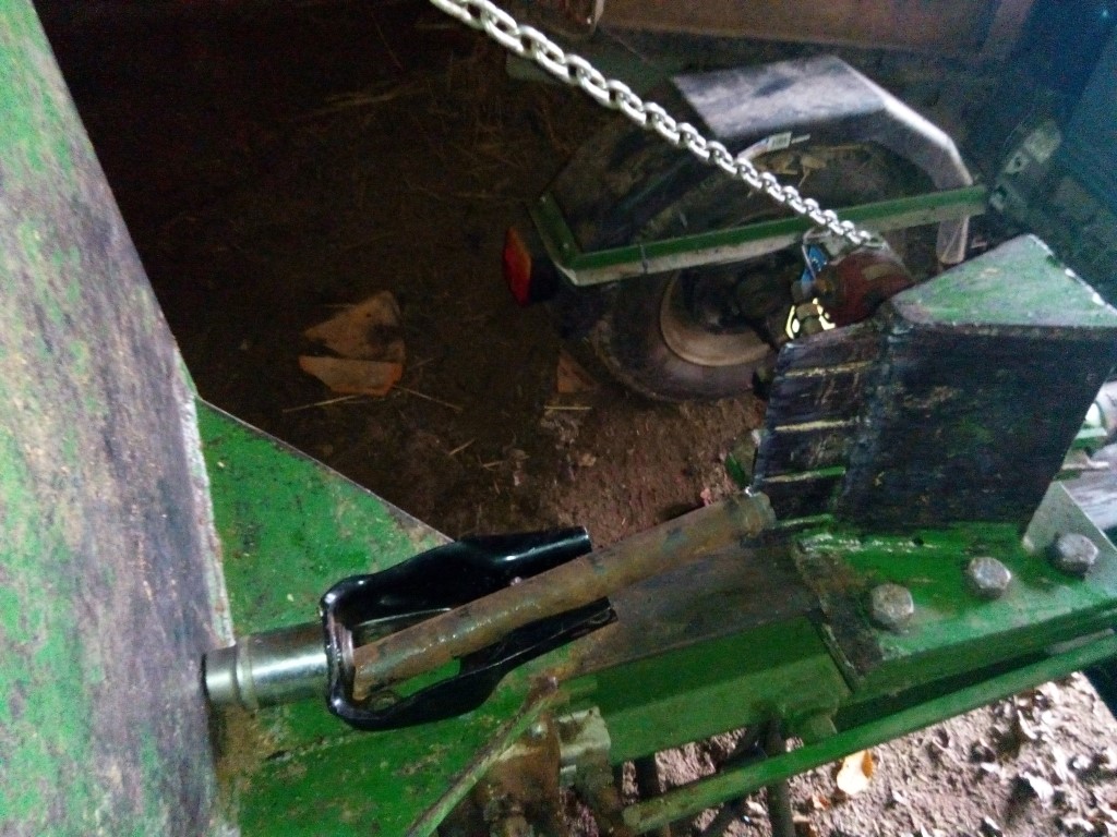

However while I had been waiting for them to arrive I had given no thought at all to how I was to press them into the hub carrier. They are a bastard tight interference fit in the hub carrier with a snap ring to lock them in place.
I dont have a press of any kind, so having looked on the internet, started messing with sockets and washers and stuff, trying to draw them into place, but it wasnt working well and I was worried about breaking them.

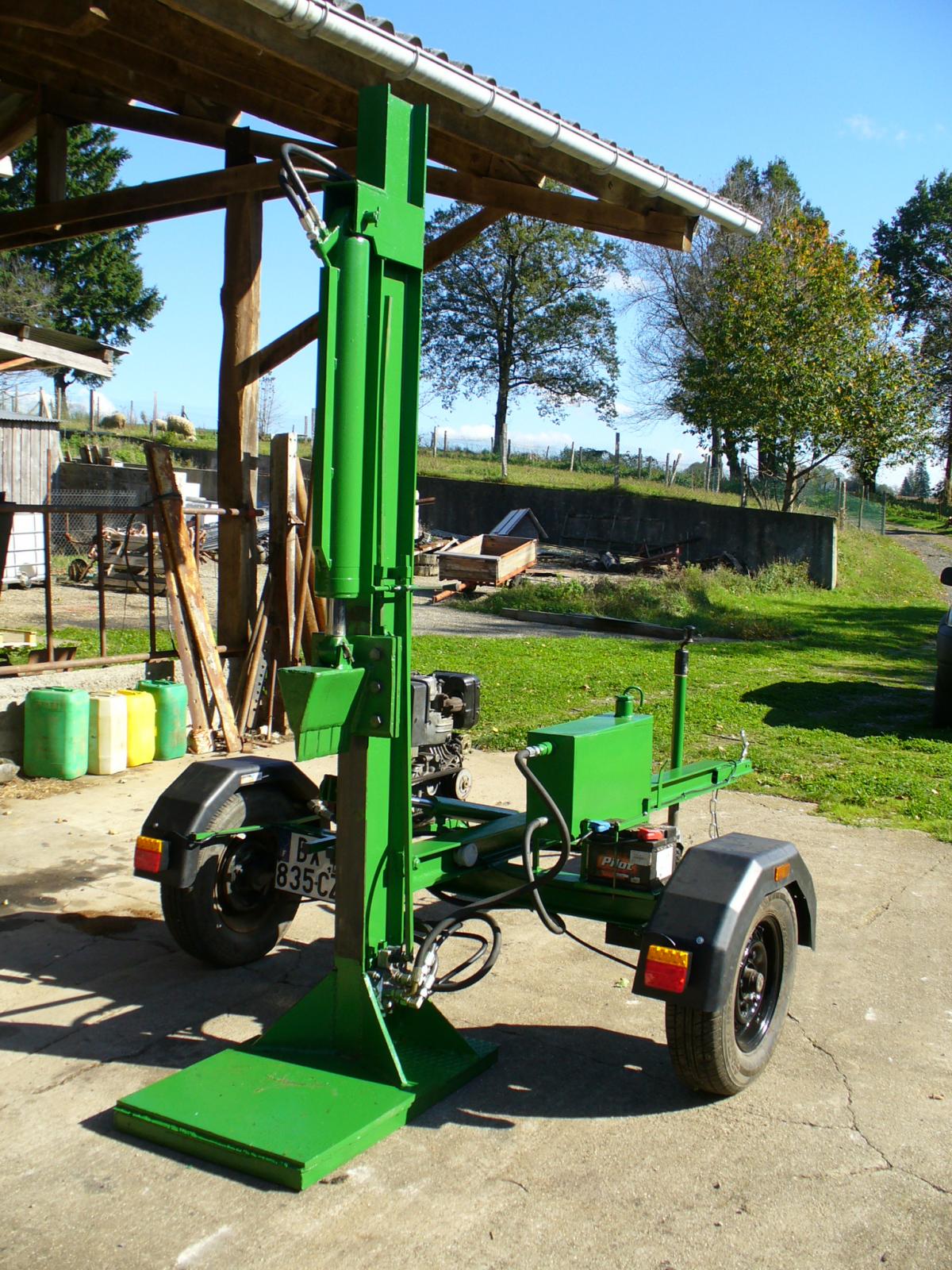

Then I remembered that I do have a press, albeit a very powerful and somewhat oversized one.....
Yeah, thats the towable log splitter I built a few years ago.
I fired it up and after much fannying with sockets and bits of metal and stuff I got them pressed in.
It was very scary, to be honest. This thing is incredibly powerful and easily capable of just squishing everything flat as fuck. Also due to free play in it, easily capable of firing bits out at 2000 mph if they slipped under pressure.

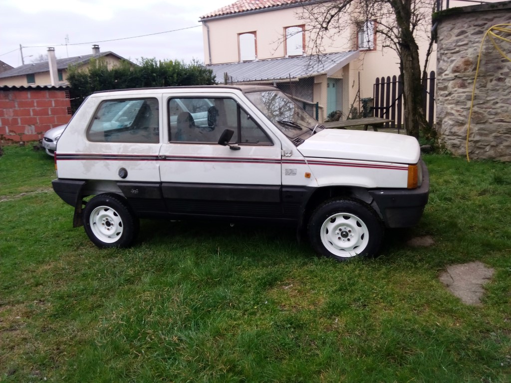

So, slightly over a month after starting, it made its maiden voyage from the garage to the top of the garden- about 20 meters.

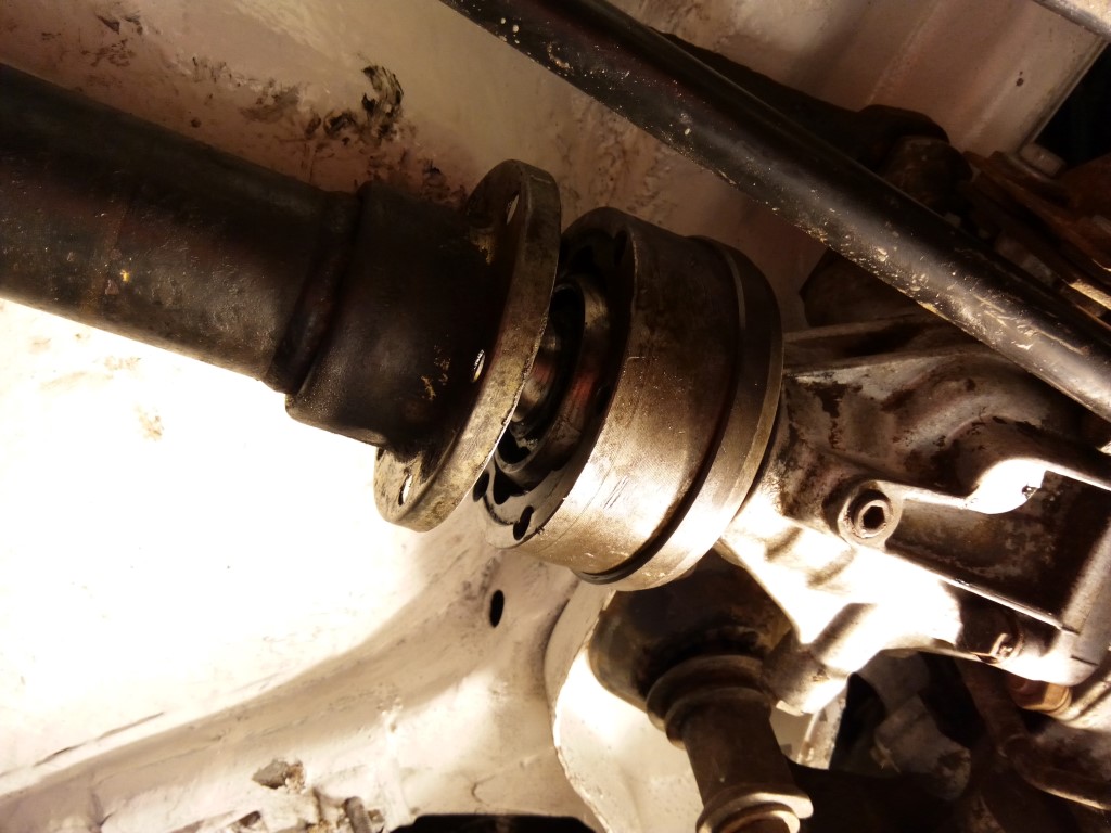

Something isnt right though, there is a rythmic thump and jerk from the drivetrain so I think a prop joint is not swiveling as it should.
Also, the ignition timing is way out - this is due to my own cack-handedness. When I pulled the distributor out I assumed it would be like an A-series engine which has a slot for the dizzy drive, so it can only go back the right way or 180 degrees out. Turns out this one has a spline drive so can go back loads of different ways. I took my best guess, but it doesnt seem right. A proper road test is needed once its rolling properly.
Love that log splitter, it looks better than some branded ones. How does it operate? Hopefully with two hands on the controls. :-D
The main ram is one of a pair from the compactor of a rubbish lorry, apparently. There is a second ram from the rear door of a hay baler to lift the main part from horizontal for towing to vertical when splitting. Its got a Honda single cylinder air cooled diesel motor running a double drive belt to the pump. Chassis is random steel scrap from the farm and the suspension units are a pair from a rotten old car transporter I broke up.
Two handed operation....not really, no. Its got a single control lever for up and down and an ingenious (even if I say so myself) mechanism for it to retract automatically and stop at any desired height, ie 60 cm for splitting 50cm logs.

So the rythmic clunk and jerk was due to the front prop joint, as suspected.
I somehow managed to put it back together out of synch and it would bend one way but not the other.
Its a horrible job to do this.....six large ball bearings are held by a cage in the middle of the joint and need slotted in one at a time as you turn it and angle it. Obviously you are on your back with hands in the air, everything is clagged in grease and its generally a hassle. First ball in, turn a bit, second ball in, turn a bit, third ball in, first ball falls out and hits you on the forehead, fourth ball in, second ball hits you on the forehead.....repeat for 17 minutes. Just seconds before you flip the fuck out and set fire to everything, it all slots together really easily.

A bit of trial and error revealed as I suspected I had got the distributer timing well out, so I sorted that and it runs much better, although the idle is rather high. I will need to ask Brother in Law, but I think it was like that when bought.
