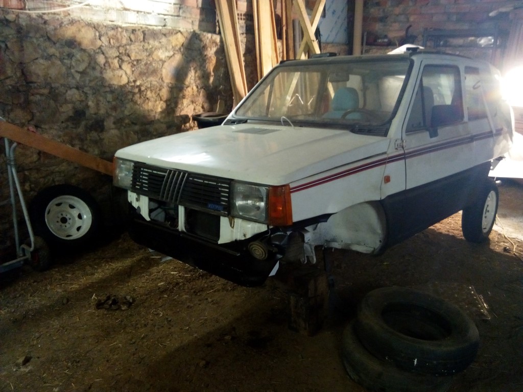

Daves Panda. minor fettling

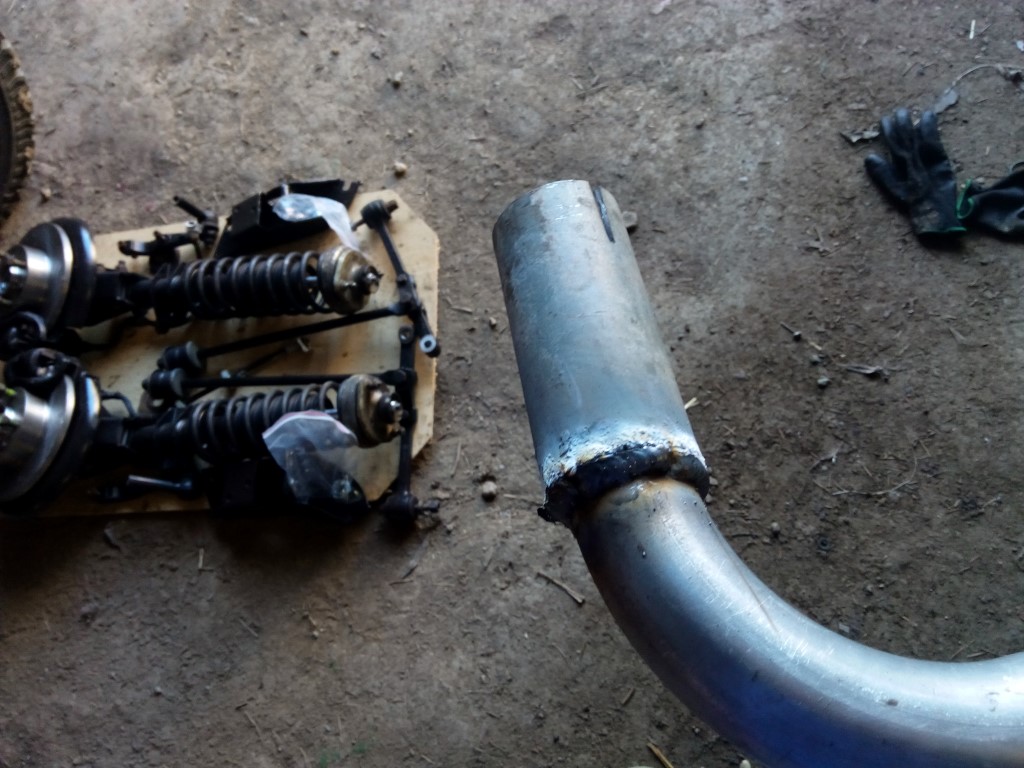

Couldnt find a proper exhaust sleeve or suitable bit of thinwall, so made an adaptor out of scaffolding pipe as I had some lying and its just about the right inner diameter. This joint will probably outlast the rest of the exhaust by factor of ten.

Oh... My... God, a hero in the making, not only are you doing sterling work on one of the finest cars known to man, you also like a bit of low end pyromania and messing with toxic fumes. Good effort!

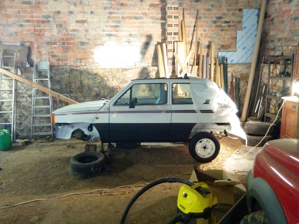

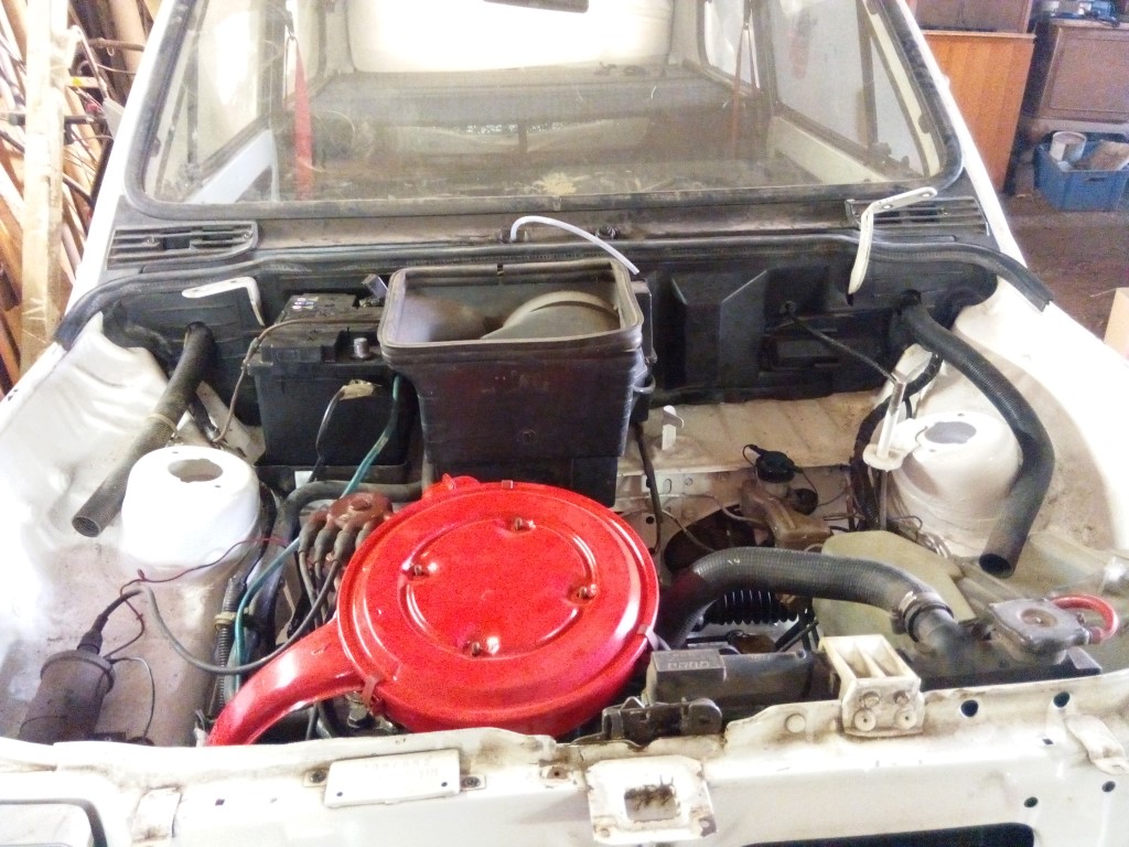

Well, it ran eventually.
Preliminary prognosis postulated that the petrol pump wasnt pumping petrol, so I pulled it off and blew through it with the compressor while holding it in the vise and pumping the cam lobe with a pair of pliers. It blew out a load of dirt then started pumping fine so back on it went and she fired right up.
I got the engine bay pretty much finished with he loom routed and clipped properly, the bulkhead plastic in place, fuse box fixed down, screenwas tank in (had to open up and reseal on of the pumps as it was leaking) and filled it with oil and coolant.
Lights grill and bonnet went on.

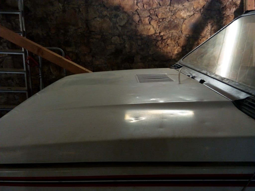

The hail damage on the bonnet is worse than I remembered. Will definately need to change it in the future.

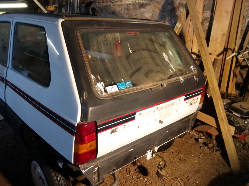

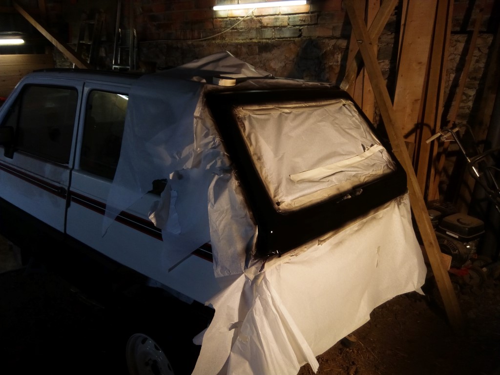

Then set about the bootlid. As standard on this special edition the top half is satin black and the rest white. The satin was a mess and has been redone with a brush so I sanded that down and spray painted it. I am currently making an arse of spraying the white section, which had a few rust blebs to sort out. Paint reactions all over the place so I will let it harden tonight and sand down tomorrow for another try.
