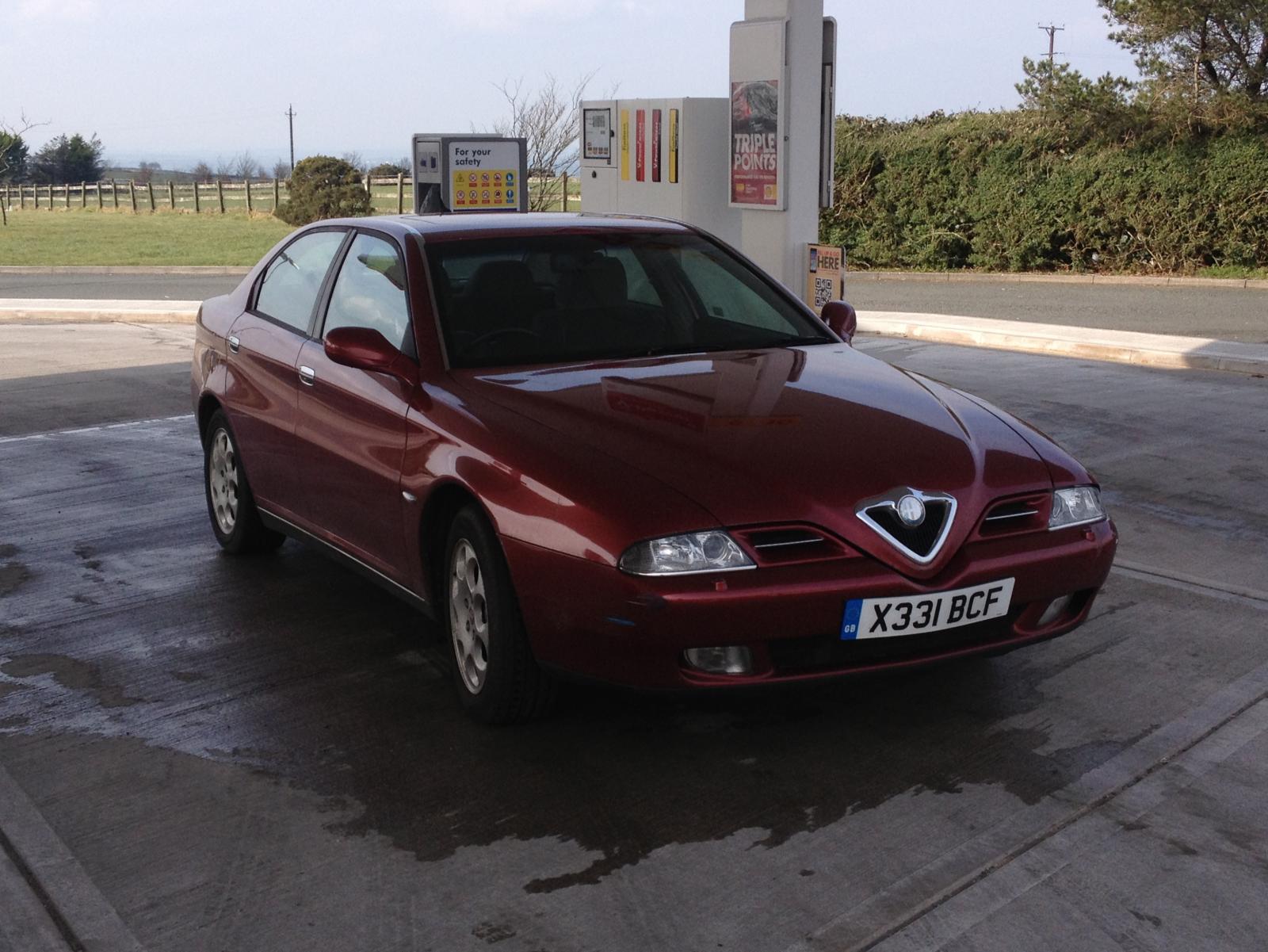

Been using this entirely uneventfully these last weeks; pleasant to cruise about in, and different/ tuneful enough to keep me interested. All was well untill last weekend......
I'd been running about with the fuel light on; but the gauge hovering between 1/4 and empty. Came to start it in the morning and after coughing the busso v6 died and refused to fire again. I switched cars and later on came back, added a 5l jerry can's worth to the tank. Still no joy. The following day I added another 5L and still plenty of cranking but it still refused to fire. Checked the fuel pump cut off reset- fine. Checked all related relays and fuses. A reluctant assistant could hear the pump priming in the tank. I disconnected the MAF- made no difference. It broke down at an unlit far end of an industrial estate and for a few days in snatched bits of time I was clambering around in the dark, in every sense.
There were a few other unexplored things ( immobiliser/ crank sensor playing up) but I'd read that the shape of the tank and the position of the fuel pick up, if the car is parked nose downhill ( it was just about) can cause problems like this if the car is very low on fuel. One guy apparently had to add 15L of fuel before it started properly. I Lobbed a final
Hopeful 5L in....... and it fired first turn of the key!

On some Astras half a dozen years ago, if you parked on a slope then it may refuse to fire up because it thought there was a low oil level issue. Epic sensor position fail in the sump.
It's the swirl pot that the fuel pump sits in . If you empty that then you may have to put quite a bit of fuel in to fill it back up . At least your close to a fuel station 😄
I used to get this with my sd1 if I parked it on a slope for a prolonged time. It needed 2 gallons to get it going. I only figured this out after taking the fuel pump out.

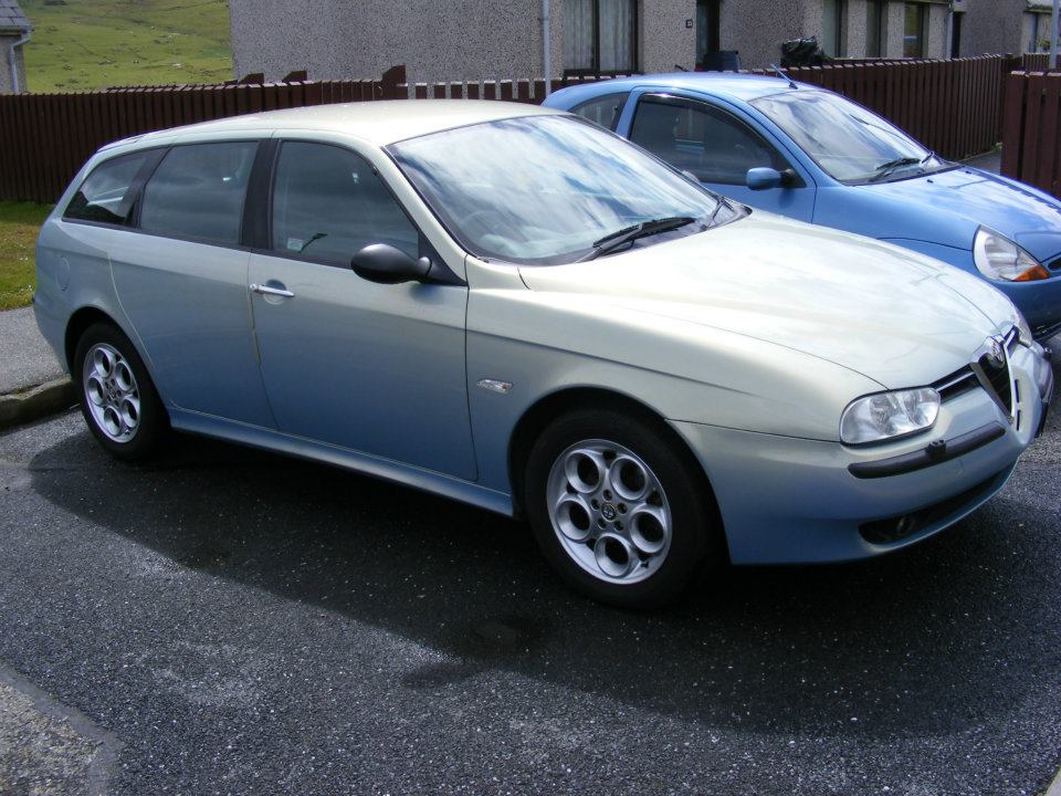

I had a 2.0 Twinspark 156 Sportwagon. Bought for £750 off eBay sight unseen as you do. Had an Alfa specialist do the belts ect before collection (that was another £400) and then it ran faultlessly for near on 18 months. Sold it with full MoT and the belts not needing doing for another 20,000 miles but nobody wanted it - ended up virtually giving it away for £450
Would I have another Alfa? Hell, yes :-)

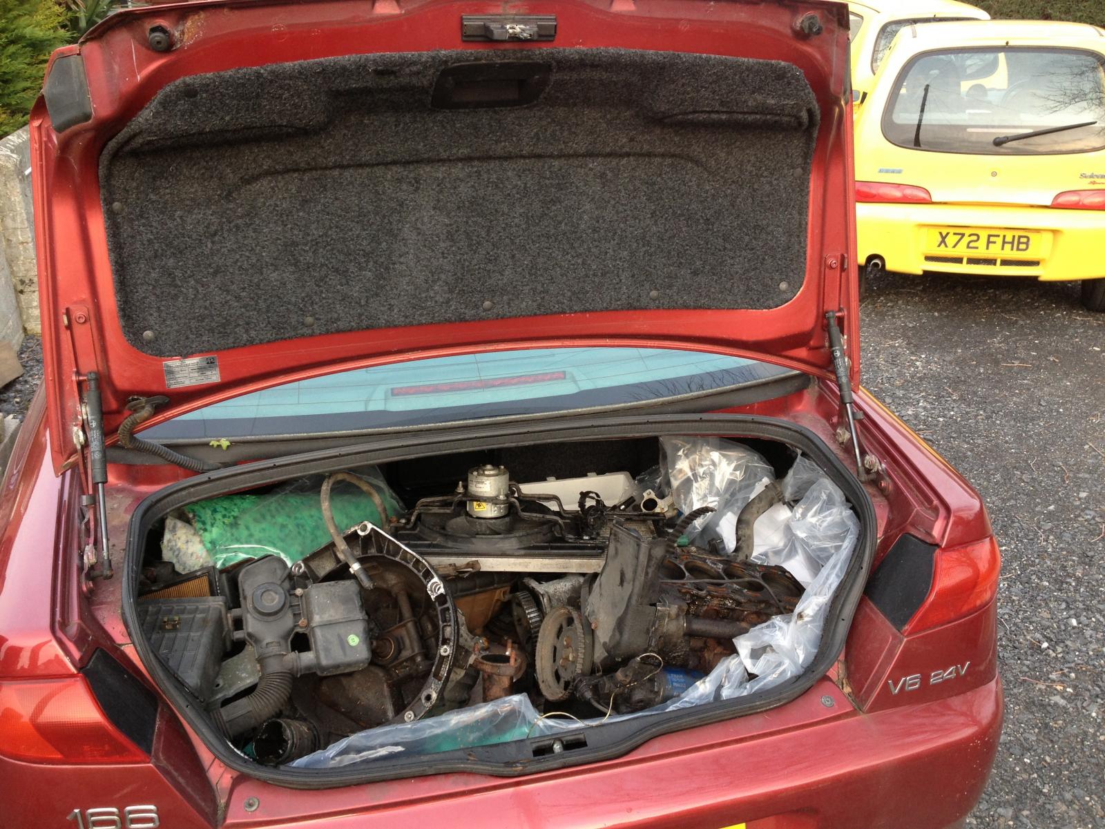

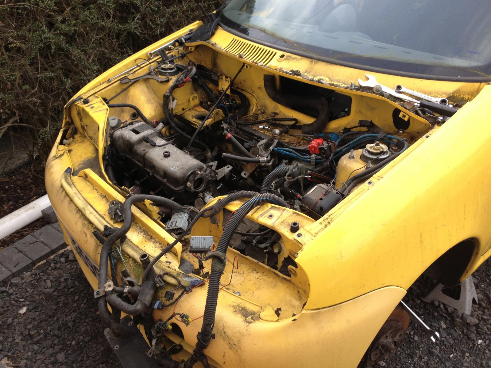

When Dermist posted up details of an early seicento sporting he had surplus to requirements and was breaking, with some free parts going, a plan was made to whizz up the m5 and lend a hand, as the oily bits of my cinquecento are identical. Said cinq has a bit of a tired engine, so having a replacement that can be fettled in readiness before the one in the car goes bang is the plan.
En route
Open heart surgery
Filling the 166 up with bits as a second yellow seicento looks on nervously
Thanks goes to Dermist for his time and knowledge, and for donating a replacement engine/gearbox/rad for the cinquecento.
