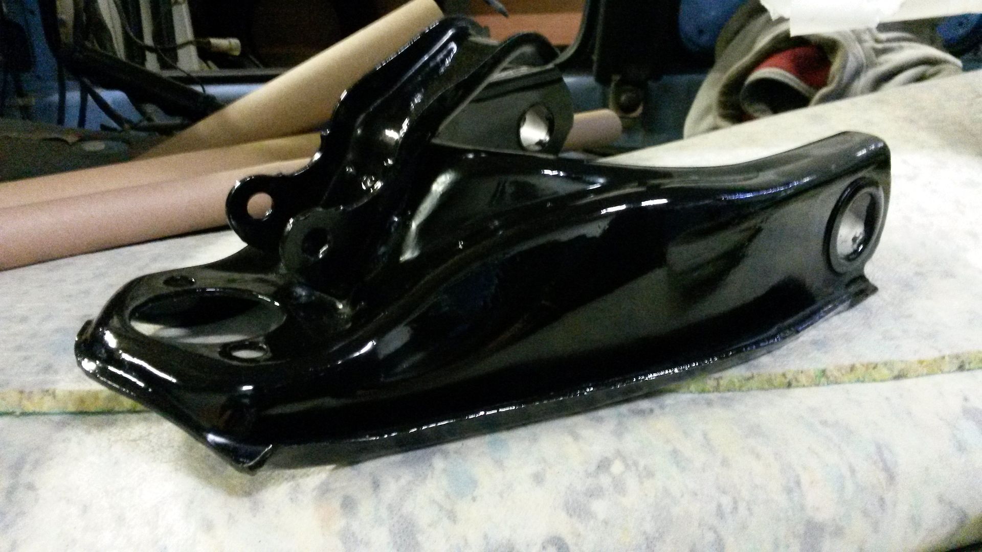

Been down the unit again today, more parts have been hand stripped for painting. The stuff I painted yesterday came out very reasonably considering the time of year.
Behold the blackness up close -
The whole "trying to avoid damaging paint" gig starts here!
