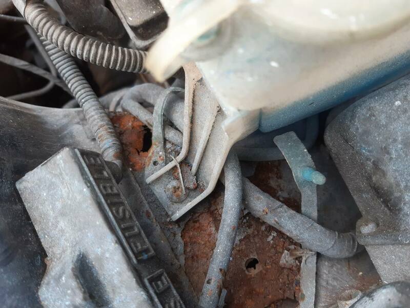

30mins at Ginger's Automotive Fabrications Ltd  and the inner wing is fixerated. It actually took longer to get the Herald and Dolly started and moved out of the way than it did to execute the repair...
146937678_124066342862441_6166743722377741241_n.thumb.jpg.8b8a56589feb38f46dc5b4e1d9d252bc.jpg
146863742_1214503475611775_8502692789983762757_n.thumb.jpg.8766a4d3a8ec138e93639cd26da81704.jpg
No seam sealer or anything, to prove it's been seam welded. After it's MOT'd I'll seal and paint it a more appropriate hue.
Also stuck the plastic trim bumper trim back on, looks way less shit. Cabled tied on until the sealant dries, didn't fancy drilling holes in the new under grille panel...

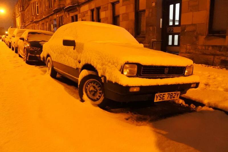

Celebratory snow:
