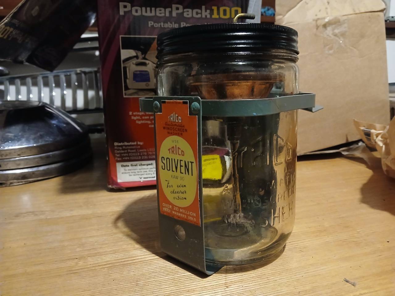

What a magical time the 50s were. The attention to detail to provide the motorist with somewhere to preserve pickled eggs; truly we never had is so good.

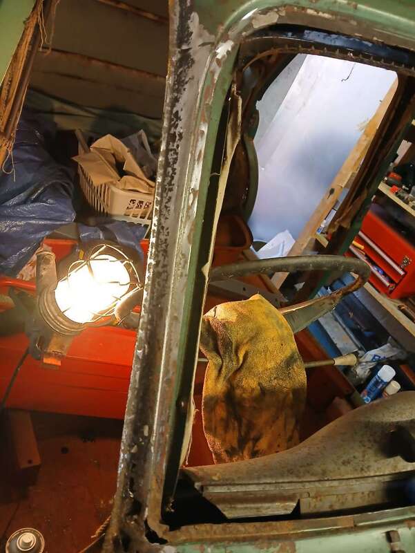

Frame is generally very good.
The bottom corners are actually better than I thought they'd be...

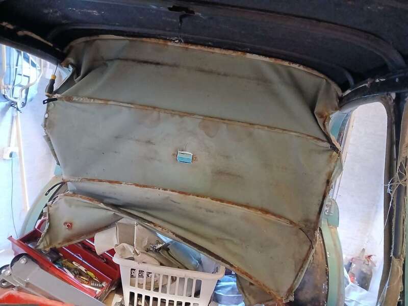

Then I dropped the headliner.
What a cunt of a job. It's held in on all sides by being  stretched round and perforated onto a rail.
I managed to largely get it out undamaged, there were a few tears due to the material being incredibly fragile and having lost any ability to stretch.
The best way I can describe it is being like a cheap plastic table cloth, like you used to get in 1990s cafes. I guess it's just vinyl without the usual faux leather texture. It's not actually all the way out, as that'd require removing the rear screen, which I'm trying to avoid...

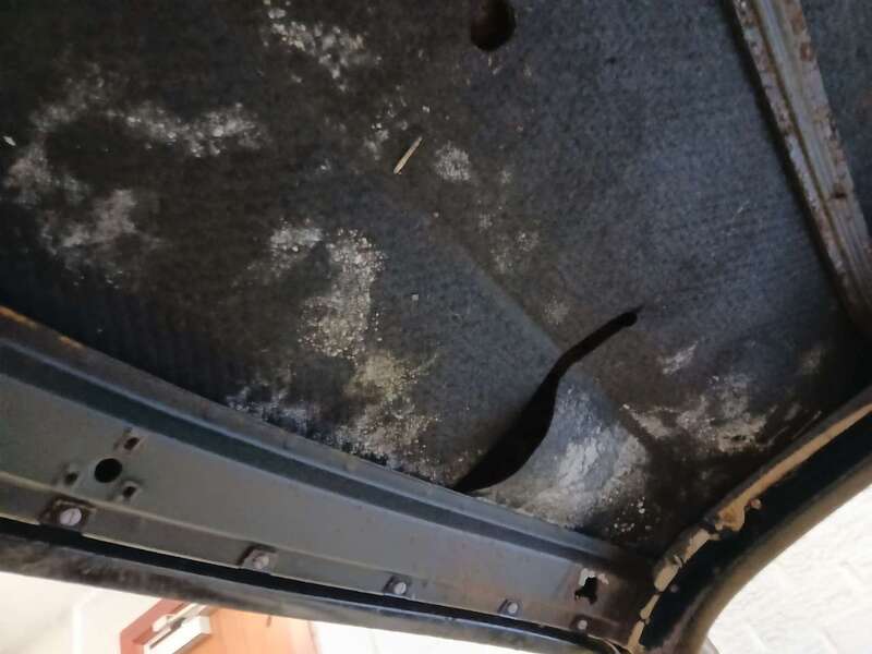

That's not bad at all on the screen surround, all things considered, and that style of headlining isn't actually too bad a job to make up, especially since you've got one to template from.  Considering the full restoration you're doing here, taking the glass out isn't so much of a problem as it might be for doing the headlining since it will give you chance to inspect the rear screen surround.  Almost every car of this era seems to leak around the rear screen and I doubt this one will be any exception.
The board in the roof is probably bitumen infused sound deadening and probably doesn't have asbestos in it as it wouldn't serve any practical benefit in that location.  Well worth putting some modern version of it in when you get to that point, helps reduce not just panel boom but also the build up of condensation.  You can apply the same to the inside of the boot lid too so that it reduces the chance of a mouldy boot interior.

I'd really like to preserve the original material if possible,but it's certainly not a complex thing to replicate.
My current plan is to bond a strip of new material to the inside edge to try and hold the stressed areas together.

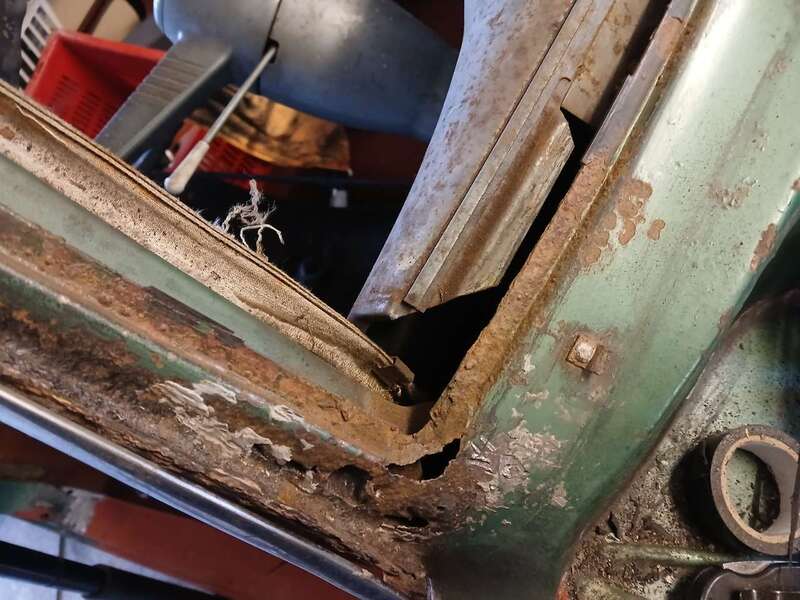

Never a good sign when interior trim looks like this...

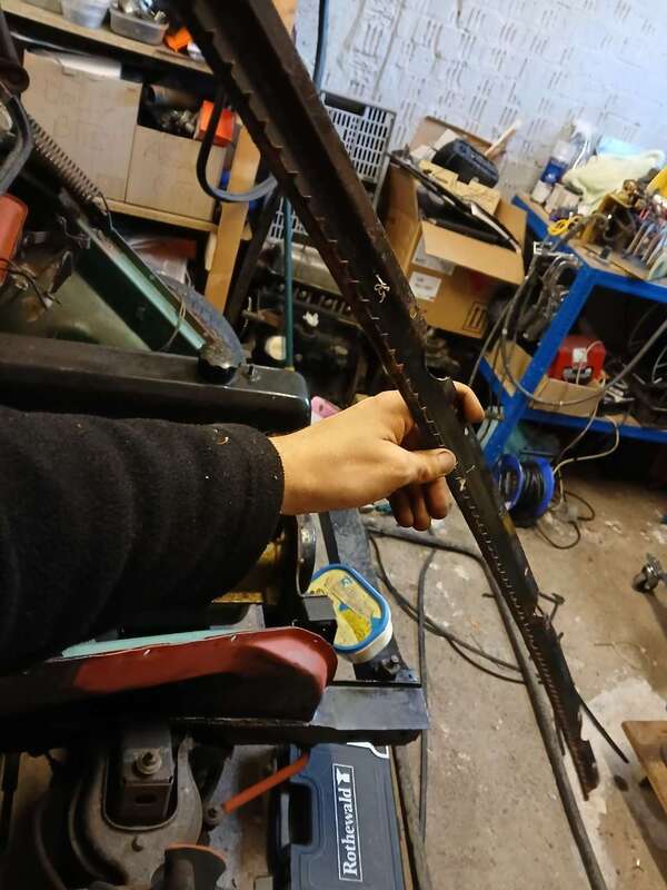

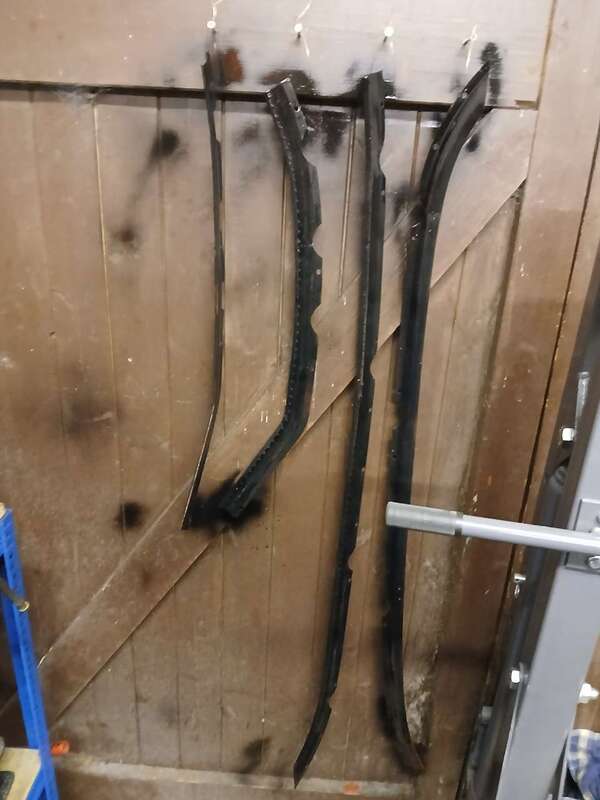

Just the headlining securing rails, so not under any real stress.
Attacked with a wire wheel, acided, zinc primer and rattle can black applied.

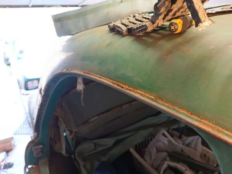

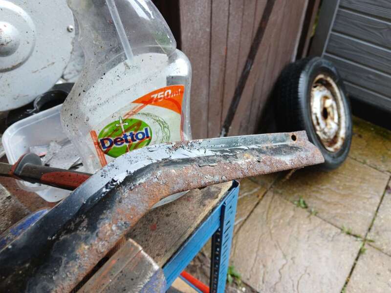

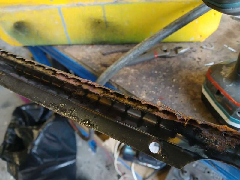

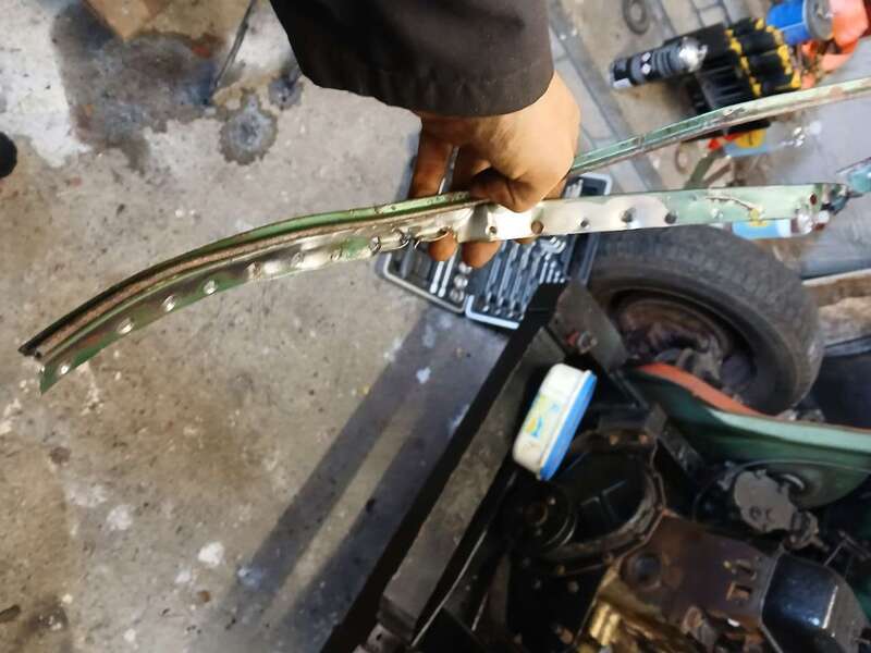

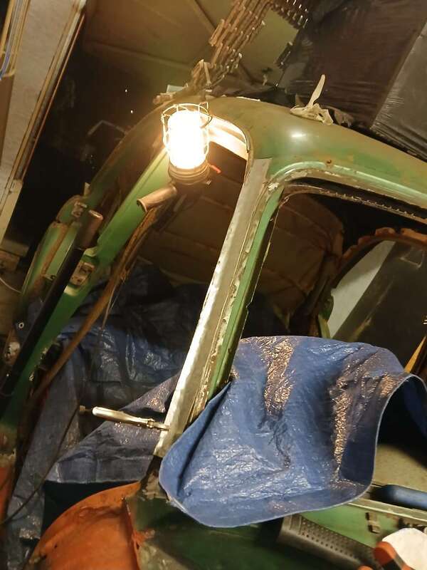

Then I carefully pried the stainless trim off the gutters.
Then set about drilling the spot welds for the worst sections.

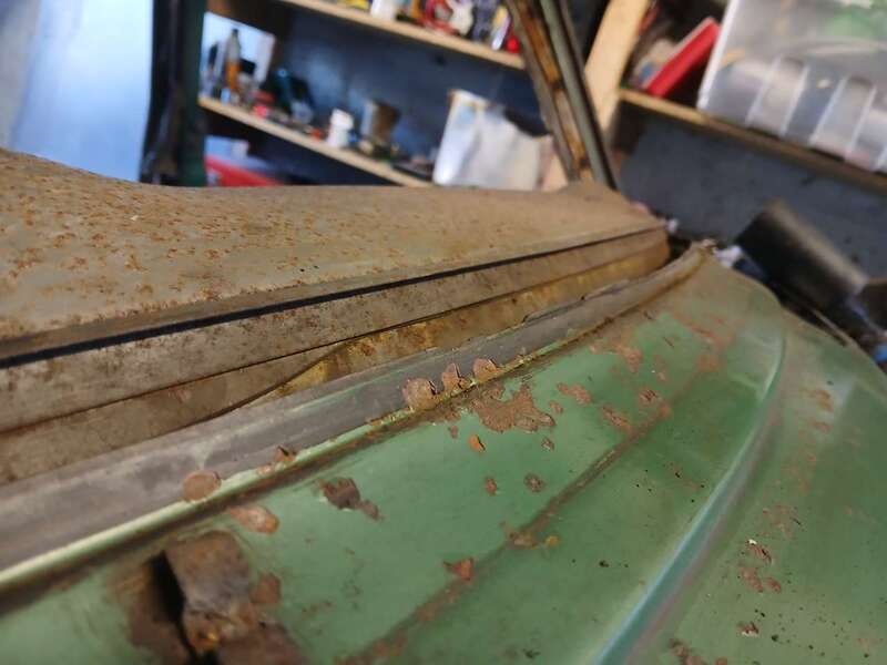

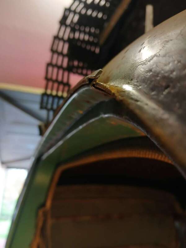

Interesting profile.
Attacking the A pillar with the flap disc revealed more surviving metal than expected. I'm too used to working on the Acclaim and it's 0.8mm steel...
The pitted stuff is getting cut out anyway, but it's solid enough to use as a buck for roughing out the start of a repair panel...
All of this is hidden by chrome/stainless trim, so it'll not need to be completely perfect.

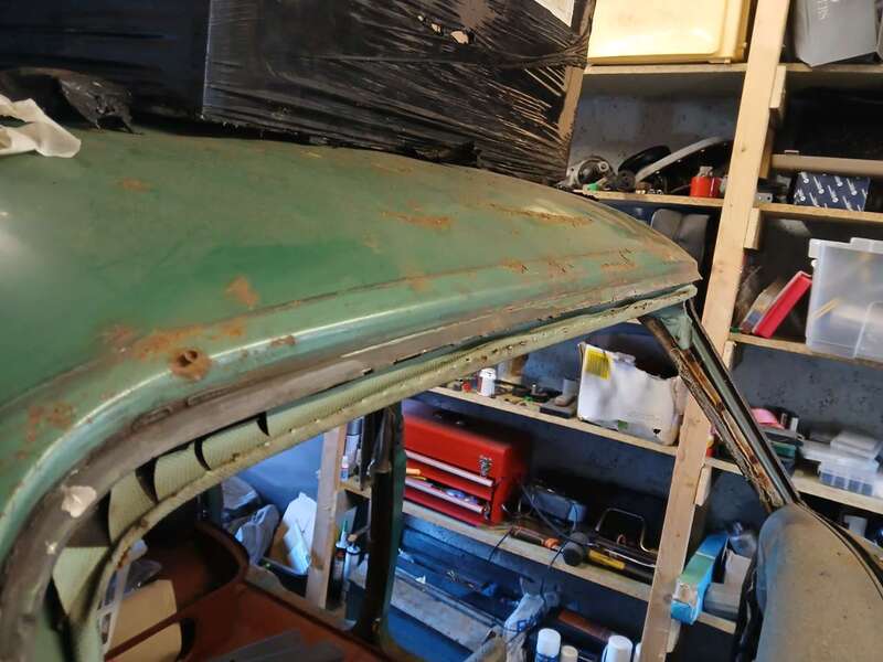

I also started wire brushing and aciding the roof. Hence the tarp.

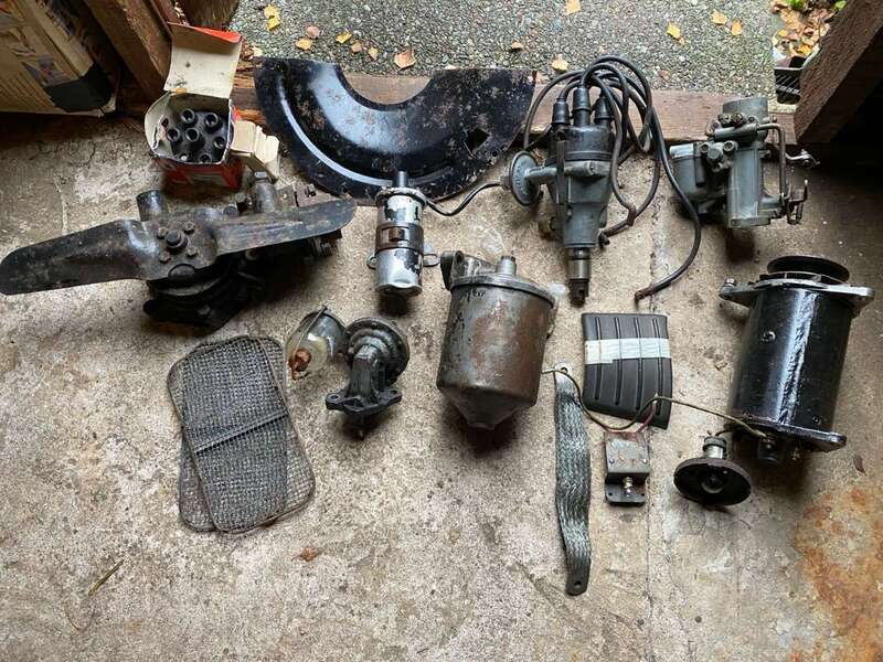

The previous owner also messaged to say we'd missed a box of stuff.
Yes. I'd say there are some bits there that would be handy to have...
