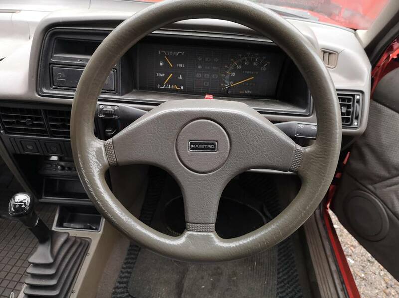

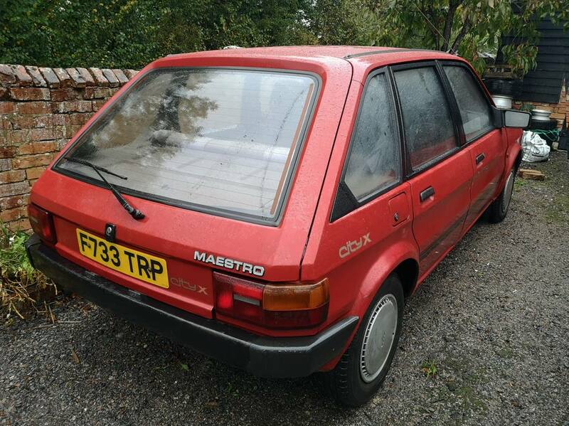

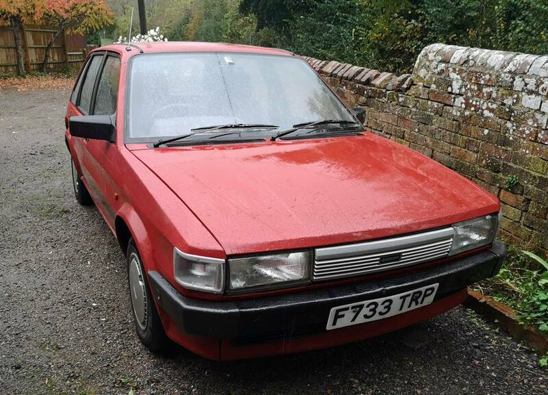

Six-cylinder Posted October 21, 2020 Author Posted October 21, 2020 What’s Broken The rain makes the paint look shiny when it is a bit flat. The rear wheel arches have been home repaired with filler and an aerosol paint. The dash is badly cracked. I have not been brave enough to look under the seat covers. One of the rear fog lights is not working The fuel gauge and temp gauge are not working The choke is set wrong and over revs on full choke then does not adjust nicely as you push it in. I guess the worst bit is a vagueness to the steering and a different feel cornering left to right. Also the steering wheel is lop sided. Thing is Slowsilver had to have a look at the non-working fog light in case it only had one anyway. Turns out to be a poor connection in the bulb holder. Flushed with success he decided to tackle the fuel/temp gauges not working and because it is both is thinking voltage stabiliser so is taking the dash apart sat in the car in the rain! LightBulbFun, egg, DoctorRetro and 5 others 8

Slowsilver Posted October 21, 2020 Posted October 21, 2020 1 hour ago, Six-cylinder said: What’s Broken The rain makes the paint look shiny when it is a bit flat. The rear wheel arches have been home repaired with filler and an aerosol paint. The dash is badly cracked. I have not been brave enough to look under the seat covers. One of the rear fog lights is not working The fuel gauge and temp gauge are not working The choke is set wrong and over revs on full choke then does not adjust nicely as you push it in. I guess the worst bit is a vagueness to the steering and a different feel cornering left to right. Also the steering wheel is lop sided. Thing is Slowsilver had to have a look at the non-working fog light in case it only had one anyway. Turns out to be a poor connection in the bulb holder. Flushed with success he decided to tackle the fuel/temp gauges not working and because it is both is thinking voltage stabiliser so is taking the dash apart sat in the car in the rain! I did take a quick peek under the driver's seat cover at a couple of areas of the seat, including the right-hand side squab bolster which is usually the area that wears through first, and they didn't look too bad. Will be interesting to take them off if it ever stops raining. I think this is very much not only a one owner but also a one occupier car. The top hinge on the driver's door is quite badly worn, causing the door to drop and it needs a good slam to shut it. But the other three doors are still tight and I suspect the back seats have hardly, if ever, been sat on. It came with a HBOL which unfortunately only covered models up to 1987. This contained three different dashboard variants, none of which bore any resemblance to the one in this car. After much effing and blinding I worked out how to actually get it out and looked for the instrument voltage regulator but it doesn't appear to have one. Did find a 63 ohm resistor, which measured just that, and three diodes, one of which read about 0.8v in one direction and open-circuit in the other. which seems about right, and two which read about 30mV in either direction, which doesn't. At this point I lost interest and nailed it all back together again. More research required I think, but like the prat that I am, I completely forgot to take any photos of the back of the instrument panel while it was out, so I will have to rely on my memory, which is shaky at the best of times. Still at least it now has all its lights working and a (hopefully) charged battery. Small victories Godber. P.S. What kind of person voluntarily spends 2 hours in the cold and the pouring rain sitting in an old Maestro swearing at the dashboard? Answers on a postcard please. catsinthewelder, AnthonyG, Mrs6C and 12 others 11 1 3

AnthonyG Posted October 21, 2020 Posted October 21, 2020 @SlowsilverThe dashboard in all post 87 Maestros is a Montego one. From memory by there was a very half-arsed refresh of the Maestro in late 87 or spring 88 and the Montego dash was a major part of that. I assume all switchgear, controls on this one is all Montego as well. I have a HBOL for Montego 2.0, if you need any scans. Or you/Chris can have it if it helps. Let me know and I will chuck in the post. HMC and Slowsilver 1 1
hairnet Posted October 21, 2020 Posted October 21, 2020 32 minutes ago, Six-cylinder said: Just makes me a City X owner feel inferior! even sat for 10 years ours will have less electrical problems it was nice when it ran
Six-cylinder Posted October 21, 2020 Author Posted October 21, 2020 4 minutes ago, AnthonyG said: The dashboard in all post late 87 Maestros is a Montego one. I assume all switchgear, controls on this etc is all Montego as well. I have a HBOL for Montego 2.0, if you need any scans. Or Chris can have it if he wants it. Thanks but it came with a HBOL that does not line up with what in behind the dash.

AnthonyG Posted October 21, 2020 Posted October 21, 2020 This is the picture in the Montego HBOL, which covers the dash and instruments in your Maestro;
