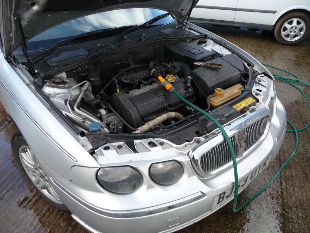

  • Heater cold on passenger side: Flushed and back-flushed the heater matrix several times, after a week driving round with a washing powder tablet dissolved in the coolant. Now lovely and toasty on both sides!
