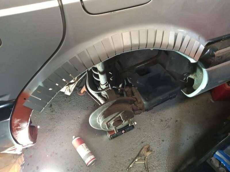

Probably not the best view but hopefully you can see what I am trying to achieve? Or maybe not...
To get better access I figured I would "just remove" the near side suspension, hah hah several hours later and its only partially off even now. Basically the main retaining nut/bolt for the main arm is so corroded its just a blob of corroded crap at each end. I could weld a nut on the bolt end but I cannot get at the nut as the fuel tank is in the way, I cant drop the fuel tank  because of the cunning way I have supported the weight of the car using  ramps and a 3 ton axle stand (I cannot risk the inner jack points as they are crumbly and are next on the repair list.
Anyway, I pulled out the shock, removed the brake caliper and disc, then dropped the arm as far out the way as I could. This is annoying as the arm really needs re bushing, so I will have to get it off, just not right.  On the suspension front I have found the shock absorber is knackered , no surprise there and the anti roll bar drop links don't look too clever so they have all gone onto my MOT list.
All the space..

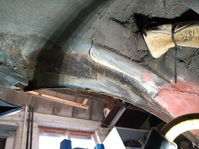

Before I tackled the suspension I made a thing.....  I decided to try and fab up a section of wheel arch.
After much offering up, prodding and poking and thinking and procrastinating...
I decided I didn't like it very much and decided on a different approach, yes I am going to set fire to the car.....
Okay maybe not but it has crossed my mind.  I also did eventually make some wheel arch progress, spot the difference...
The pictures are the wrong way round, but in the second pic there is some green sharpy, ie the target areas and in picture one some new metal welded in and ground back, I just need to keep plugging away.

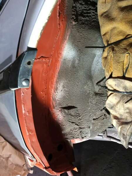

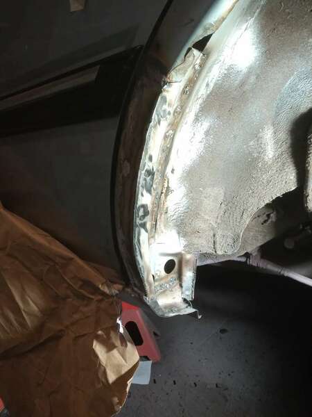

Back to more important things the wheel arch repairs have really progressed. I have completed the inner arch repairs, what a ballache that was, welding in what is still a confined space. But firstly I finished the outer arch (apart from the lip, which I am leaving till last -ish).
You get the idea! Then onto the inner.  With the new metal work I haven't/couldn't copy what Rover have done, the original inner folds around about 180degrees and is spot welded to the lip of the outer. Its a lovely rust trap and it was much more straight forward to seem weld the the new sections of inner to the outer wing above the lip.
Sorry rather crap pictures but there you go some progress. I still haven't decided what I am doing about the fuel filler, I am kicking that issue down the road!
