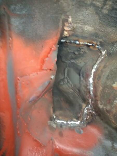

The top section of the strut has now been surgically re attached. Seem welded along the base....
And then puddle welded were the spots used to go.
I also welded it from the inside to make sure of full penertration....

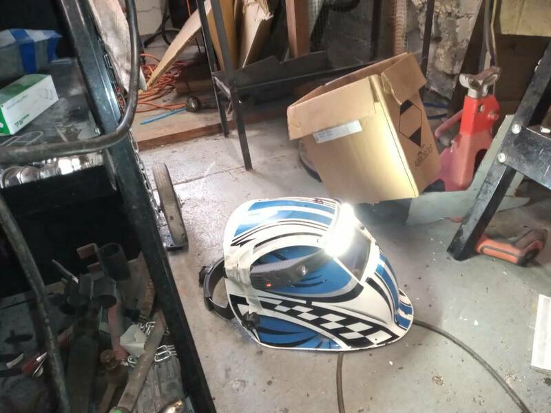

To work in awkward places like the wheel arch (see above) I have been struggling with lamps and torches etc and then I had a moment of inspiration  - why not tape the head torch to the welding mask?
Works brilliantly and cheaper than rushing out and buying a new mask with a built in torch.

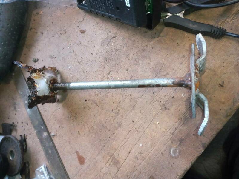

Next job on the list is rectifying an issue that was caused by gravity.... I managed to drop my copper block (used for keeping metal cool whilst welding), inside the sill by the rear wheel arch.  I have been meaning to sort this for a while but I was putting it off until I had most of the important bits done, the main reason I want to get this thing out rather than just leave it in place is to stop it banging about in the sill, because that would be really annoying (assuming this car ever goes back on the road) .
Its in there some where..
Are there you are....
That took some fiddling to get out....
And welded back up, hmm bit ugly, will the bung ever fit properly again???

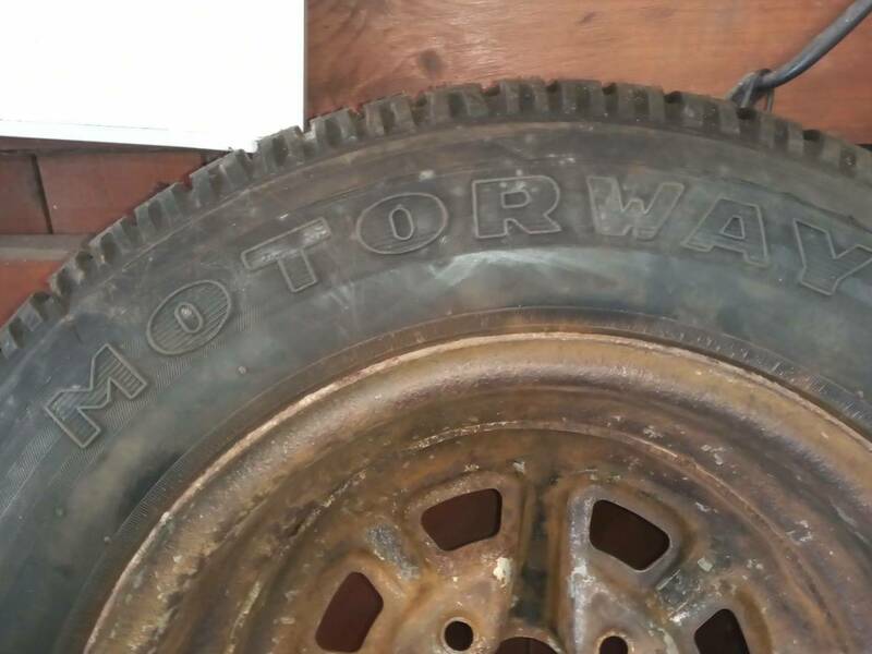

Also the wheel had got rather crusty so I cleaned that up.
One for the comedy tyre name thread?

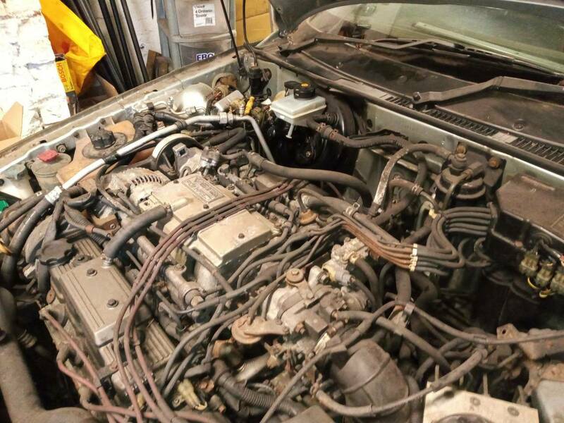

Todays update, the wheels are off and the brake bleed kit is out...
The main reason for doing this is that I had undone a union inside the cabin and removed (and refitted a rear brake line) I wanted to make sure this union wouldn't start leaking as it would be hidden under interior trim (putting the trim back is the next job).
These are cars are notoriously awkward to bleed, I have been given various bits of advice on this, one was to crack the connections on the ABS pump another was to vacuum bleed the brakes, so I thought why not try both? Firstly I set up my pressure bleeder - pumped it and then cracked off the unions, well, 3 out of 4 unions (one was utterly seized) and created a small cascade of brake fluid down the gearbox, which is what I was hoping for I think...
Next re connect the unions and start bleeding proper, first attempt on the passenger side front and I get a steady stream of fizzy brake fluid, looks like someone has fitted a soda stream in to the brake lines! 🙃 Re check the connections on the ABS pump to find brake fluid dribbling out of one of them -possibly drawing air at the same time... At this point I was a bit concerned that I had cross threaded a Union, after a bit of fiddling I found that I simply had under estimated how tight these things need to be, really fucking tight!
Once that was sorted, I upped the pressure a little and went round all 4 corners with my vacuum pump and......... We appear to have a brake pedal again, although as the car doesn't have a driver's seat it was a bit difficult to test properly! At least I can start re fitting the interior now, well next time I am off work anyway....

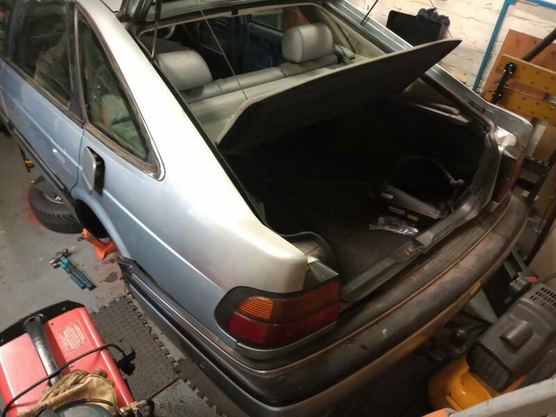

Yep  I have just pulled everything out, re fitted the boot carpet and sides, bolted the rear split fold seat backs -back in and gone on a massive hoovering/cleaning bash! So actually not got very far but it looks better.

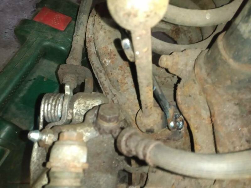

That job done onto the rear anti roll bar issues, I had disconnected it so I could get full droop on the passenger side suspension arm for welding access. On re fitting the track rods, one of the threads picked up and jammed leaving it rattling about...
No conventional spannering technique could free the nut, the shaft kept spinning and the little square section on the other side you secure with a spanner started to round off. Time to crack out the welder then! Firstly attempt to weld a sacrificial spanner to the square section.....
This went slightly too well fusing the spanner to the shaft of the drop link and the suspension arm.. On the plus side I managed to free the nut off! It just took some serious persuasion to get the drop link free from the spanner and the arm, leaving a chunk of weld blob on the arm..
Fortunately I could get my finger sander in the gap and clean it off... End result.
Not too bad and soon the area will look just as scabby as the rest of the suspension!

Well its very nearly Rover and out on the filler...... St jude..... The final little details just need sorting. Firstly the end of the filler were it meets the main rubbery hose. The end is completely smooth and which means it wont take much for the hose to pop off, which is a bit undesirable! I cannot flange the end out as the hose only just fits so the next option is to kind of Christmas cracker the end... Basically narrow the section just behind the end by cutting and welding (how else) create a waist if you see what I mean so the hose clamp has something to grip.  Sort of like this .......
Not exactly pretty (or very well in focus!) but it appears to work, well it past the yank test!
Post yank test picture.....
Next stage the extra mysterious pipe work is rather lose and rattly (on the original pipe its all in steel and welded together, cant do this as I am using copper for the extra), I don't think that is a great idea. I decided to create a bracket that I could fit P clips to, so that I can secure the extra pipeage.
Final bit of chopping was caused by the Subaru filler cap. The cap actually catches slightly on the hinge of the filler door. Fortunately the hinge area has some excess plasticky sections, which I duly trimmed down. Now it all fits.
So what does it need to finish this part of the project? Well some paint on the filler neck, careful deletion of the  word Subaru from the cap and a couple of new rubber hoses and then I can decide which bit of the car to sort next as I have now decided to try and get it through or at least to an MOT.
The filler saga is pretty much over and its going to be a while before it meets its first real challenge - a petrol pump!
Petrol cap no longer has the word Subaru on it, very important obviously!
The filler neck now looks the part, mind you I did rush this a bit and didn't let the paint dry for long enough and have a few scratches to touch in......
Got to be better than the original though!

Today I am suffering a bit of mission paralysis.
I have had a look at the horns, tested the individual horns and they both parp in satisfactory manner! So next point of issue probably the switch in the steering wheel (its normally the moving bits that fail) - could I get the  steering wheel pad off? No because its held on with two security bolts and I don't have a T25 security bit, so that's now winging its way to me via Amazon.
So what to do next? I know I will see if it still starts, it hasn't moved for at least a year so....
https://www.youtube.com/shorts/-aIKlN5_NT4
Yep I am no you tuber as you can tell! But it definitely runs, oh and in case you are wondering I am just pumping the brakes to start with to see how they felt with the servo in operation - the pedal feels pretty good.
