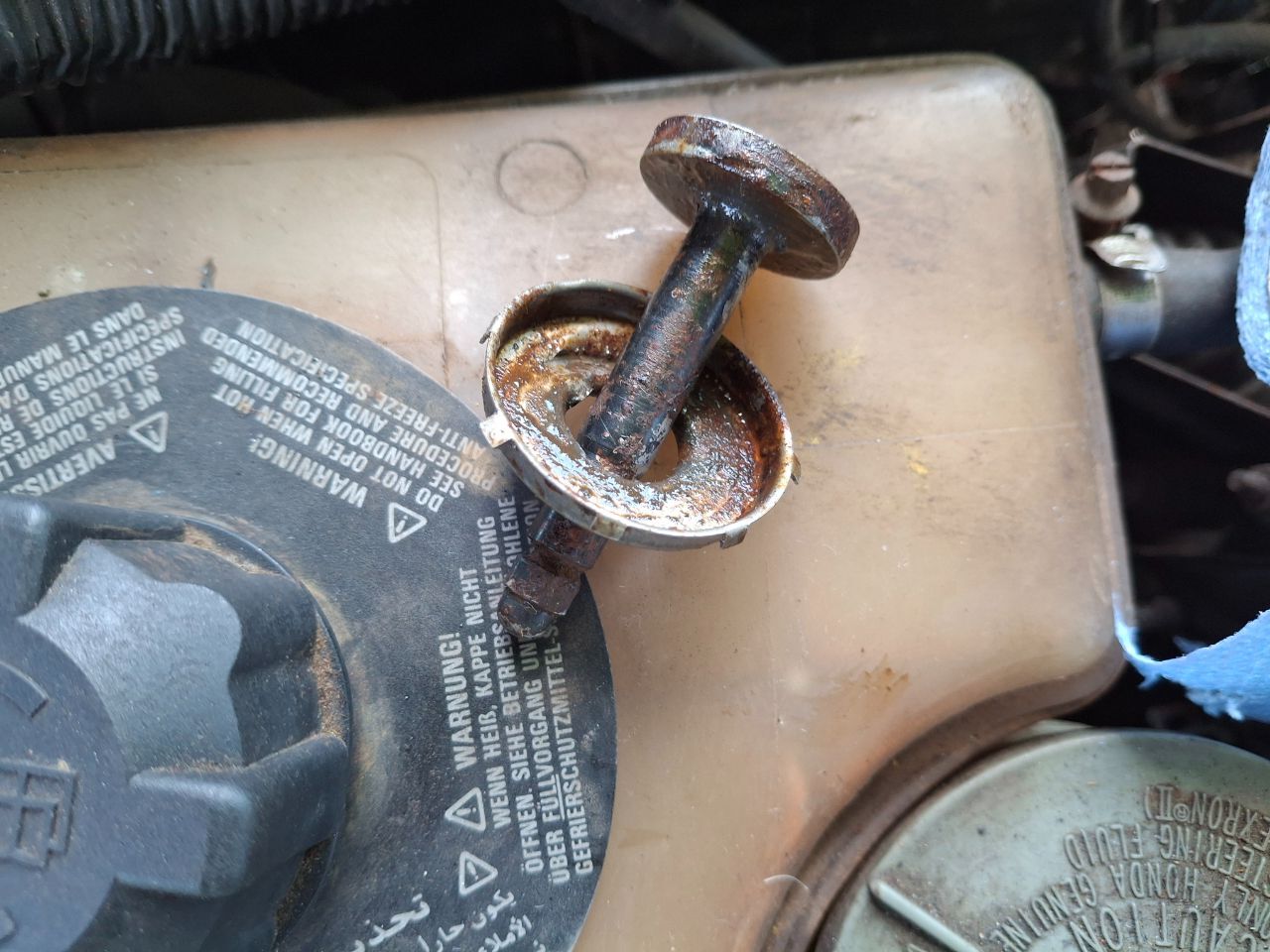

Firstly a weird issue,  a bit like a Subaru, the rear suspension has an excessively long bolt holding the trailing arm to the main bottom arm, unlike the subaru ones these dont rust to the suspension and seize in place but the hex end is pretty small (14mm) and rusts a bit and rounds off making torquing the the thing back up not really possible.....
I did look for a replacement but struggled, its an odd size and not readily available, so I decided to repair the hex end. Cleaned the excess rust off then, added a good dose of weld. Then re shaped it with the finger sander. Not at all straight forward but eventually got to the point were a socket would hold the end effectively and not just slide off under load.
Not a very good picture, you can just see the end on the left which is shiney from were I had to file it back...
I then re fitted it and torqued up.. It worked another job ticked off.

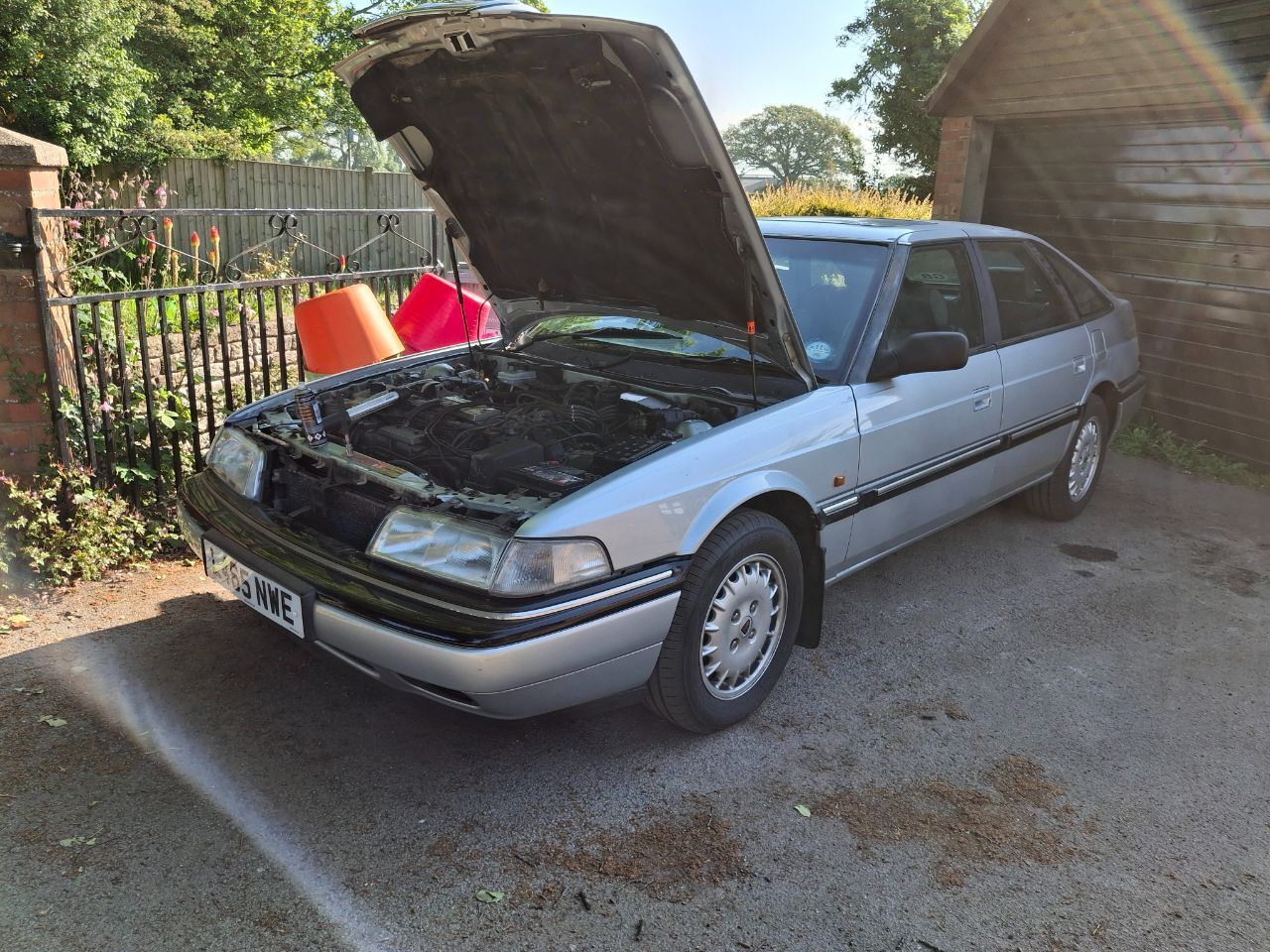

Let it cool off and then re bled the system (it did have a new radiator fitted). This time around it seemed to hold temperature and the tick over was way more consistent, so I am hoping it was just an air lock - still a tad concerning especially as the fans didn't come on?
I have chucked some fuel cans in the Subaru, so tomorrow night I am going to pick up some super unleaded on the way home (the Rover is on fumes) and probably give it another bleed and run up and see if I can maybe spoof the fans into coming on........

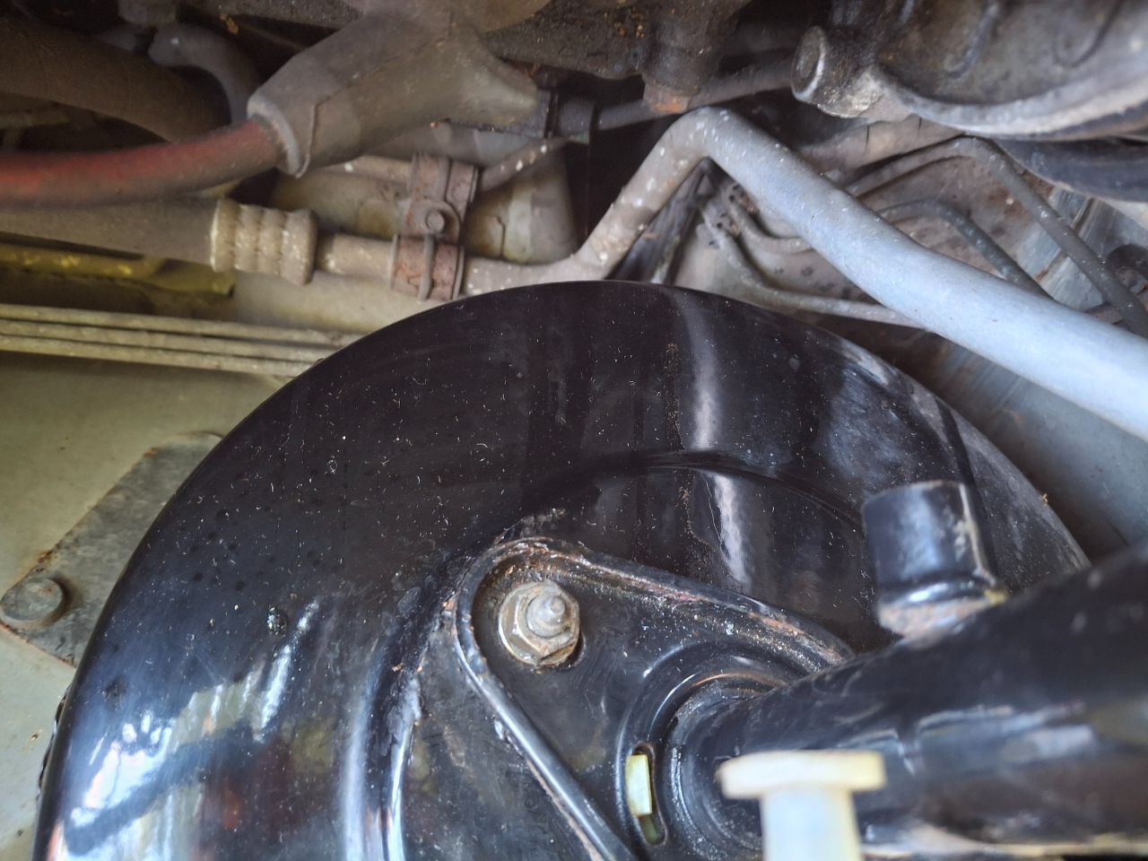

Now the elation of the MOT pass has subsided a bit I have been trying to work through the other minor and major issues... I started on trying to improve the long brake pedal and I have found the issue, the brake servo flexes when you hit the pedal and makes the master cylinder twitch upwards which is pretty odd.
On closer inspection I found I had place washers between the servo and master cylinder, that just seems like a pretty stupid mistake. Sure enough as you hit the brake pedal, the master cylinder pivots on the washers! I racked my brain why the hell had I done this? Anyway, I undid the master cylinder, pulled it out of the servo and removed the washers. Refitted it with the washers now behind the nuts as you would expect.
Now in the correct place....

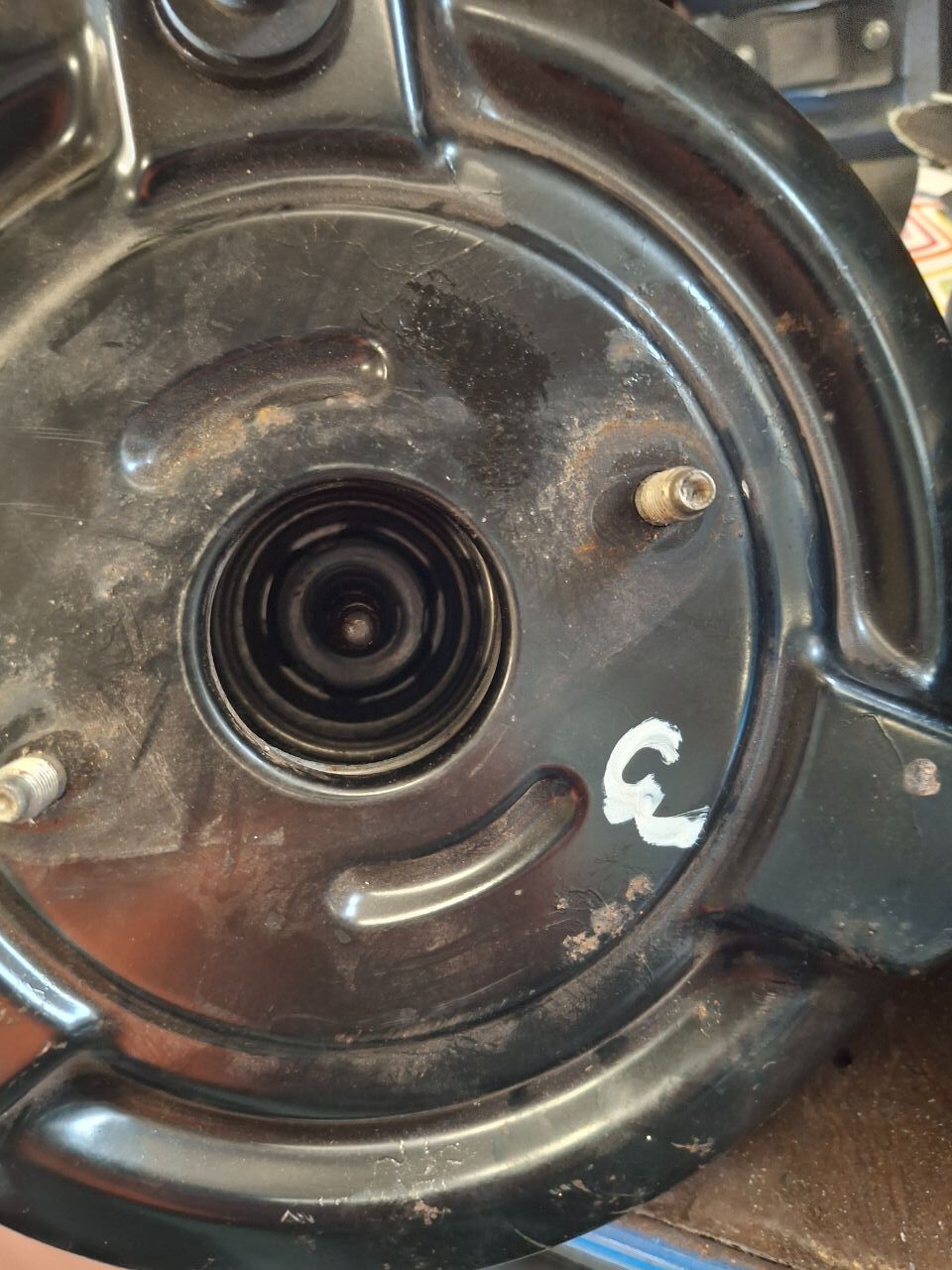

Because I'm a boring git I spent the afternoon taking out the master and servo. I made some discoveries.
Firstly I found the plunger/rod thing that acts on the master cylinder was loose. I compared this to an MGF servo I have lying around (like you do) and found that this shouldn't be the case.
The loose plunger/rod.
Were it should be located....
Compare to an MGF one.... Rod nice and secure.
