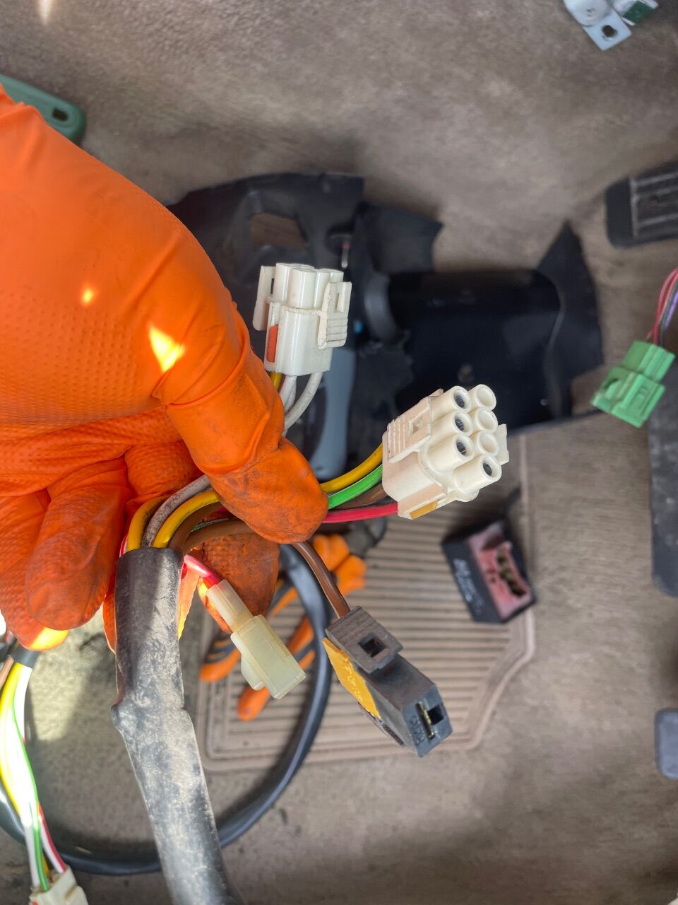

There is some mad fuckery going on with this wiring. Or it’s normal, I don’t know.

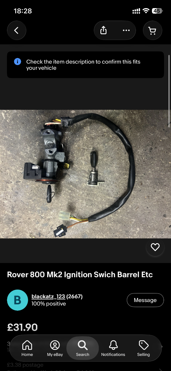

This is the business end of the ignition switch that I bought. Specifically for a Mk1.
This is the listing. Of course, not looking before buying means I spunk £17.99 on a part that doesn’t fit. Because when I go to fit it today, this is what comes off…
A small spade connector (red wire) and another block all go in to the wiring harness of what I have. Well bollocks to this, must be Mk2 I need then as this is a cross over period of vehicle (apparently) so.
But The Mk2 has the same number of connectors as the pre-1991 I bought? So fucked if I know what’s going on although I’m half tempted to desolder the black block switch from the new one I have to the one I’ve got, as the wiring colours match up between the two.
