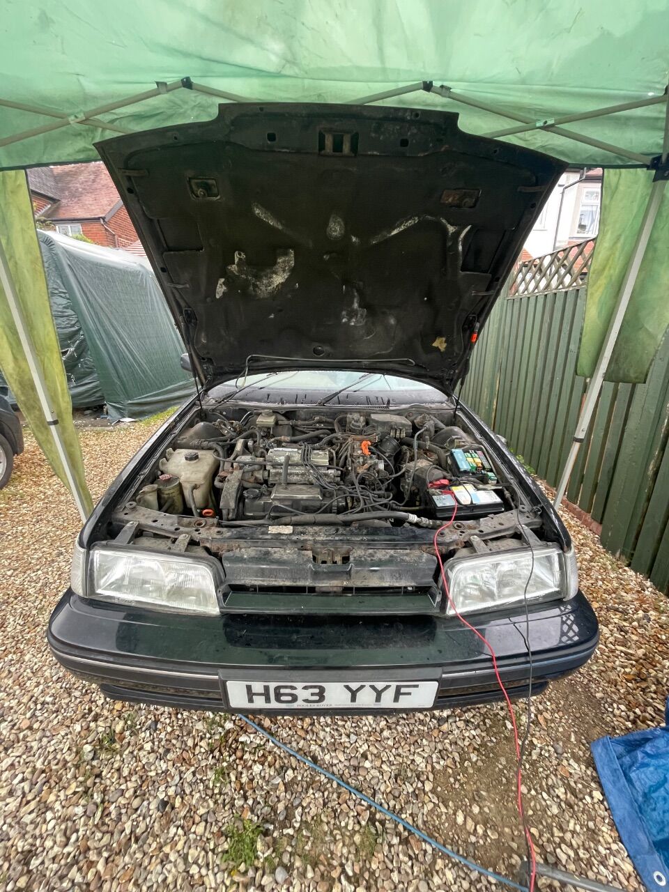

Here is the view:
The new battery has been on charge since Thursday night. New spark plugs (Bosch) replacing the old ones (Bosch). I checked the HT leads and they’re in the right place (just to be sure)
It ran again for 3/4 seconds but gradually petered out. Was too slow to apply throttle, but it’s not started since. Treated it to another 5 litres of BPs finest so that the needle is well above empty. Nothing.
I think next is to inspect the dizzy. Will have to check fuel delivery to each bank as the back plug (well one of them) smelt like petrol but the front 3 were bone dry. All black sooty though.
At this point it has had:
- fuel pipe was leaking due to incorrect banjo fitment. FIXED
- 6 new spark plugs
- new battery
- change of ignition coil (no difference)
- no air intake, straight to throttle body
- new throttle body
- new electronic idle valve
- new master relay
- resoldered master relay
- no EML
- no lights from ECU (PITA to check that)
- resoldered TDC sensor but may have to check that again
Can’t be much left to check?!
