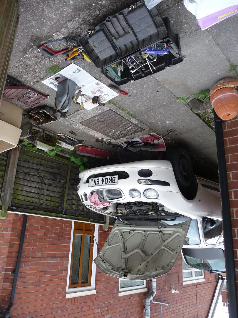

Mr_Bo11ox Posted June 23, 2013 Share Posted June 23, 2013 Yo,I bought this Rover 25 van off eBay a little while back for the bargian price of £325.obviously it came with a free kippered head gasket thrown in. I've never had time do do owt with it since but today i had a couple of hours AND I had had the forethought to bring it up the house so I would not need to set off down the garage!DRIVEWAY SURGERY, i've not done that for a while. I was annoyed cos the weather was so utterly shit today, you spend all week banging away at a computer in an office all week, the weekend comes and it pisses down all day doesnt it, flipping typical. ANyway by about 5 pm it had at least stopped lashing down even if it was still blowing a gale so I got wrapped up and got stuck in.I had a look at the throttle body. its one of these 'restricted' 84ps ones that only opens about 20%. In this case when you opened it loads of coffee cream comes glugging out!!! Nice.Anyway it didnt take that long to get it to bits.I was pleased to see it did not have a MLS gasket fitted, just the 'standard' single layer one with the rubber seal strip round the perimeter, much of which was no longer bonded to the gasket so it seemed a 'genuine' failure that a new gasket would cure. Hang on though whats that?Bloody helll!!! Its only got a hole in the piston hasnt it. I don't know whats caused this as the head looks OK on this pot, no bits of valves missing or owt. The shape of it and the fact that its right in the middle suggests its burned thorugh somehow but i'm not entirely sure how.Anyway I think the cheapest and easiest (and bodgiest) fix is to drop the sump and lob a secondhand piston in so now I am looking for a dead 1.4 bottom end, anyone got any suggestions? Wilko220, Lacquer Peel, HMC and 7 others 10 Link to comment Share on other sites More sharing options...

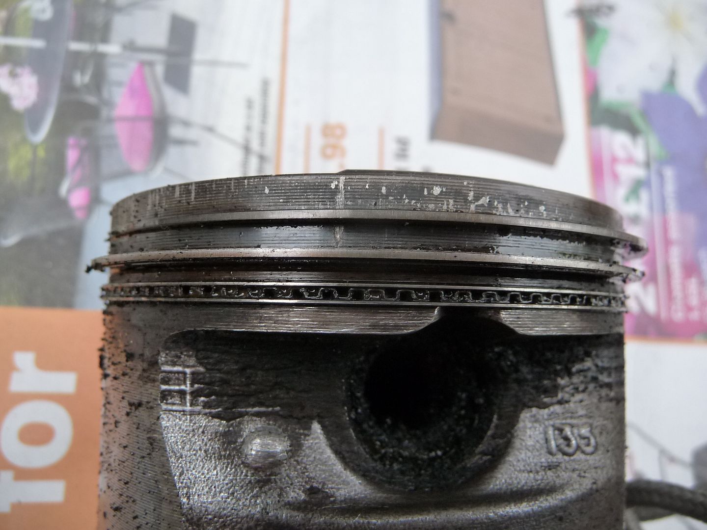

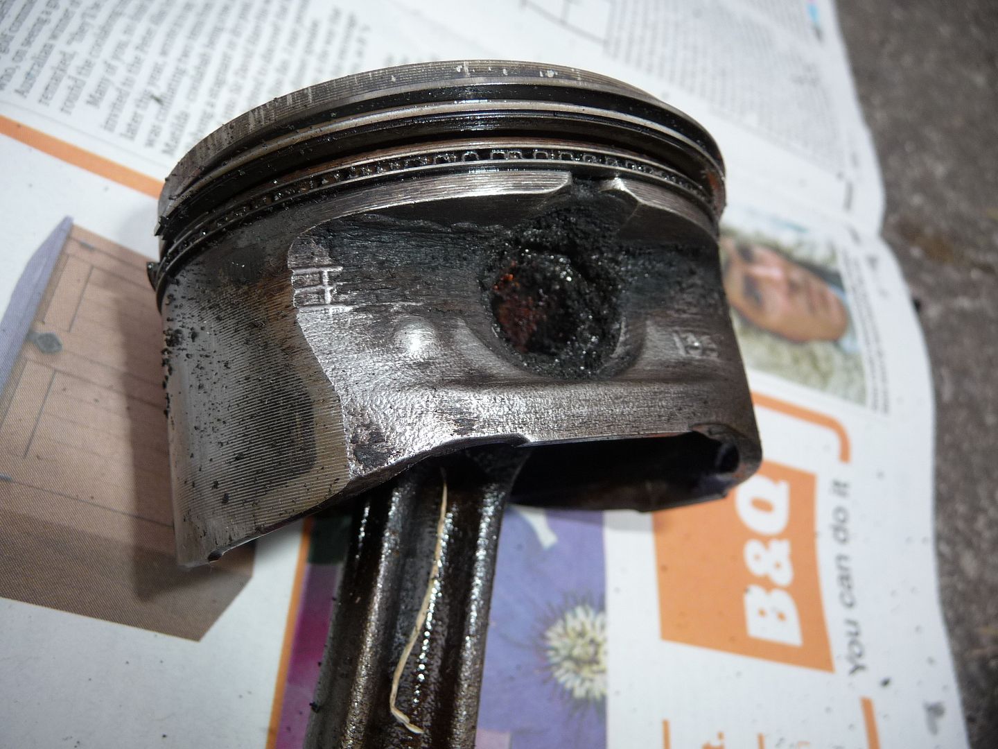

Mr_Bo11ox Posted June 25, 2013 Author Share Posted June 25, 2013 Well I've been back on this tonight. The hope was, get the piston out, get some lad to weld it up, chuck it bck in, cross fingers, turn the key. But: Hmm, that doesnt look too healthy. After a bit of a war the piston came out: Well coked! Its picked up a bit on one side too, plus the top ring is slightly jammed round part of its circumference: Hmm! I think on reflection trying to fix this might be a bit 'flogging a dead horse'. I could find a new piston and liner but TBH a secondhand motor feels like a better option: So now I have to find another motor, tug this back down to the garage and get the engine hoist out. BOLLOCKS!! Coprolalia 1 Link to comment Share on other sites More sharing options...
cort16 Posted June 25, 2013 Share Posted June 25, 2013 I wonder how easy it is to get a decent engine for one of these as most of them are in the scrappies because of knackered hgf? I guess a decent bottom end would do ? Link to comment Share on other sites More sharing options...
