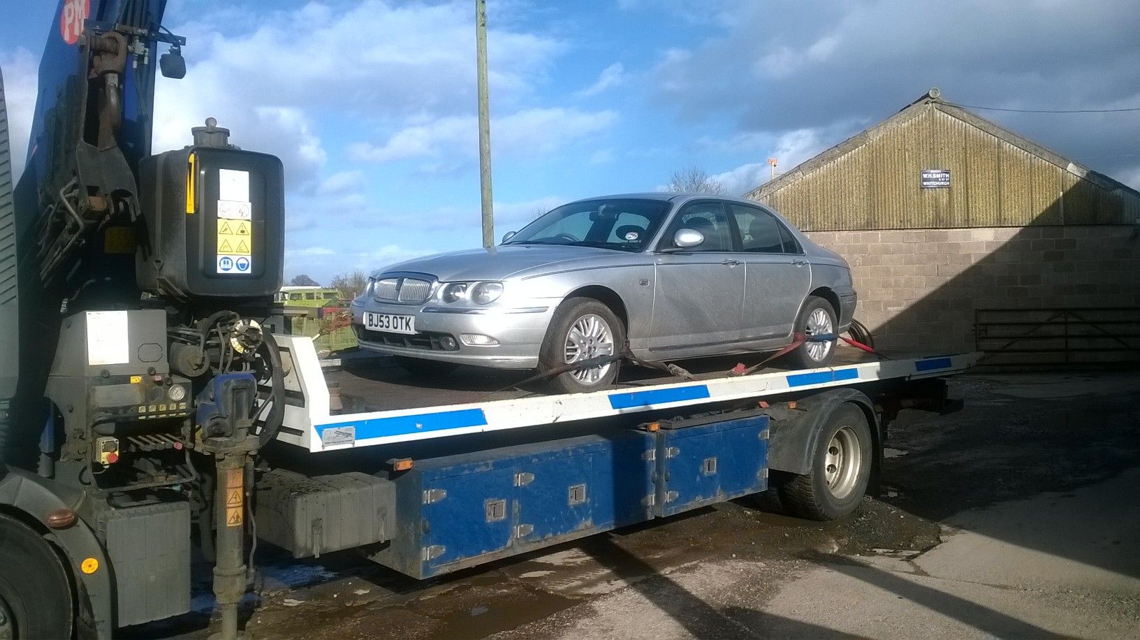

Mr_Bo11ox Posted February 23, 2015 Author Share Posted February 23, 2015 Well just shy of 5 hours after calling the RAC I got moving on the back of a lorry. I was allowed 50 miles of recovery, but I wanted to go to my workshop which typically was 55 miles away. I attempted to bribe the recovery driver but he said there was no need tobribe him, he'd happily hake me a few more miles if I paid the mileage, to which i agreed. Got up to the unit about 2.45:   The extra mileage cost £7.80!!!! cheaper than a taxi! The day was a flippin write-off by now so I rang work and they agreed to give up on it and I would put it down as a days holiday. So I decided to investigate the problem. I pulled it into the garage and took the RH driveshaft out:  The problem is that the driveshaft had simply come out of the gearbox. Its supposed to be held in place by the bearing on the left of this pic (its on the left cos I have drifted it down the driveshaft away from its proper location which is the shiny bit of the shaft). The bearing is circlipped into the housing so that can't move and is a fairly tight interference fit on the shaft. Obv theres not much axial load on the shaft so it doesnt have to be held mega firm like a wheel bearing or whatever. I inspected everything but I couldnt find a good reason why the driveshaft would move outwards and disengage itself from the gearbox. I did find the bearing was quite 'gritty' which is not good, it didn't turn super smoothly admittedly although it wasnt locked up or full of slop. I worked a load of spray grease into it which seemed to help a little. The inner race of the bearing was still a good tight fit on the shaft so that didnt seem like a problem. I like Tims idea of a dab of weld to hold the bearing onto the shaft, but annoyingly the housing for the bearing has a hole in it only about 2-3mm bigger than the shaft diameter so theres no access to get in with the welder so that was out. Looking at the Rimmer catalogue you can't buy the bearing alone. there isnt an easy way to get it out of its housing and the shaft itself has a collar on at the diff end which prevents you from getting the bearing or the housing off. So if you ever need to replace the bearing you have to buy a whole middle drive shaft!!! brilliant design that you Brummie bastards. NB the whole middle driveshaft is of course NLA. I couldnt see a lot wrong with it all so i put it back together with some loctite retaining gloop to hopefully help hold the bearing onto the shaft. The bearing was a bit smoother so I thought it would be OK and I would just keep an eye on it. I drove it up the road a mile or two and came back and had a look and it had already worked itself 5 or 6mm out from where it was when i set off. What an absolute SHITE. I really can't see a good reason why the shaft would come out so the only conclusion i can make is that the gritty bearing is making it happen. Presumably wheh it gets a bit of speed up, the vibration profile resulting from the gritty feel encourages the shaft to shoggle itself axially in the 'out of the gearbox' direction. So I need to sort a new bearing or middle driveshaft somehow and see if that solves the issue. It might, but then again the reason why its doing it isnt mega obvious so maybe I have misunderstood something and it wont. Unfortunatley I can't accept problems like this on a daily driver so at this point I gave up and swapped the insurance back onto the Primera. The 75 is now off the road again and is unlikely to go back on again in my stewardship!!! I am going to fix the problem and move it on. While i had it to bits I managed to get a number off the bearing so I am going to go to the bearing shop in Derby and see if they can sell me a replacement. I think with some assistance from blowtorches, ovens etc I could probably get it all to bits without wrecking the shaft or the housing and fit a new bearing in the housing. If they can't i'll get a SH driveshaft and fit that complete. It might take a little while but thats OK now i am not relying on the car. scruff, Coprolalia and UltraWomble 3 Link to comment Share on other sites More sharing options...
