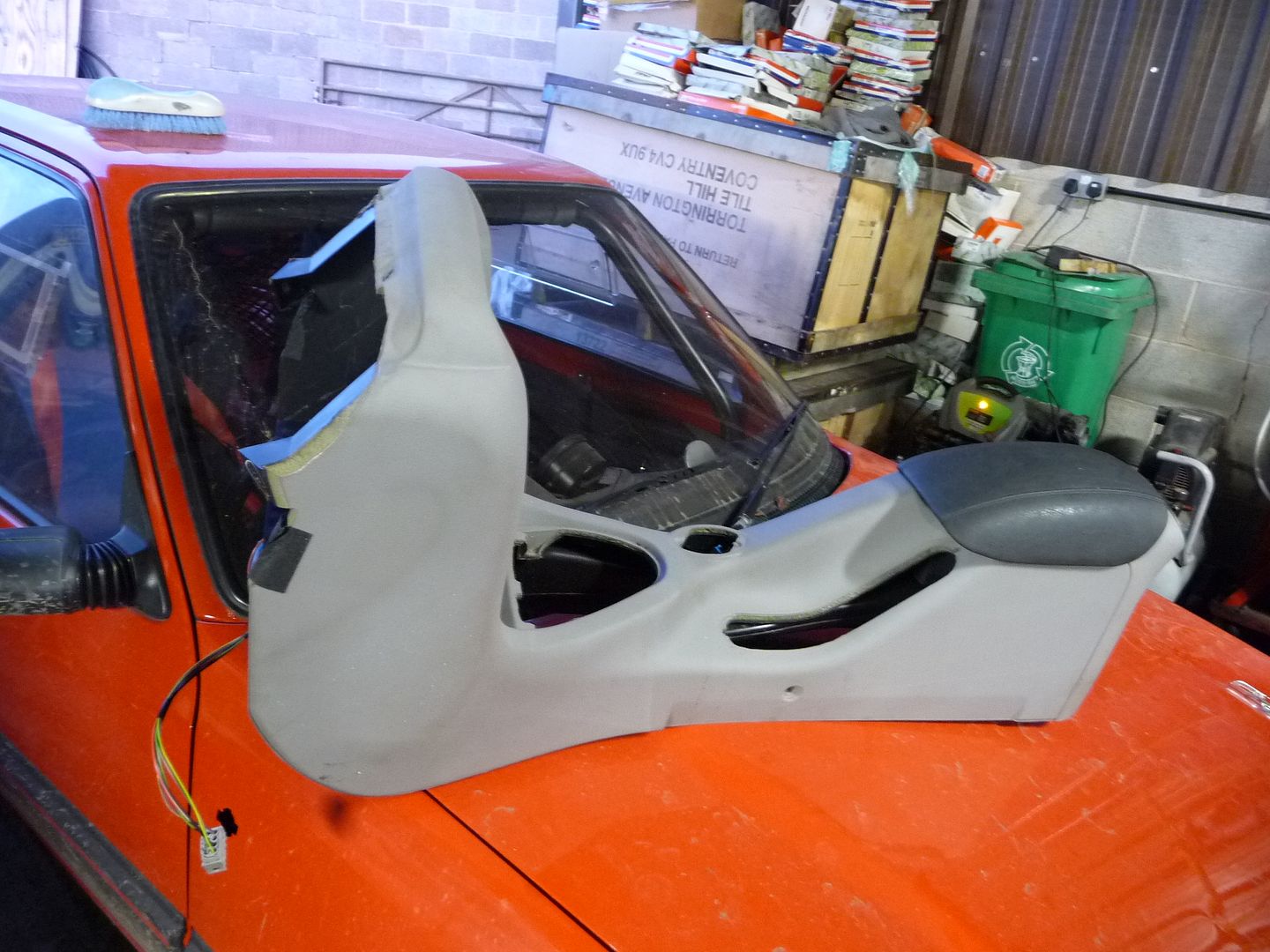

Mr_Bo11ox Posted November 30, 2014 Author Posted November 30, 2014 YO!!! Been on the Rover a lot this weekend (sounds like a euphemism but isnt) Last week it was up and running but I was shitting myself that it was gonna freeze and pop my newly fixed-up 1800 K series. I was not shitting myself enough to go up the garage and drain the water out though. Well i am pleased to report that no damage has been done. This weekend I flushed the cooling system out twice with an Aldi biological washing powder tablet each time after which I filled it up with OAT coolant (admittedly a little weaker than I would have liked, but I ran out) which seems to have done the biz. Oh yeah I washed the expansion bottle out with thinners again. Now it seems to be 99.5% oil free although the heater is still a bit shit which is annoying. So this weekend i ah been mainly de-snagging: if you recall, some fudge-walloper had helpfully sawn off the bonnet safety catch. Well I made a new one out of a bit of threaded bar and welded it on Also got a new striker plate thingy to replace the missing one, got that from McGuinnesses in Stoke for the excellent price of £0 although I had to spend £15 on a battery for the 25GTi to be allowed it at such a preferential rate. My bonnet woes weren't over though as I discovered the root cause of all this bodgery - a seized-up LH secondary bonnet cable. I tried to free it off and pulled the end off it like Desperate Dan. Looked it up on Rimming Brothers website when I got home - £27!!!! fuck that, I need to have a better idea than spend that kind of money on a flipping glorified bicycle brake cab..... hmm thats an idea. Ah well the bonnet can't fly up in my face any more so I will get this sorted in due course. Need to have a fully working bonnet cable though, thats hardly too much to ask is it FFS Next I found someone flogging a get of genuine locking nutz on the bay for TEN POOND so i had them: To my surprise the key fitted the two remaining nuts on my car so I didnt have to butcher them!!! Result, now I have two ignition keys and the LWN key as well!!! Now I can take the wheels off and on as many times as I like. Next, GSF car parts were having a 35% off special offer so I splashed 15 Sterling (see what I did there?) on a new cambelt: I am a flippin whiz on these K's now, took about half an hour to fit and didnt bend any valves. Lovely!!! Oh those pics are n the wrong order. Chucked all the covers on and the wheelarch liner back in as well, need to get a few new clips for that though, not from the Rimmers mind as they charge about £12/side for a handful of wanky clips Next I started to pull the interior to bits as the stench was just too much. Took ages to get it all out as there are about 1,000,000 clips holding everything. I won in the end though: Nice to see a big flipping dint in the floor that had cracked all the soundproofing off leaving a load of bare metal!!! Suppose I will hammer that out and paint it with summert. The carpet in these is a hell of thing. Its got an integral foam rubber backing (presumably for soundproofing) thats anything up to like 1.5" thick!!! It weighs a flippin ton and getting it out of the car is a right war. Anyway I did get it out in the end but by this point after wrestling the seats out I was bloody knackered so went home. Came back today though, I had an idea about thaking the interior up to my mate who has a bees knees upholstery cleaner, but in the end he wasnt available so i drafted in some help from SCOTTISH POWER: Then I just spent ages blasting it with a hosepipe and scrubbing it with a stiff brush. Also found some wank 'WILKO upholstery cleaner' that was so rubbish it could hardly get itself out of the aerosol can, but I used a load of it anyway, dont know if it did owt. Spent about 45 mins hosing and scrubbing: Think it did an OK job to be fair. Loads of minging water came running out of it. left it hangin up to dry. While the interior was out I had a look at the handbrake compensator which I has read on the ZT forum was made of monkey metal and bends over time. Mine was starting to go: Not sure if it makes any difference to owt or not but I bent it back and welded a reinforcer on: The handbrake is a bit shit on this Rover, I think the rear brakes must need attention (certainly the front pads need replacing) but I can eliminate this little thing from my enquiries when faffing with the brakes next time. I wanted to start putting the interior back together, but the foam backing on the carpet soaked a load of water up and that is gonna take an age to dry, specially in the cold damp winter weather. SO I laid the carpet out on the bonnet of the Maser and left it to dry for a few days. Looking forward to putting it back in though as that is gonna smarten the job up a lot. Also gave the revolting centre console a scrub: Not mint but 100x better which is good enough for me. Next I want to clean the seats but I'm not sure what to do. I havent got a wetvac or upholstery cleaner. Havent even got hot water up the garage. My landlady has a steam cleaner which she says I can use but are those things any good? I cant see how blasting a bit of steam on is going to do a lot. Although it might kill whatever bugs are making the foul smell i suppose. The seats are out the car so I could cart them up to my mates house but I doubt I'll have time in the next couple of weeks so I dont know about that. Basically I dont know. Jobs left to do: New front pads, investigate the shit handbrake, clean the seats and refit the interior, polish the scratches out the windscreen, fix the slow puncture (which is in a rubbish tyre on a wheel thats badly kerbed and slightly burned by my efforts to get the locking wheelnut out, so I might be better off just getting a whole wheel if I can find a cheap one) and attack the outside with the polishing mop. I think I am gonna put this on the road for a while once its ready cos I thnk by the time i get it MOT'd it will be a fairly well-sorted example, even if it is a shit 1.8 NA version. Then NO MORE ROVERS!!! Louise2cv, skattrd, Bucketeer and 16 others 19

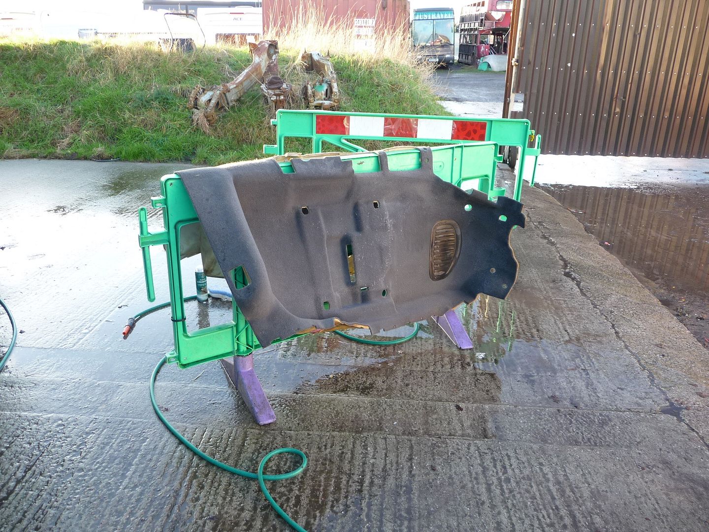

Mr_Bo11ox Posted November 30, 2014 Author Posted November 30, 2014 I did wetvac the carpets after hsoing em and the top side is pretty dry but the foam on the bottom is wringing wet and is gonna take yonks to dry out. I think I might have a crack with the steam cleaner, seemingly you dont use any cleaning products just give it a good blast with the steamer and then a rub with a cloth?
beko1987 Posted November 30, 2014 Posted November 30, 2014 Pretty much. I find blasting the nozzle of mine directly on the stain so its touching gets rid of it. Never used it on beige fabric though...
Bren Posted November 30, 2014 Posted November 30, 2014 You can use a pressure washer but you need a hot day or your upholstery will never dry.
