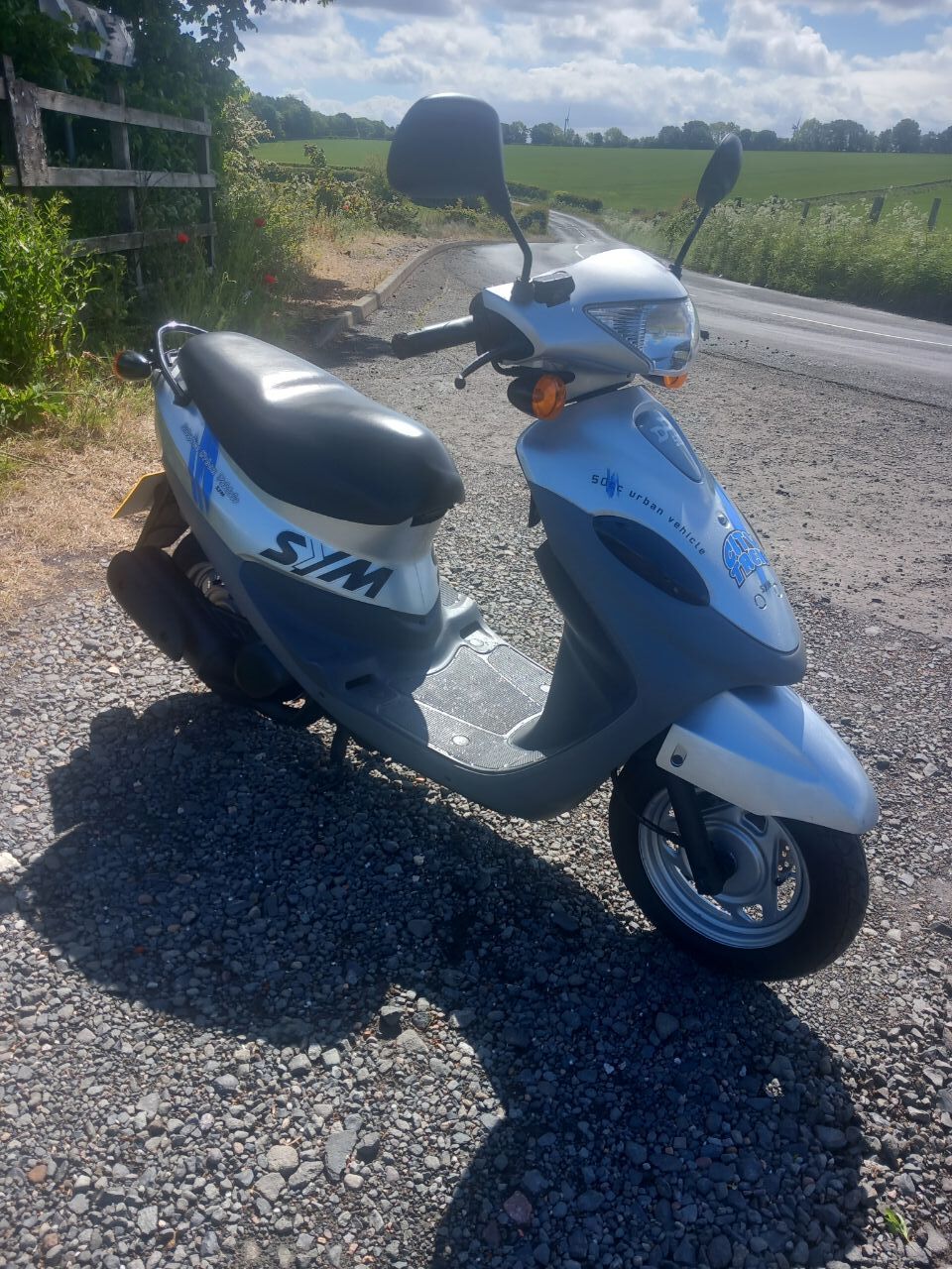

Just sold this wee thing. Bought it as a non runner project, it had done 1200 miles and has never been motd.. ridden for a year then dry stored. Insurance was 80% of my Tiger 1050!
I got 38mph out of it and I was giggling my head off 😆. Most fun I've had on 2 wheels in ages..  until I went on the big roads.

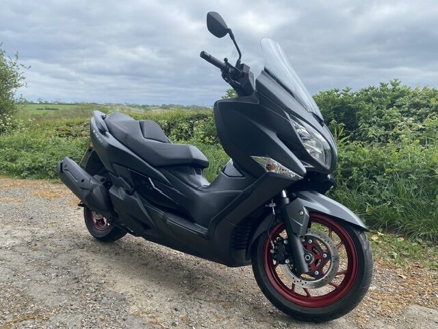

And it’s hello Burgman 400
First impressions are it’s happy to cruise up to 60-65mph and gets a bit vibratey after that. Suits me as I got it for something to chill out and cruise around on.
Front brakes feel wooden and need a good pull (don’t we all?) but rear is demon. Breathe on the rear lever and ABS kicks in.
Will have a proper look if the front sliders are still sliding and threaten it with some fresh fluid.
Overall pretty happy - insurance even came down from £100 to £80. Go figure.

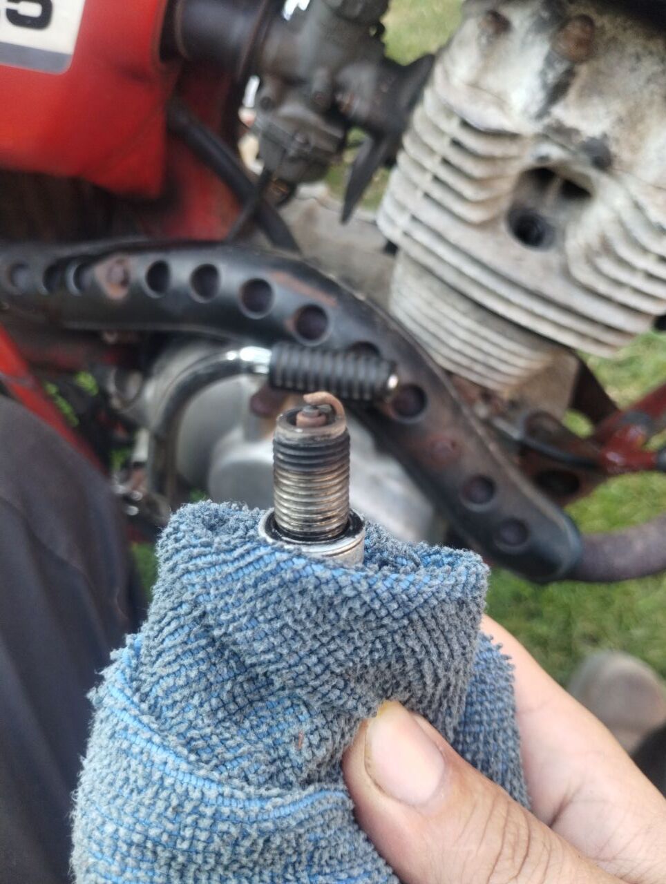

Just been out for a bimble blast on the CT125. Almost FTP'd but managed to nurse it home again. Seemed to develop a misfire, initially at full throttle but by the time I got home it was barely rideable.
I'm fairly sure it's unrelated to my recent attempt at a clutch change. I think it's just become apparent because previously I wasn't able to give it full throttle.
What does everyone reckon to this plug?
Looks very haynes manual brown to me but apparently I am colour blind when it comes to paint and furniture.
Brown = ok?
Brown good
I was really disappointed when Haynes stopped putting that into the manuals
I'm thinking it's fuel related rather than ignition.
I don't think it's the spark deteriorating under heat/load because if I dipped the clutch it idled nicely.
I'll see whether the issue is the same from cold today. If it is I suspect the main jet could be blocked.

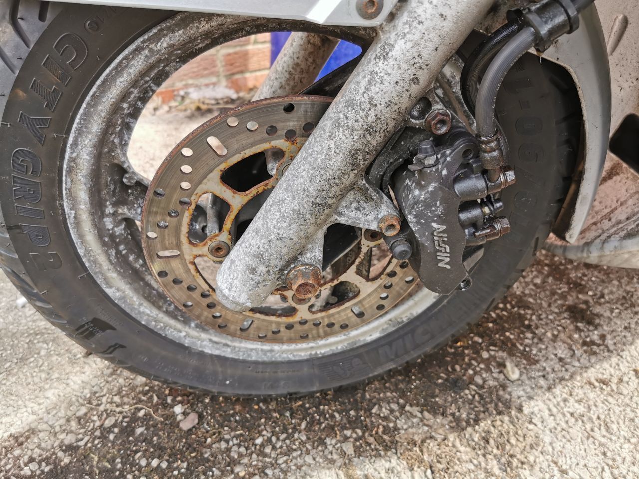

Further to this I reckon I've got my heart set on a Dragster but I'm not finding much at the moment that isn't a mint/modded 125 for £££.
Did find this though, should I buy or should I buy?
https://www.facebook.com/marketplace/item/10018539134931690/
Me, earlier
Mario Kart 8 Deluxe - Flower Cup 200cc (Donkey Kong Gameplay)
Looks like it's too much hassle for the money, IMHO. I'd be willing to bet you'd find a running one for the same money, or very little more.
