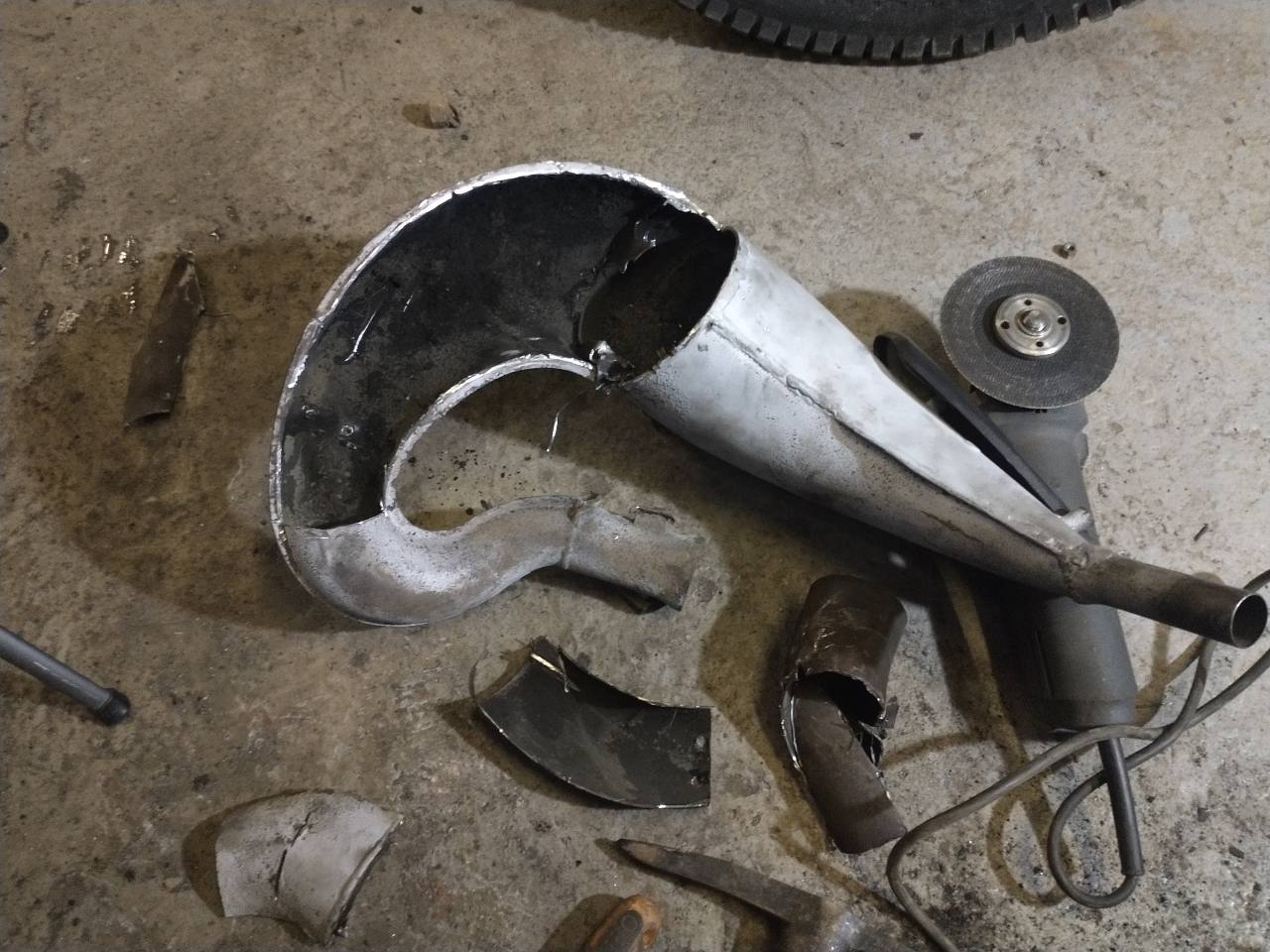

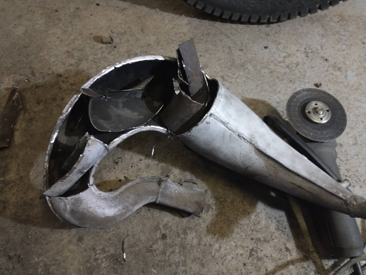

I spent yesterday cutting open the aprilias exhaust and removing the rest of the shite restricting it.
Today I welded it back together and fitted it and what a difference, I took it out for a quick blast in the rain and it really flies.
Worth doing a plug chop now - might be running lean now it’s been de restricted

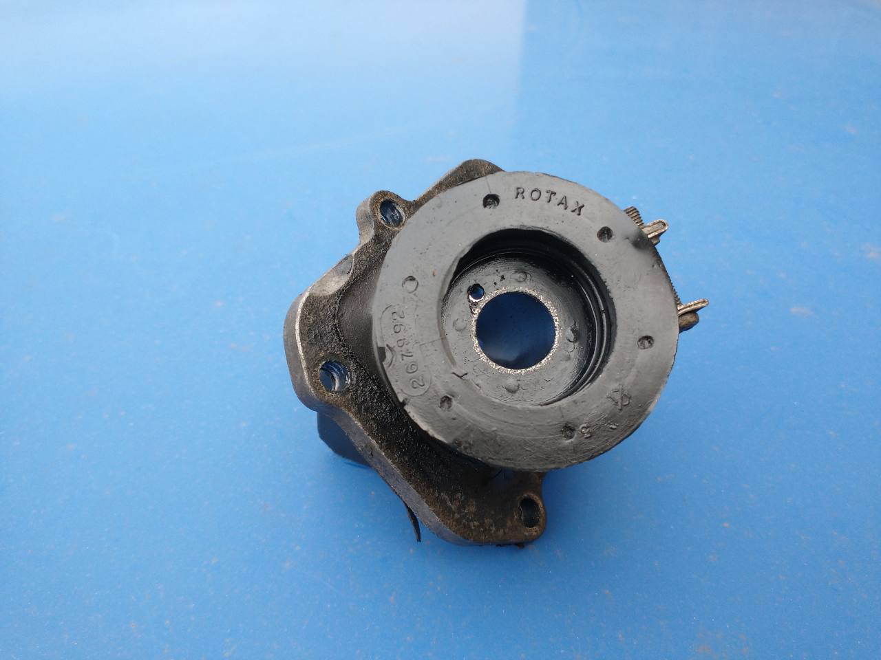

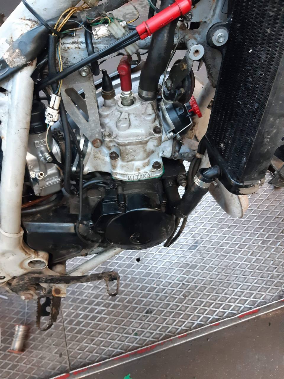

It's been more than de-restricted, it's had the carb upgraded from 28mm to 34mm, the barrel and piston changed to a Mitaka big bore, a rave 2 pneumatic powervalve.
The original barrel didn't have a slot for a powervalve to be fitted so I bought all of the bits required to upgrade it and took it to my local and many years experienced bike mechanic to do the work.
After he swapped everything over he said he was expecting it to be faster but felt that there might still be something in the exhaust restricting it, I mentioned I'd previously had it opened when removing the cat and there was a smaller diameter tube inside it.
At the time I'd tried looking up what the inside of a 2 stroke exhaust should look like but couldn't find the answer so left the smaller pipe inside. The internal pipe went from the start of the exhaust and tapered out and ended in the middle and the cat was fitted from the middle towards the other end.
Anyway the mechanic recommended removing the inner pipe too.
I'd read that a cooler plug was required for the big bore head but the mechanic recommended I use the original plug to run it in then swap to a cooler one as it would probably foul it if I swapped straight away.
The jetting on the carb  was set as standard for a full power de-restricted RS 125 so should be fine for my setup.
There were a few things restricting the engine including the inlet manifold which had a tiny washer jammed inside it, the exhaust which I mentioned, the CDI unit had an emissions limiter which needed modified to remove a flat spot in the rev range and the barrel didn't have a slot for the powervalve.
Any recommendations for running in a 2 stroke after having a new barrel and piston fitted?
For running in just use the engine normally, don't labour it in high gears or sit at a constant speed and avoid using more than 2/3rds of the rev range for the first 500 miles, use the best quality 2T oil you can buy, also let it warm up before riding it, by gradually blipping it until the water temp gauge starts to move off its stop, a cold seizure is about the worst thing you can have happen on a 2T.
You need to heat cycle the rings . Two or 3 10 minute rides and let it fully cool after each one . Then beat the piss out of it
