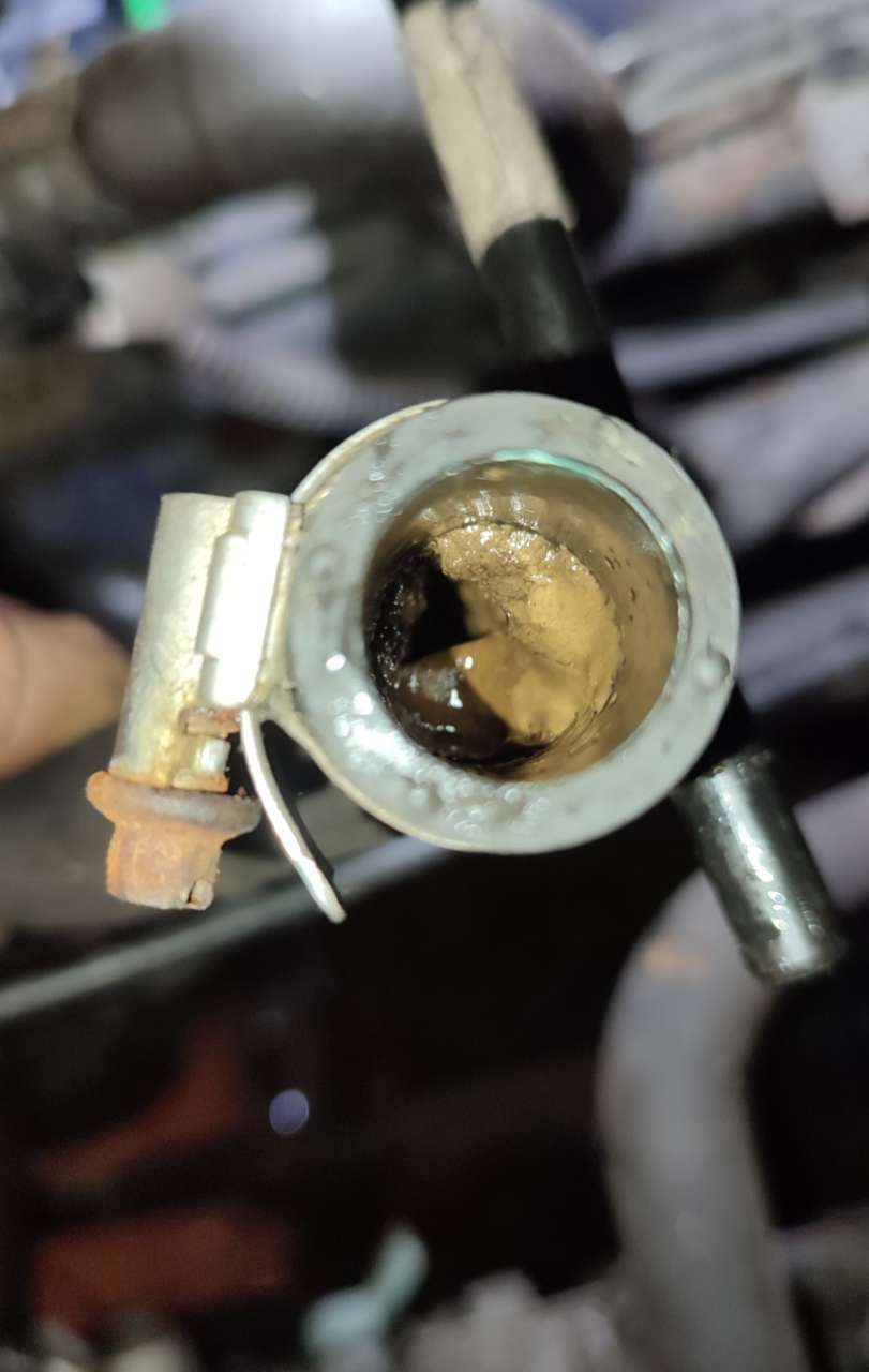

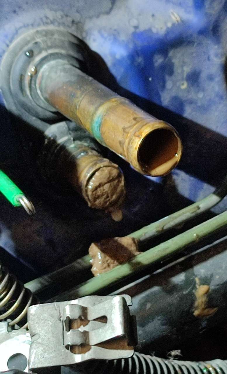

Someone had used it in my Volvo many years ago for something. When I got the car it wasn’t leaking and hasn’t since so it obviously worked but it also blocked the heater matrix solid. Absolutely no heating whatsoever.
Only way I managed to sort it was stripping as many hoses as possible off the cooling system and constantly flush and back flushing the block, radiator, hoses and heater. The heater must have been packed absolutely solid as even rigging up a big long hose directly into it from the outside tap on the house struggled to clear the blockage!
In the end I had to just let it pressurise as much as possible from the tap which did eventually blow a mass of coppery rubbery greasy crud out of the heater!
It was flowing that stuff out of everywhere for ages though when I flushed it. Since then the cars had two coolant changes and yet there’s still tiny traces of the coppery rubbery shite in the system.
