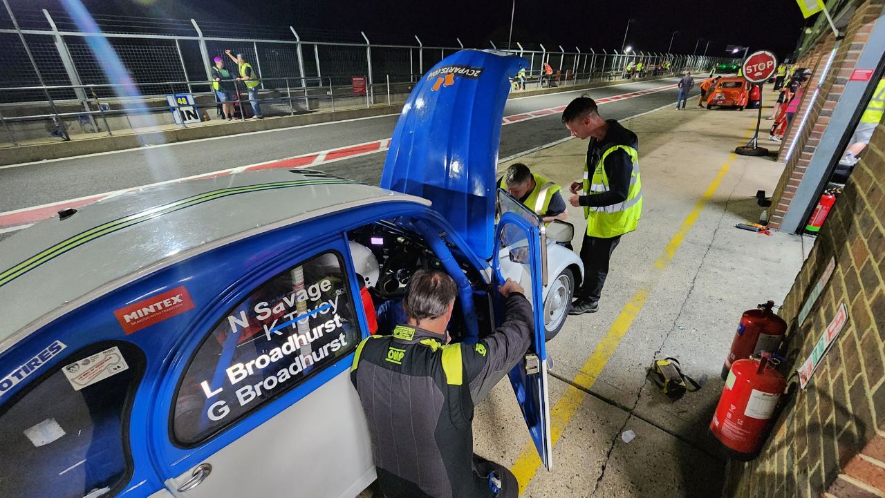

It's going well

54 laps in, running a strong 5th in class.  George is knocking out consistent 1:51 laps.
We're now THIRD!
They're very hot on track-limits violations this year. George has had a black/white flag warning and I was called to Race Control.  Words of advice were issued!
  • Like 6
Same as the last two years: Laurence Broadhurst (car owner/builder), his son George, and 2013 winner Neil Savage.
100 laps down and we're back in 5th, following a couple of apparent issues with oil consumption.  Topped up, out circulating again.
The mech types have listened to the engine as it went past the pit wall, and have called it good.  We are 4th.

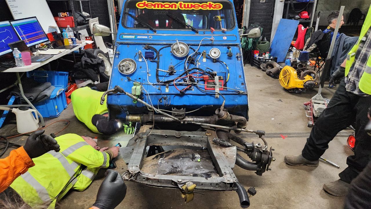

By way of an update.  The chassis is absolute toast.  It appears there was a "racing incident" at the exit of turn 1, and car 48 came off worst.  Heavy impact on the offside chassis rail has not only twisted and parallelogramed the chassis ahead of the steering rack/front axle tube, but it has also pushed the offside chassis rail back by about 30mm.  The steering column has been punched back towards the driver, and there is a huge bend in the top chassis panel behind the front axle.
Whilst yes, it is possible to bend anything straight again, this would require the body off to do so properly,  and it was determined to be absolutely not viable here.
It needs an replacement chassis.  This one is a used crisp packet.
