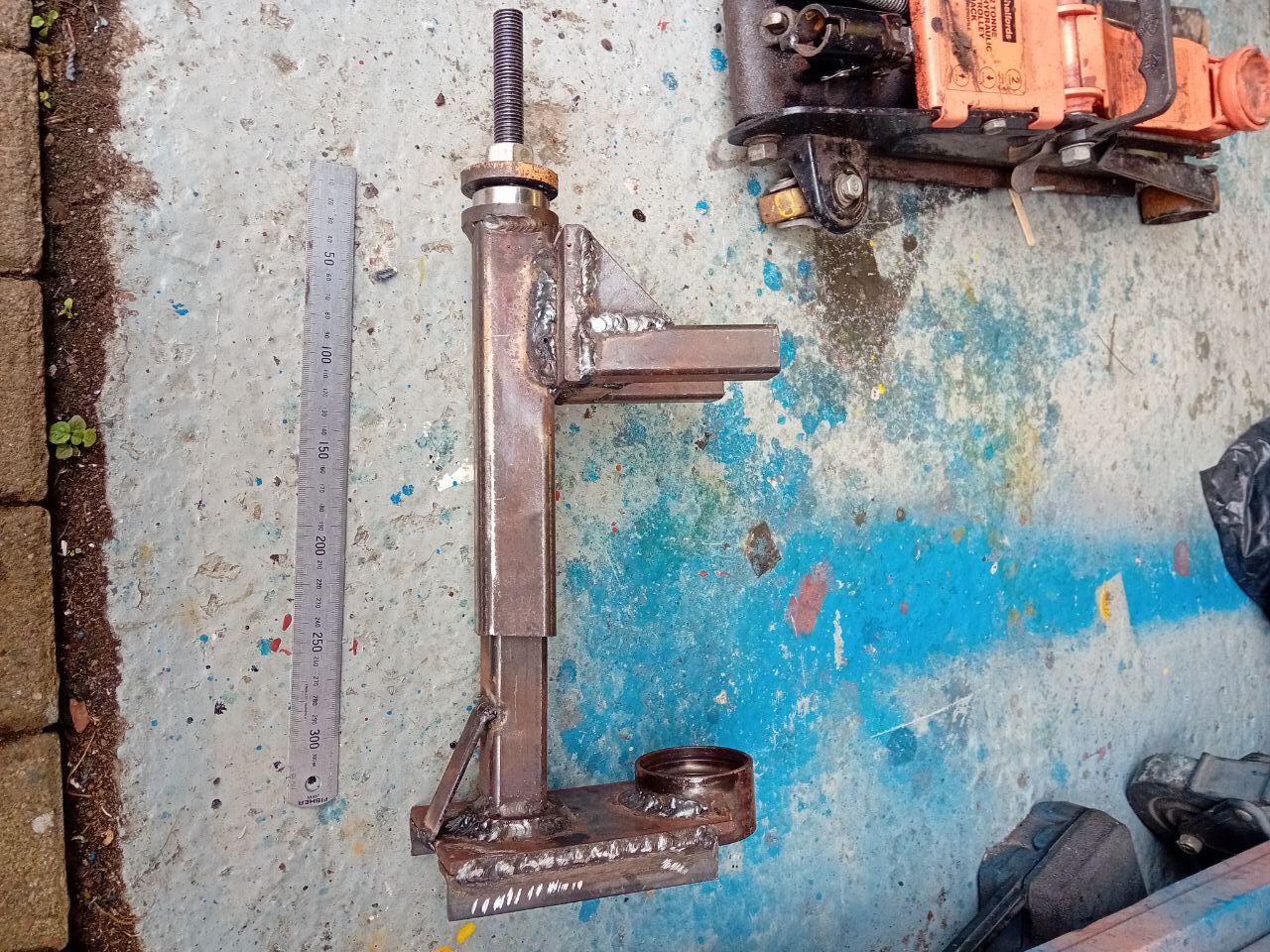

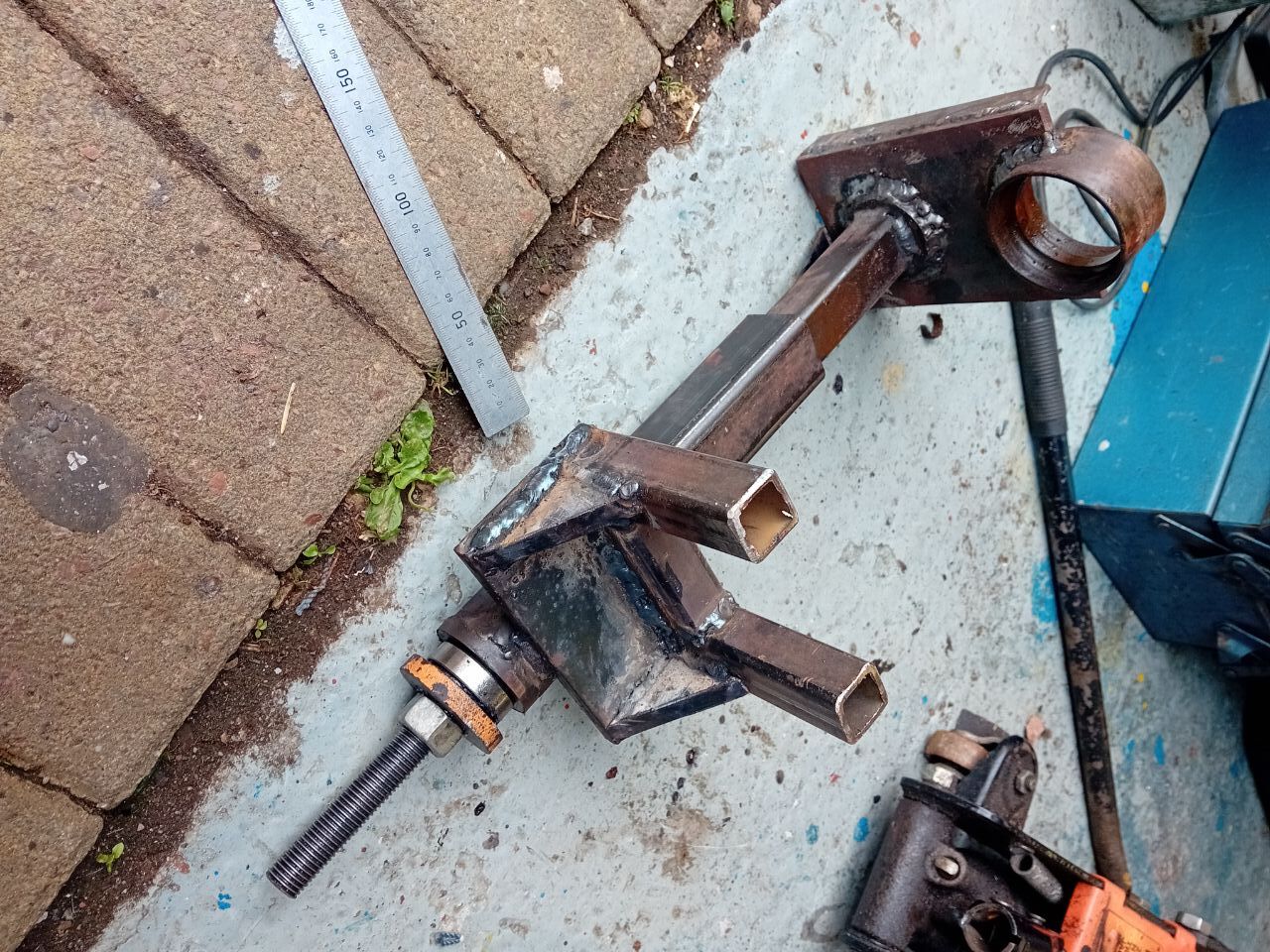

I replaced the rear suspension bearings today.  I made this spring compressor out of  40mm, 30mm and 25mm box section and a length of 16mm screwed bar and an old tapered bearing. It worked a treat even with my shitety welding. If anyone  wants a loan of it or dimensions to make their own let us know.20250625_161819.jpg.53d80974943877060a269ad475e07284.jpg20250625_161709.jpg.6e47460369298039900b000606be2103.jpg

Ingenious! Mine will want doing and some point so might well take you up on the offer.

Cheers Doug, that looks sound, the only issue is that we are quite a way from each other.

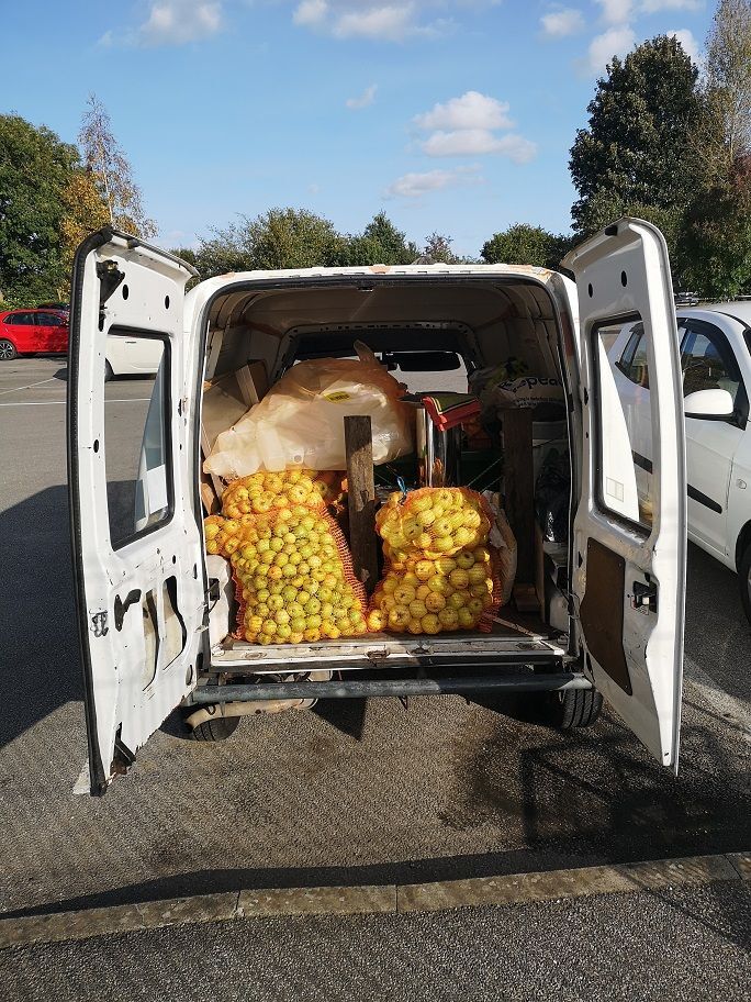

It's getting to that time of year when a C15 is needed to collect the harvest...
... and transport it and the cider press to my orchard group's Autumn Apple Day events...
Accordingly, Van de Pomme has been woken from slumber, taxed and washed.

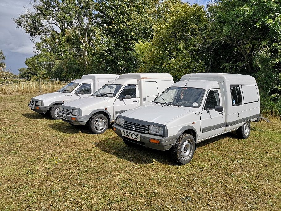

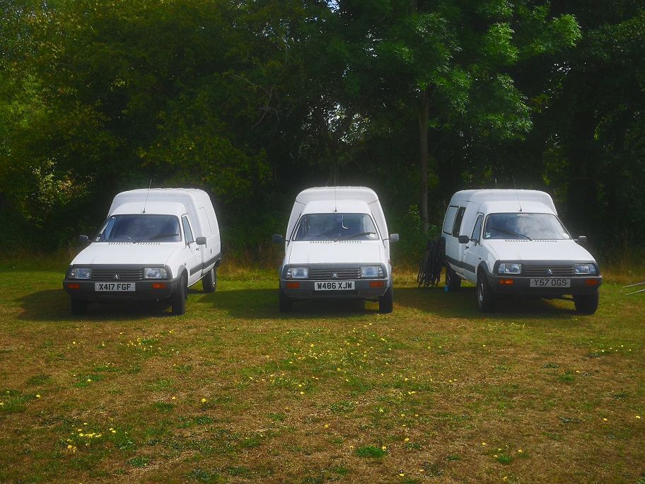

There were three C15s at the Chevrons Rally yesterday. One (RHS of photo) was a French long wheelbase version, with rear seats. It lives in Scotland and came down for the occasion.
The other two, including mine,  (centre) were the now-rare 'Club' editions. These had nicer seats than standard, with much more padding, full headrests and pleasant, 'chevron' patterned tweedcloth covers. They had matching external decals and interior trim too.
The LWB van sports its original French number plate alongside the UK version. My UK van has the bonus 'Van Damme' decal instead...
Three white C15s in a row made it look like a day out for a motor parts supplier!

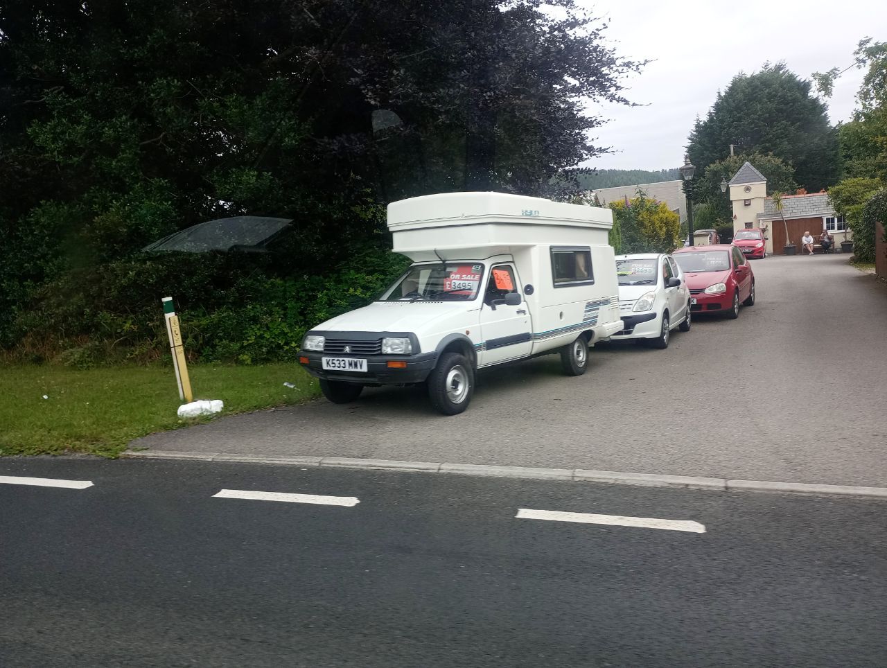

I also devote an inordinate amount of my time to pondering the mental state of people that own and use C15 Romahomes. Am I supposed to hug them or run?
