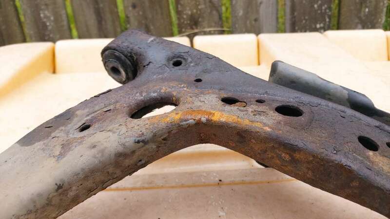

After witnessing T'other Ryan work on his over the years. He gave his front subframe a fair wallop and it was fine after a replacement one was fitted. Even the console bushes weren't much hassle to remove and install poly replacements.
Like you say, the bottom arm is designed as the weakest point to protect the subframe in the event of an impact. It's entirely possible for the knuckle itself to deform, and of course the shock. But the damages are usually isolated to any combination out of those 3 components. Usually..
Like I said earlier Ryan it'll need a bottom arm (they are disposable on Fabias anyway) and at a push tie rod. I'd suggest replacing the track rod end & ball joint as they are almost service items on these things as well and they are cheap.
The alloy consoles the bottom arms bolt into rarely bend, although I have seen a broken one but that was in a big shunt.
A few hours work if you've got the bits round you. As you have PSB console bushes that'll make it even easier and I'd go for a pair of bottom arms if you are replacing one side and poly bushes.
No where near a big enough bump to bend anything chassis or subframe wise. Tough old bastards these are.

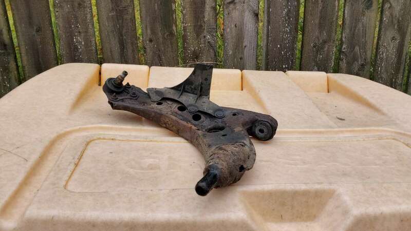

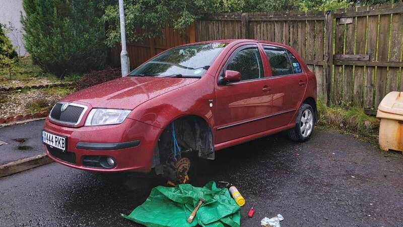

So, a further update on my stupidity. The car was returned on Saturday morning, with me being at work, my Granda cracked on with disassembly. So far I've assessed and ordered the FUBAR bits, namely a wishbone, and a shock absorber. The tie rod was also bent, but has been masterfully* corrected with much fire, many hammer, and lots of swearing. It's still as crooked as the average set of teeth in Kilwinning however it'll do so I can farm out the tie rod replacement to the trusted shite friendly bit up the road.
We only set fire to the wet cloth a few times with the blowtorch...
The wishbone took the brunt of it as expected, so all is looking okay at that... (well beyond having to replace a wishbone)
Here it as it stands, a bit sad, but it'll be on the mend soon.

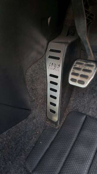

Oh yeah, I bought a snazzy little footrest thing to make it look superior* to your standard Fabia types...
