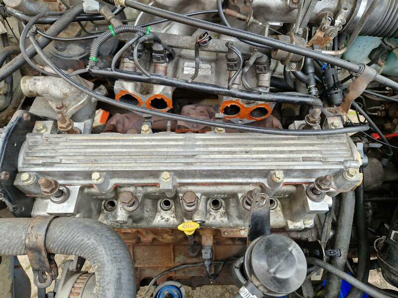

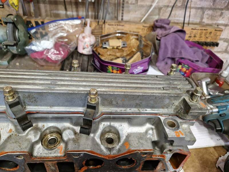

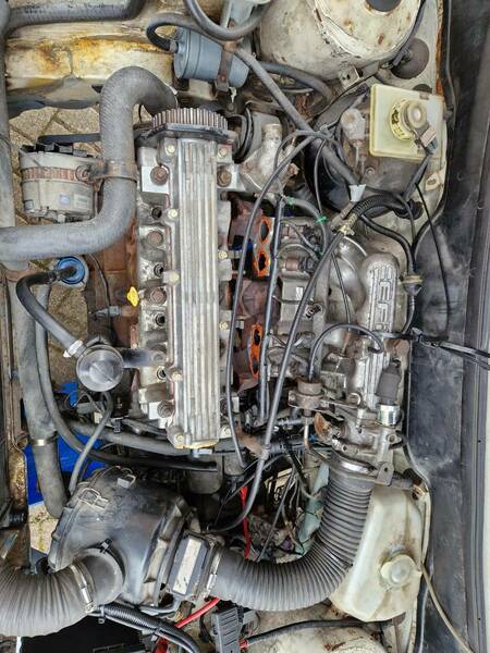

I've commenced the cyl head swap on my Maestro before the shit weather sets in. It's supposed to be raining tomorrow and Thursday so I'll hopefully conclude Friday.
No major worries on the removal but some of the manifold nuts were a bit loose so I've invested in some copper (cupro nickel?) high temp locking ones.
Nice to be doing a job where it's all familiar, it was only about 9 months ago I had it all apart.

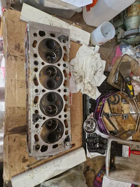

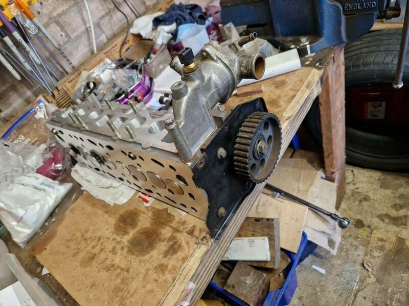

I need to pull the valves out of the old head. I've got new valves for the new head but I need to re-use the springs, caps and collets. Then there's the fun* of checking the valve clearances using the Haynes DIY special tool.
I'm interested to see what sort of difference the (gas flowed) head makes. It's probably pretty marginal, 10% maybe? The exhaust is noisy but surely flows pretty well. Intake is stock.
Anyway it'll be good to button it up and have it all ship shape for Spring. Not sure if I'll tax it from March or April - I'll probably just keep an eye on the forecast and hope for no cold snaps.

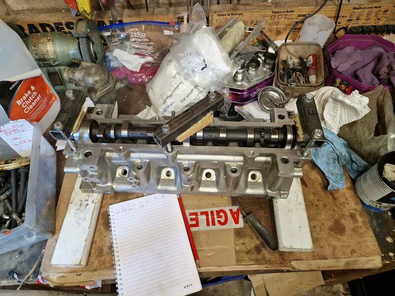

The easy-to-use* Haynes-o-matic valve Clarence, ladies and gentlemen.
The idea is you clamp the camshaft in position then check the clearances on the lobes that aren't pushing a valve down.
I think the book spec is 0.25-0.35 or summat like that. Mine are more like 0.35-0.40 so a bit too large. But my theory is thus:
It's a new head and new valves. No valve recession has occurred. After some miles, the valves will settle in and as they do, those clearances will shrink back towards the recommended spec.
The other slightly more pragmatic reason for settling for this is because the bucket shims are NLA and are a stupid size (15mm diameter). I do have a few spares but they're thinner so they wouldn't improve matters.

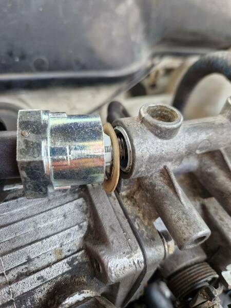

2) Somehow I've broken the idle control valve. I was feeling smug by removing the inlet manifold and throttle body as one whole unit, then cable tieing it to the windscreen wiper to keep it out of the way. But somewhere along the line I've obviously strained the connector or perhaps knocked it. The body of the valve split from its thread which was stuck in the throttle body but fortunately it came out with a screwdriver and hammer.
I'm not sure if I kept the original, so I need to pop to my lockup and rummage through the spares box.
Fortunately spares are available and cheap, but it's more about the annoying wait for parts than the expense.

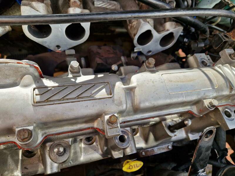

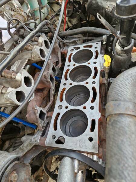

Well.

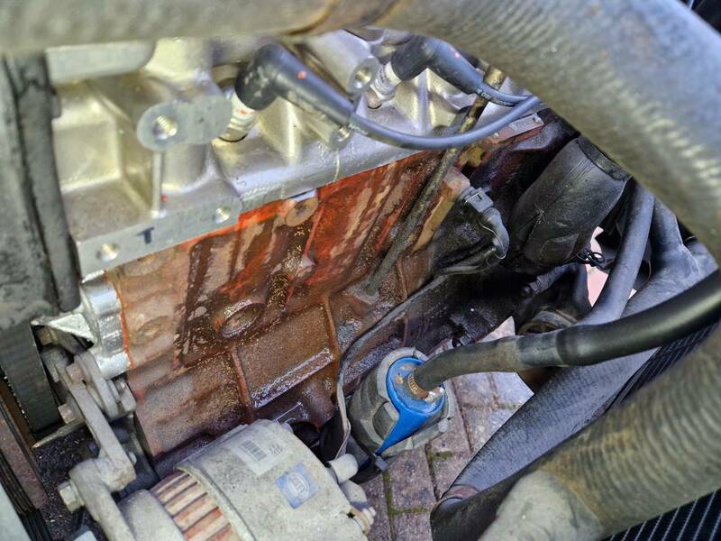

What the fuck is going on here? 20240223_164821.thumb.jpg.3b02f0505c71e41cf0d2b8854890d7c9.jpg

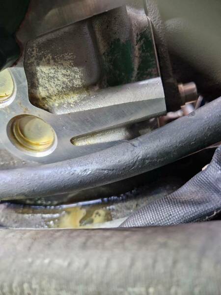

It's all bolted together so I go to fill coolant. Put in about 5 litres then went and did something else in the garage.
Then went underneath to check on some stuff and there's coolant pissing out, running down the block and off the sump.
Immediately I assumed I'd forgotten to do up a coolant joint somewhere, but no - it's actually leaking directly from the head gasket between head and block.
What the hell?

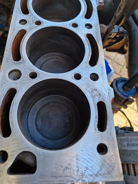

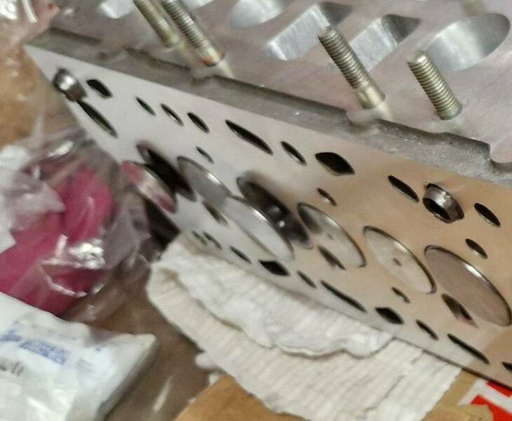

I was pretty careful cleaning up the block - sanded several times, hoovered up the dust, blew it out with an airline, hoovered it again then wiped with brake clean. I'd have happily eaten dinner off it. 20240223_092911.thumb.jpg.a72694fd6833c8a3a0031f2dd4cb0371.jpg
The head is also very new and very flat. The porting place said that even though the head was NOS, it wasn't flat so they skimmed it.
I torqued the bolts according to the three step Haynes instructions: 40Nm, 80Nm, then +60° or 108Nm whichever comes first. Of course, in the spiral pattern detailed in the book.
I can't think what's going on here. My prime suspect is the head gasket itself. The gasket has the circular inserts around the cylinders - perhaps they're too tall, or too hard, so the water jacket bit isn't sealing on the gasket. 20240223_092932.thumb.jpg.56b7868c522e919c9180f8830417c548.jpg
Just really weird that it would fail so catastrophically without even being run!
Obviously it's all got to come apart AGAIN so that's a major pain in the ass. I do have another gasket to try so I'll just have to try that I suppose.
Fuxache

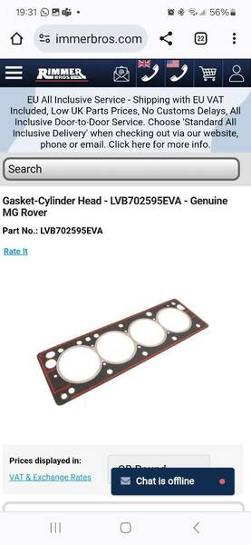

I've looked a bit more at head gaskets that are available for the O-series injection. The one I've used is so old there's an asbestos warning on the back of it. I don't remember when they banned the stuff from car parts but I bet it's early 90s. So every chance this 'King Seal' gasket is 30 years old. (Side note: King Seal sounds well shady). 20240223_182552.thumb.jpg.8abb0fea84a92ea7d99b17f563cd9fe1.jpg
Then there's the second one I have, a 'Tomic Limited' which has a slightly different part number:20240223_182555.thumb.jpg.d6eff43724aa0770bc3edd93c6b89615.jpg
Checking Rimmers the Rover gasket looks subtly different in the oil ways or water ways. IMG_20240223_182350.thumb.jpg.4503ae867e7f03111c0331bdc2393c69.jpg
But it's £65, and I don't need all the other gubbins supplied with it anyway.

Have you checked the block face with a straight edge? I've always winced at the thought of using sandpaper on a block. Unless it's cast iron, to a lesser extent.

Yep it's an iron block so a bit more idiot proof, maybe. I did check with my metal rule and I couldn't detect any non straightness.
I've managed to find a genuine Rover gasket from Rimjob for a more reasonable £25, the one they have listed for MG Maestro is actually for a diesel, the twats.
@grogeeIf it is leaking that badly when torqued down, then something is preventing the joint from closing.  Are the dowels that you swapped from the old head possibly too long for the counterbores in the new one?
It's a possibility I suppose. Here they are back to back. Unfortunately not the same perspective but it looks like they're sticking more proud in the new head than they did in the old.
I knew I should have ditched them!

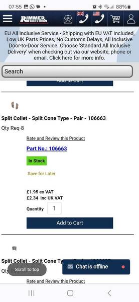

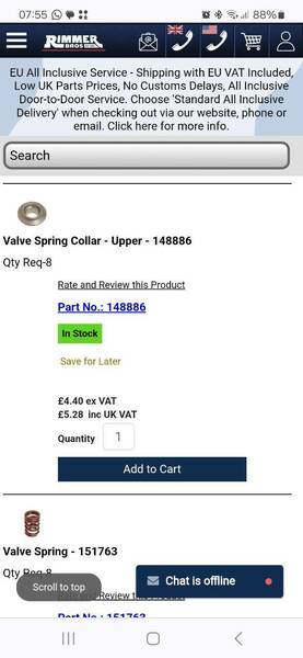

Thanks. I found a load of shims on Rimjob's website for a TR7, are they definitely 15.5mm diameter?
Do you happen to know if the TR7 valve spring collars and collets also fit my O-series head? (If so I can order some and get the old head cleaned up and built as a spare).

no idea about the valve springs and caps I junked the TR7 4cyl in favour of a RV8, I did harvest the shims as spares for the elan though and they are both 15.5mm.

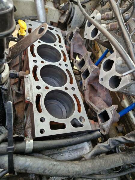

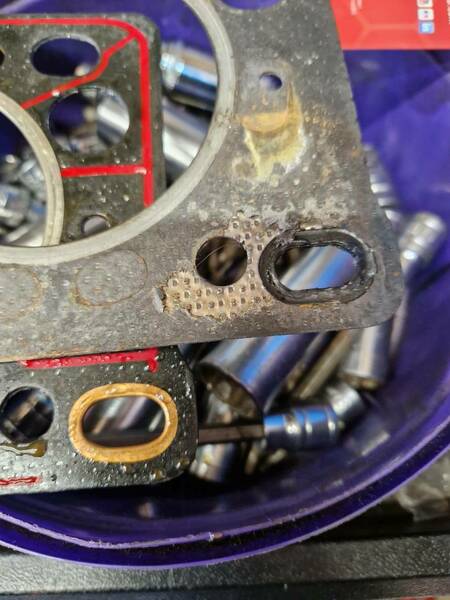

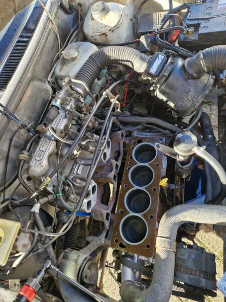

Oh wow, if it's not raining it's pouring. 20240224_145735.thumb.jpg.67bb258da9dbab521c6f59ef59d8b3d5.jpg
I think I know what this is though.
The old gasket had a rubber oval seal on the front corner for the oil way. This latest one has a copper oval seal which I suspect isn't sealing, allowing oil and water to mix. It's that corner where it's dribbling out from too.
I've got a pukka Rover one coming so looks like I will be doing it a third time. I'm getting good now, started at 11 and finished at 3 with 1/2 hr for a sandwich. 20240224_121706.thumb.jpg.2b464639d4b04e860102b20991ec5362.jpg
Note patented Ezi-Align studs to keep the gasket and head aligned - I cut the heads off some old bolts and rounded off the ends with the grinding wheel. This time the head was fitted without the dowels, although according to my calculations there was enough space for them to sit in without fouling.
Again - happy that this isn't my everyday transport because it's being a needy bastard.

Head is off again, whipped it off this morning. Felt like a rally mechanic doing everything by muscle memory.
It does look like the copper bit on my second gasket didn't seal, and the rubber oval seal on the previous gasket is a better solution. But concerning that it somehow found the water to mix with.
I've given the block face another seeing to with green (production?) paper and a wooden block, so it's as clean as I can get it.

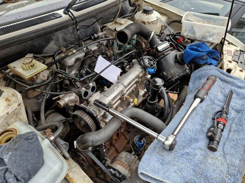

Once more unto the breach. A small window of Dry + Daylight presented itself after the postman arrived bearing head gasket #1 of 3.
I've put it all together and fired it up, without coolant as recommended by @plasticvandan. Ran it for a minute maybe, then I've left it to heat soak.
So I don't know if it's water tight, but the good news is that it's not pissing out oil. Tomorrow I'll fill up with coolant and see how she holds.
