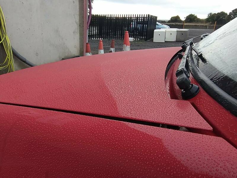

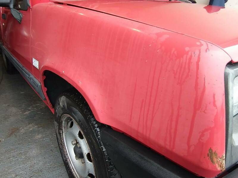

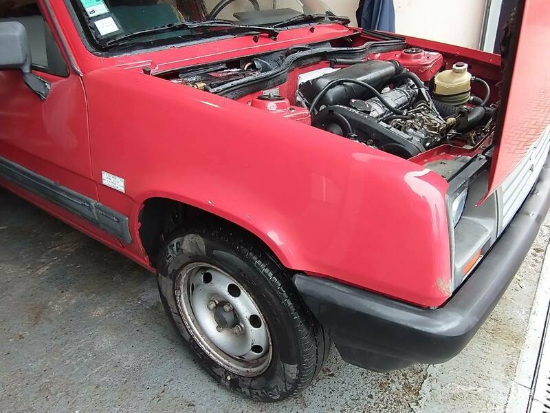

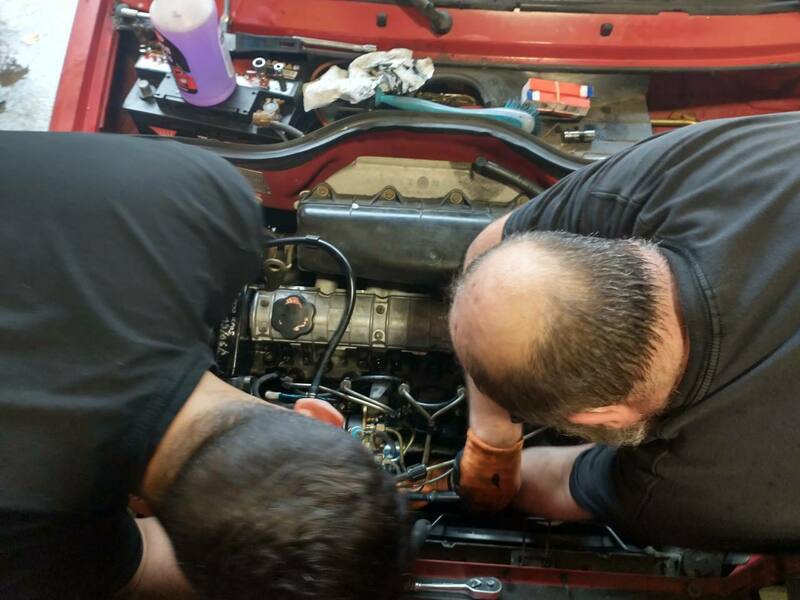

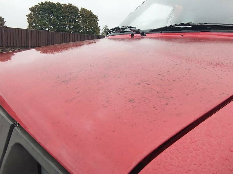

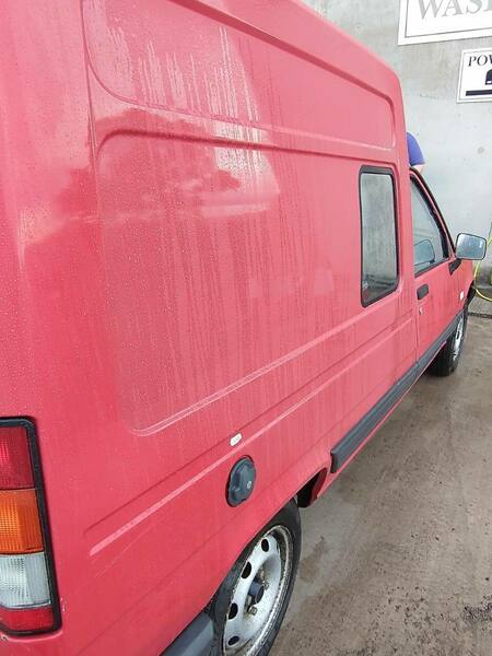

Lacquer Peel Posted October 9, 2021 Author Posted October 9, 2021 The Express's silent partners and one of their fathers joined in for some servicing and cleaning. It is a little cracker and in amazing condition for a 1989 van with nearly 170 thousand miles in Kms. The plastic hubcaps were thrown away to reveal silver steelies and centre caps underneath. It looked 55% better already. We had a heavy shift servicing, washing, buffing and waxing it. The paint is still a bit flat in places but it is now protected and looks presentable. The oil filter looked reasonably new but was torqued to 400NM or something, a ridiculous amount of effort to remove it. Heroic effort from @sdkrc and @320touring. We were worried it was cross threaded but the new one went on fine. Same oil filter as a Clio 182! @320touring worried about the glow plugs shearing but they came out no bother. The valve cover gasket had been leaking all over them for some time, the engine was hot and penetrating spray was used with abandon. The two behind the fuel pump were awkward but it didn't take long. BEADS. Valve cover cleaned. Detailing world. So clean underneath. Isopon, D.E, anonymous user and 23 others 26

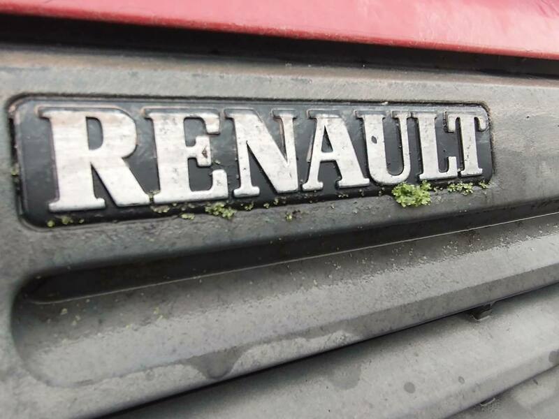

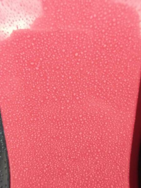

320touring Posted October 9, 2021 Posted October 9, 2021 Was good to see this in real life, and it is an utterly charming old tub. Mechanically it's ace, and bodily it is in pretty damn good order. A most pleasant day, and the Express left looking and running better than when it arrived. The lichen On the front badge is superb.. Underside it is seriously good. We got all the arches rinsed out too, @Lacquer Peel became a detailing god - a dab hand at driving the polisher, and putting wax on. Work carried out: It's had 4 new glow plugs New rocker cover gasket New oil filter New oil Engine bay wash and degrease Hubcaps removed Full body machine polish (just a light pass cos don't know how thick the paint is) Coat of wax Interior all cleaned too have a video of its first start on the new glow plugs/oil and filter. @Lacquer Peel is hoping to get a cold start vid tomorrow to demonstrate whether the new glow plugs have improved things And some more pictures too.. Cleaning the arches Before and after on the front wing before and after on the bonnet And a nice view of the beading on the side of the van Low Horatio gearbox, Minimad5, RobT and 22 others 25

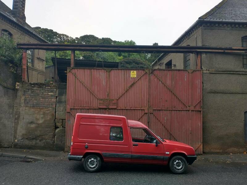

juular Posted October 11, 2021 Posted October 11, 2021 This thing is way better than a VW. Proof: It's such an amazing wee thing. greengartside, RobT, LightBulbFun and 12 others 15

Talbot Posted October 11, 2021 Posted October 11, 2021 2 hours ago, Sigmund Fraud said: This is glorious !!! Is it SVO/WVO friendly ? The underbonnet view looks to be rather Lucas/DPC rather than Bosch... so yes, but only with a pre-heat and/or twin-tank system.
