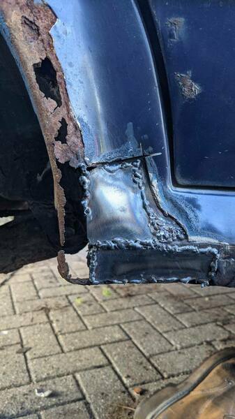

So begins the welding...
I won't profess to these welds being pretty and I may be welding to some pretty crap metal but theyre 'MOT standard'. I did find a bit more rot after digging under some filler so the plating went a bit further than I intended.
I definitely didn't just use a pair of pliers to bend round to form a lip...
Unfortunately I ran out of gas hence some of the welds look a bit shit. I wanted to get it tacked in at least until I go get some more tomorrow.

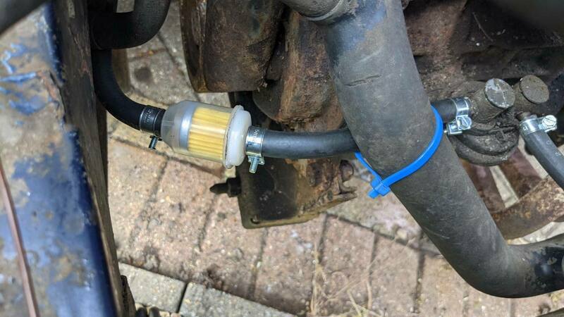

Also I blew out the hard line and fitted a fuel filter. I did manage to get hold of a fuel tank. Drove a few hundred miles to get a fuel tank off a Maestro that was parked under a tree looking very sorry for itself. The tank was absolutely brimmed so I got soaked in fuel but the silver lining is the tank was brimmed so I know it's a good one! Probably not very rusty either although I haven't looked inside.

I also finished the welding today! Didn't take many pics so only got an in progress and finished but we have some more MOT grade welding, which is solid but ugly. Basically I had to rebuild the back of the sill that connects to the floor and folds against the seam for the sill. A couple more patches on the bottom of the sill too.
Drowned in seam sealer obviously to hide my sins 😅

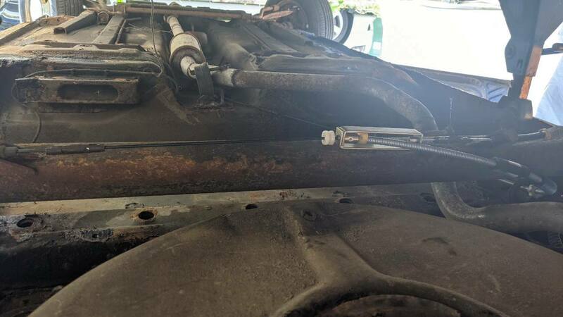

Then had the fun of the handbrake cable. So the new cables fitted ok but I was having problems with adjustment. Basically on fully tight they were still completely slack and not grabbing the shoes. You can see below how it was on maximum 'tightness'.PXL_20210905_110859622.thumb.jpg.f8aa0a480a3d3250a7e53670e039294b.jpg
After umming and arring I decided I needed to move the stop so I could effectively dial in more adjustment. As such I whipped up a spacer to fit between the stop and the tightening nut.  Basically I used a bit of 25mm tube and two driveshaft flange nut washers from a drum brake Mini to create about another two inches of adjustment. Works a treat and now it has a handbrake!
Link to comment
Share on other sites
That bracket doesn't quite look right, do you think the lever has been yanked too hard previously and bent it to that angle? Might explain the adjustment issue if the parts are definitely the correct ones. 11/10 for the solution to the problem though!!
That's correct for the bracket. I've since learnt the handbrake middle section comes in two lengths and I seem to have bought the wrong one. Although the saloon/estate/maestro are meant to be identical forward of the rear axle so not sure that's the case.
