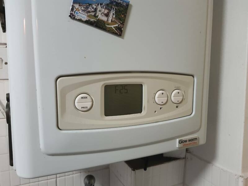

Are the people who drive round with the car heaters permanently facing towards their feet/stomach even surprised when they cannot see anything out of the windscreen? The same windscreen that's covered in greasy hand marks.
Oooh no hot water or heating!
Off then on again. It tried to fire many times and said it reached 98/99 degrees briefly... The heating pump made a racket in the airing cupboard too.
Then
And no heating. I poured a kettle of water over the condensate pipe (water never usually comes out of it, or I say didn't, it got repiped in 1/2inch straight into the drain last year so I can't tell anyway. Left it a bit and

Is the central heating pump running? reset the boiler, run to the location of the pump (probably airing cupboard) and see if you can hear it making any noise. Noise = good.
If no noise, tap it gently with something like a small hammer in case its stuck. Otherwise its new pump time.
We had this a bit before Christmas. Ring the landlord/agents emergency OOH line and ask them what they're going to do about it, and how soon.
Ours needed a new pump at ~£200 supply and fit.
EDIT - also, remove the front cowling and see if you can see a flexible 1/2" pipe coming out the bottom of the boiler - thats the condensate pipe. Put a bucket underneath and pull it off (it'll only be push fit) and see if lots of water floods out (like >a few hundred ml and <2 litres) - if so, the pipe or drain is blocked downstream.

I was getting noises in the airing cupboard from the heater pump, it didn't sound happy but then it probably wasn't!
When it flashed f11 it stopped everything though, and turning the power off and on again didn't solve it.
The internal bit of the pipe is glued I think, it had a drip a year or so ago and a man came and fixed it... (ill have a quick go in a sec).
Done one kettle over the pipe, might go and do another one though and see

F22 is low pressure iirc. Does it cycle faults or? Any bar readings?
Yea it cycled a few, with the airing cupboard pump making low pressure type noises, and a the big electrovalve clicking madly. Turned the water and heating off and 'gave it 5 mins'. F25 came up. Ffs.
Off at rhe wall, back on again and I turned just the heating on (kids had a shower, that's electric so warm) and the boiler tried to fire and climbed to 99 degrees then back down, did that twice then threw f22.
I rebooted it again, left the heating and water turned off and it sat saying 40 degrees which is bullshit, it's cold temp is 28 in this weather. Then it threw f11 and that soft killed it, no matter what the power cycle it stills ays that.
Got through to the emergency number, it's logged, no surprise no one answered her at 8.20pm, so it's gonna be a chilly morning! Could go for a 40 mile drive to warm up before dropping the kids off at school 900 yards from my house

If it is like our boiler (it looks very similar) then it will fire, heat the water inside the boiler mega quick then shut down because cold water is not being pumped through. The boiler is fine, its just the pump thats conked/conking out. Its actually a much cheaper job. Put the oven on with the door open for a bit and sleep in the kitchen!
If it has a fill valve you could try that- topping up low level may work temp until proper attention. I have no idea what yours is like mind, ours had a slow leak so needed topping off once a week or so until it was sorted.

If the boiler is firing up and then going up to 99degrees then the water is not circulating.
That points to the pump not working. Or lack of water in the system.

Still no plumber, got through to the one the lettings agent told me to call and he said a few days just to diagnose... Don't think the agents are having much luck either. I bought a small heater, a mate primed it to ny house tomorrow...
Suppose the alright thing is its not much colder outside than in...
A polite, but stern call to remind the agents that is is JANUARY, ambient temperatures are around ZERO CELCIUS and you have no heating and 2 children, and perhaps, just perhaps they could find a local plumber who does have availability might be AN GOOD IDEA. Perhaps suggest the agent goes home tonight, turns their heating off, opens all the windows for a couple of hours and then has a bit of a think about whether this is a nice situation, or a not nice situation?
You pay them to provide a service, remember that.
If no success than a similarly polite but stern call suggesting that if they cannot provide the services contractually agreed then you may elect to withhold rent until a satisfactory solution is found could also help grease the squeaky wheels, but keep this option up your sleeve as it loses potency the more it is used as a threat. They do shit themselves though because as far as I'm aware, most agents have a 'guaranteed rent' agreement with the landlord where they pay the landlord no matter what, if you can't/won't pay then its the agent out of pocket, not the landlord.

Check the condensate output pipe outside to the drain is not frozen. What pipe is it (eg, 15mm copper, or 25 mm plastic?)  When mine was a 15mm copper, it froze regularly, stopping the condensate going out, and coming up with a fault code. Changed it to a larger diameter 25mm plastic, no more problems, as water could flow even if a bit frozen.  Also, make sure its path out flows down all the way.

25mm plastic. Yep, did so much water over it last night it went soft briefly. Still no dice, somethings wrong with the pump I think the boiler knows.
No plumber today and no one is answering the out of hours number. Oh well, will keep ringing it throughout the evening
With the boiler off, undo the big screw - a little water may come out so have a towel handy. Inside is the end of the spindle - try turning this with a small flat-bladed screwdriver. If it's seized, the pump is fucked. If it sticks, but then turns, you may have fixed it. If it turns, the problem is probably elsewhere, as long as you have 240v to it.

Yea thats what makes the racket, either through low pressure or being fucked, it's that which is coming up on the boiler, the error code for the pcb in there.
Might give it a go though, I rent but they must be having trouble (my dad was a lettings agent for years, I've seen the other side) finding someone as the lady called me back and said feel free to Google ideas, so that can be the first one. Not gonna go looking for voltage or anything though, that's a step too far.
This is also all identical to the issues my mum and stepdad had when the heating pump went at theirs, the fact that you mentioned it as well is a bit sus
If that pump is making a racket, it must be doing 'something', and getting voltage. My experience of 20 or 30 of these over the years (not in domestic boilers) is that they either work or they seize, never had one causing noise though.
