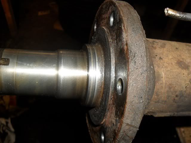

The roadworthy* 88" is haemorrhaging EP90 from both rear hubs only 1000 miles after I fitted new (britpart) hub seals.
I've seen that on a friend's 109 ex-field-ambulance many moons ago. It kept pissing even after changing the seals trice, and each time the rear brake shoes were so contaminated that they had to be replaced, too.
I then got angry and pulled the axle shafts, and low and behold, they were run in, i.e. had developed a groove, where the seals were supposed to seal.
I thus took a flame sprayer (I hope this is the correct English term) and sprayed new metal onto the shafts, then turned them in a lathe and polished them.
After that, the seals sealed like it was their purpose.

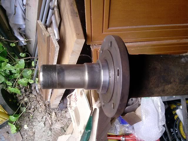

Depending on the age of the land rover/axle, the collar that the seal sits on (sometimes called the land) is removable. I put new lands on mine.
Before
After
