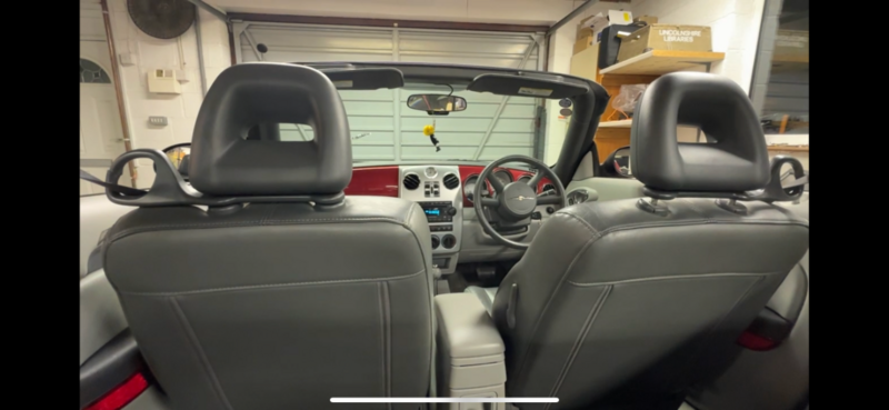

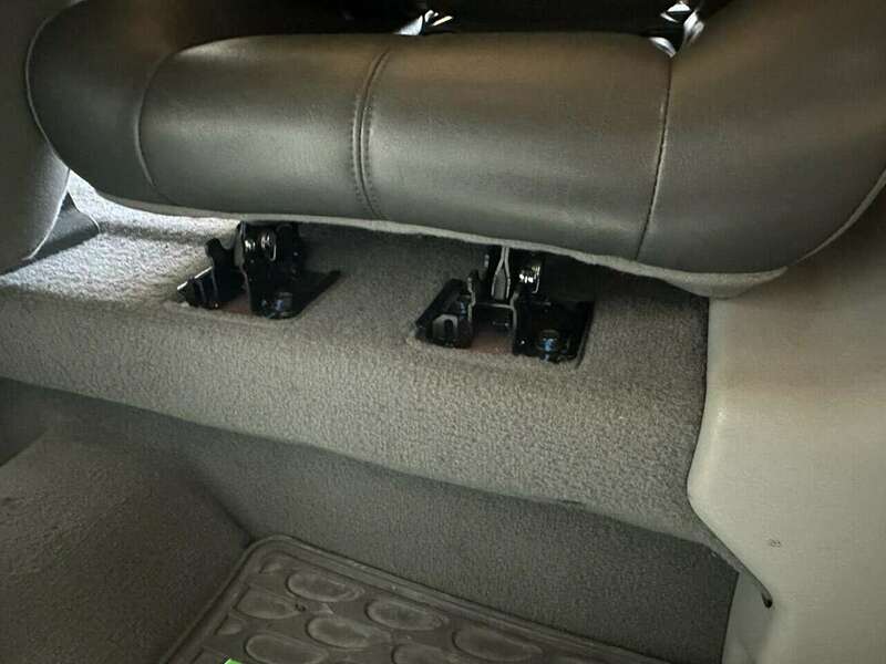

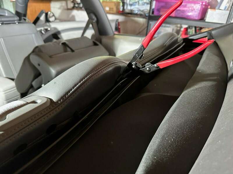

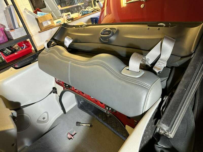

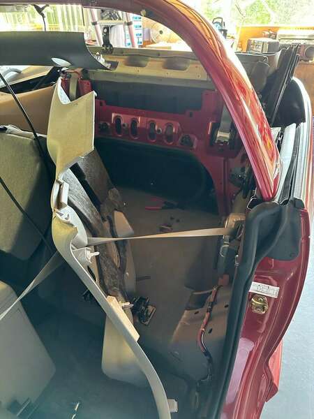

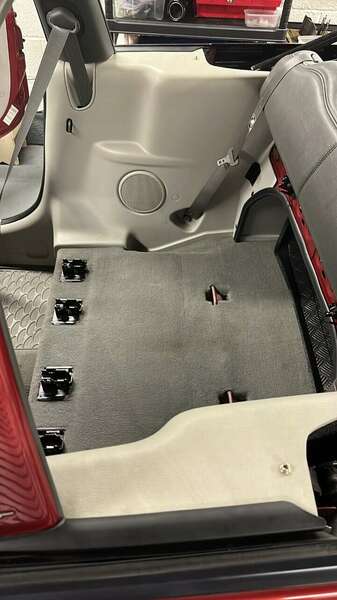

Time to do the PT Cruiser rear speakers. I replaced the front ages ago but the rears are horrid to get to. I'm ignoring forums and shit youtube videos and following the workshop manual.
Seats forward, undo the check strap brackets (13mm) and the obvious silver bolts on the headrest pad (13mm)
Seats down, remove the plastic covers for the latches - wedge clips at the back, be gentle no damage. This reveals the spring latches.
Lever the latch forward and insert a metal rod. I used a bookcase link hook from IKEA and released the other catch while lifting the seat out. They are light as anything.
These latches want your knees for dinner.
Undo the plastic pegs holding the roof cover guide.
Which reveals...
Four torx-headed screws.

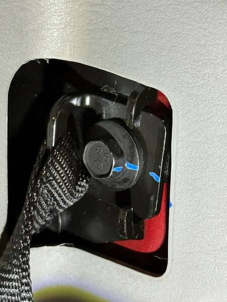

Undo the seatbelt anchors (21mm) and flip the belts up.
Now discover it's too warm and there's a stage I forgot about undoing the belt guide, so have a cuppa.
I'm not obsessed with things being "right" honest.

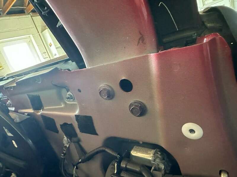

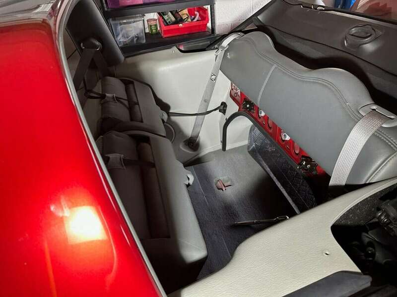

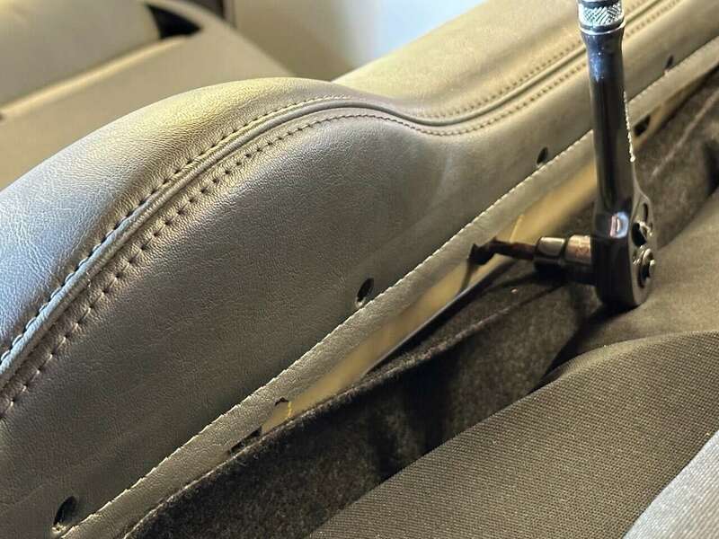

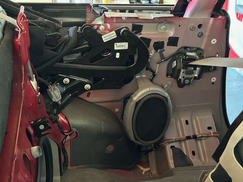

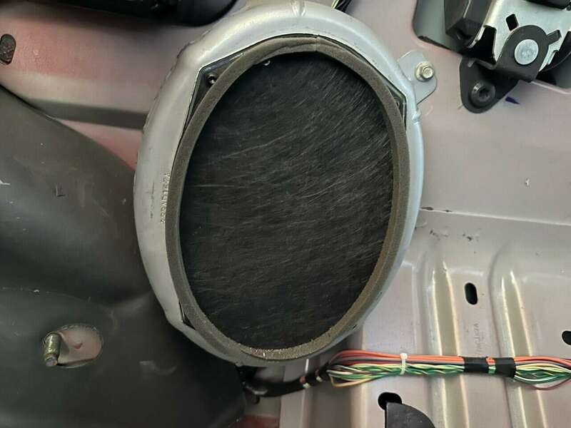

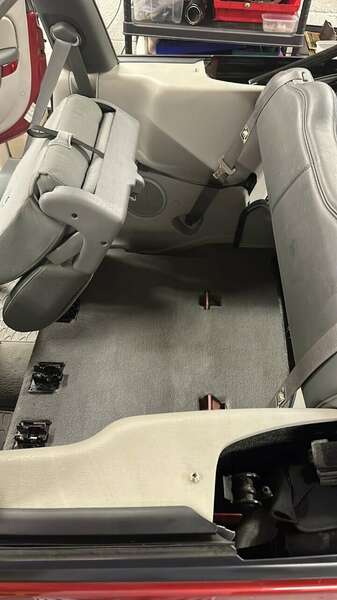

This Cruiser speaker replacement is breaking my brain. The rear bolster/headrest was held in by a thick steel reinforcement bar not mentioned in the manual, and now it looks like I have to detrim the sports bar to clear the upper edge of the quarter panel trim.
But the speakers are as far forward as you can imagine so flexing the panel for wriggly-arm access is not really feasible.
Good thing I am all about that bass and  blown 6x9s are REALLY annoying.
What a tedious pain in the arse.

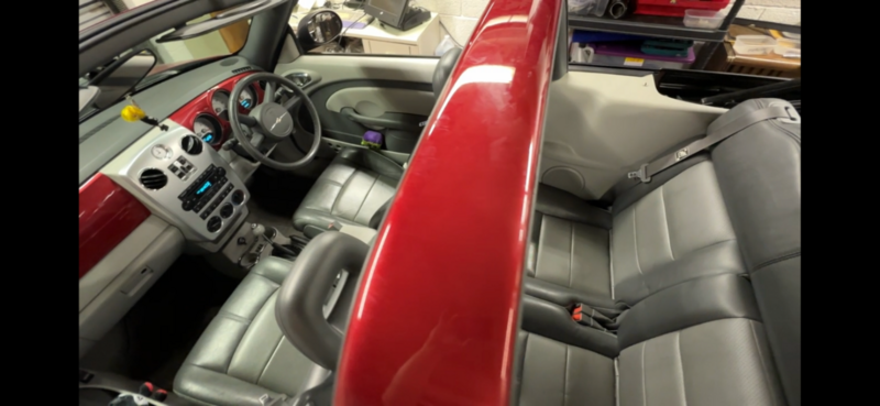

Yes, the roll hoop really is entirely decorative and bolted on.
I am not looking forward to reassembling this lot and ensuring it does not get any damage. But all the cavity rustproofing is happening.
That looks a right faff!
Make sure to give those speaker brackets a good examination before you reassemble everything to make sure they're not able to move relative to the panel they're attached to.  Last thing you'd want to do would put it all back together and then discover the frame itself was buzzing against the body of the car because there was a tiny bit of clearance under one edge.
The roll over bar is just a bolt on part? That doesn't seem particularly helpful, neither does it add to the aesthetics of the convertible...
They're solid as anything - I did debate, given the faff, fitting some 3-way 6x9s but the mission is get rid of a blown speaker, not upgrade - the head unit is not awesome and I just hated the fwoomffwroomf of a clearly duff speaker in the back. Fronts are already done and on those, the magnets had fallen off!
Do need to get some isolation foam though...
While it's all apart...

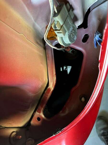

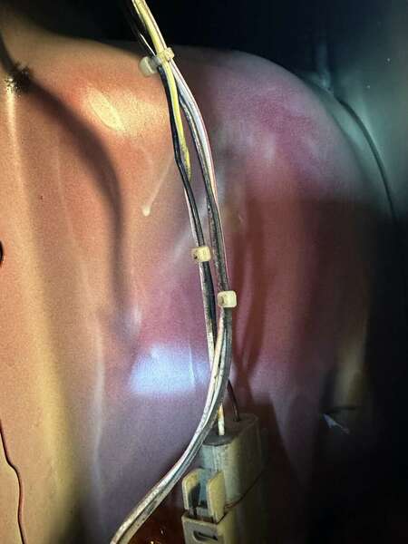

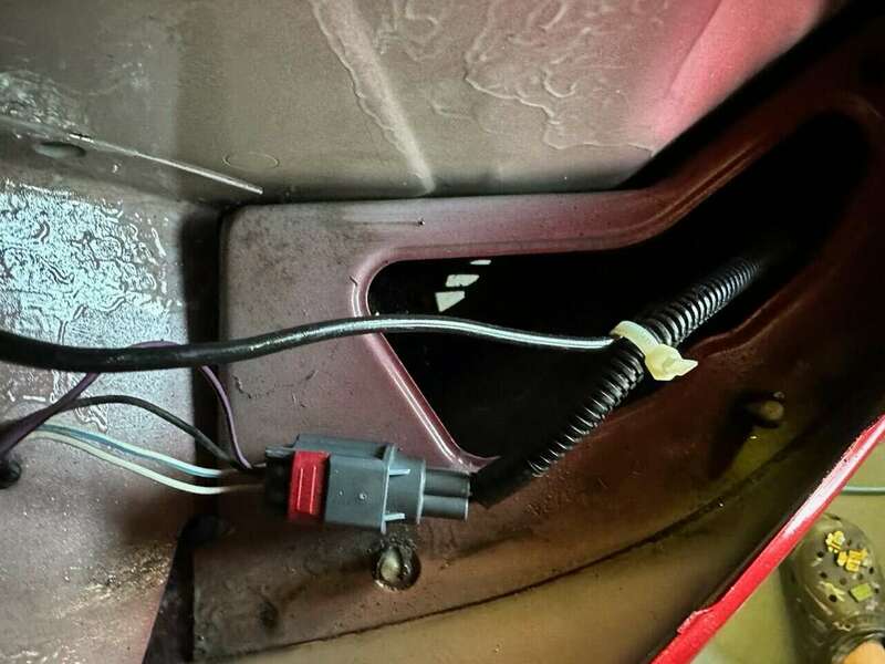

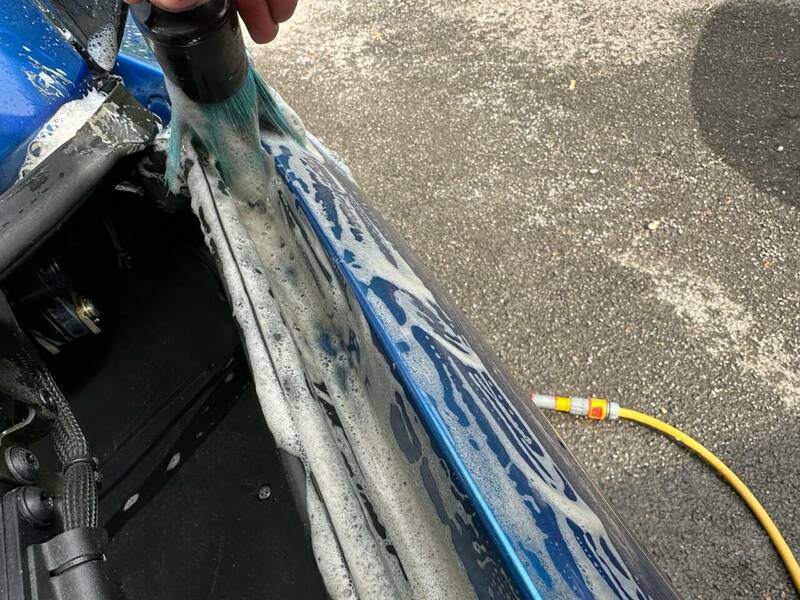

I mean, it really is like new throughout there but some rustproofing never hurt. Hairdryer into seams and any spotweld looking things. Will fit new bulbs and get the silvered ones to get rid of the fried eggs.

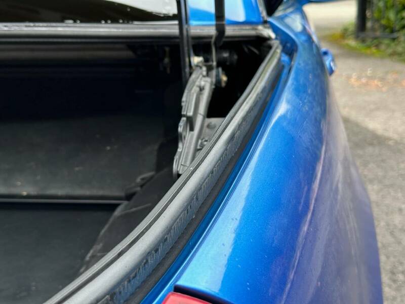

It's a spoiler  - it does the job of a windbreak and benefits rear passengers, actually a very clever design - I think the cars look weird without them but a few people have removed and added alternative seatbelt upper anchors. Some people claim there are a couple of spotwelds as well but mine looks purely bolted...

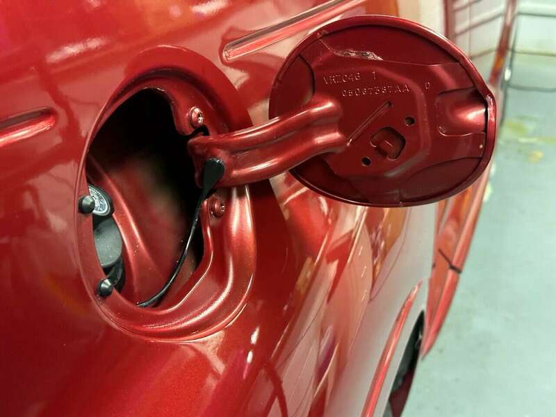

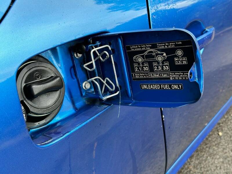

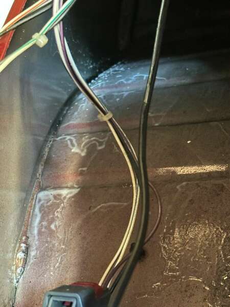

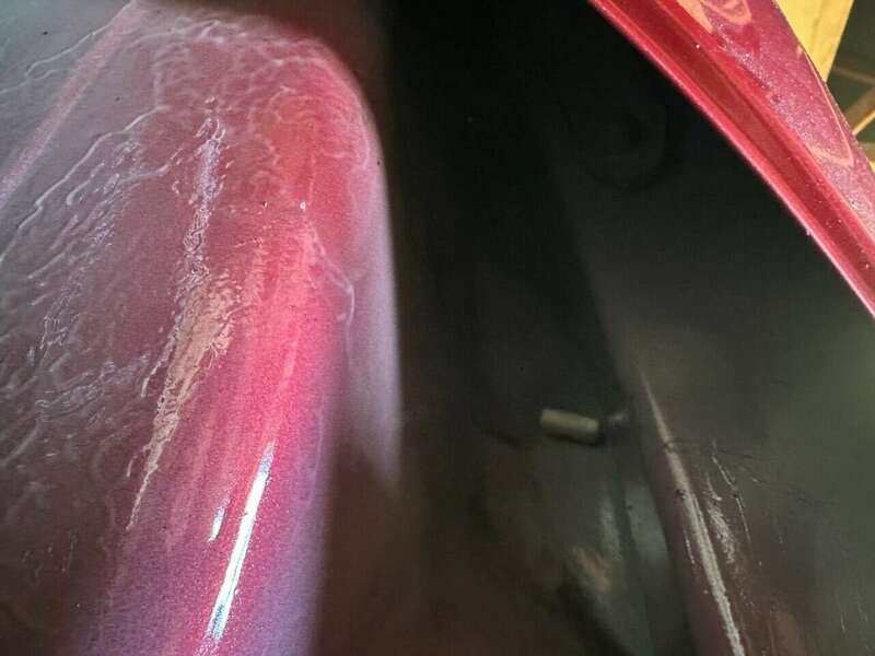

Offside rustproofing - this side gets mucky and needed cleaning - I assume from the fuel filler.
(the blue paper snag is from wiping excess that dripped on the wing)

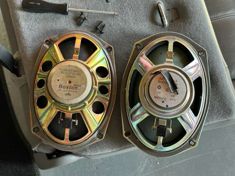

Well, the PT Cruiser has working speakers and sounds good, but it's damn hard getting the right sealing foam to recreate the original!

But with the aid of a flexy hose it's had more stuff dripping from random cavities than a dodgy hentai Laserdisc.
Could definitely do more rustproofing but I need a proper bucket and application kit. And I really just want to reassemble the interior now.

Can't embed the video from FB so some stills but the point is John Grant Pale Green Ghosts which absolutely hammered the broken speakers playing without (added) distortion and sounding alright even at full volume.

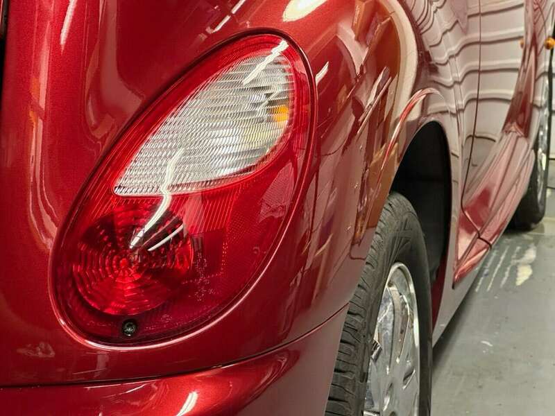

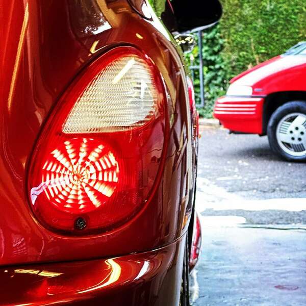

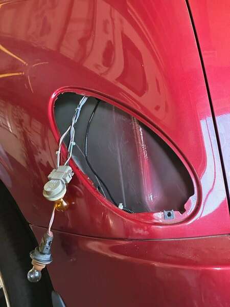

Why are PX27/7W bulbs so awkward to get in the UK? Or more precisely, why is it so hard to find silvered/chromed amber once to de-fried-egg the lights? It looks like Land Rover used them so it's not just a weird not-domestic car thing but the options for bulbs look crappy as anything, no recognised brands at all.

Either way, once I've got new bulbs (the old ones worked but they were flaking the amber off and I wanted to replace all the bulbs while I had the lights out to rustproof) I'll get this MOTd and try and enjoy a few drives with working tunes and so forth before the roads get salted.

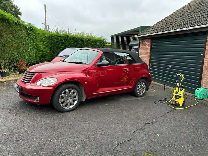

Lights back in now the silver bulbs arrived, Lilith exits her lair...
Dusty - not good for polishing.
Good start but the Karcher bottle ran out.
Custard one I should have dialled back a bit...
So. Yellow.
Finally rinsed off.

May have polished the lenses.

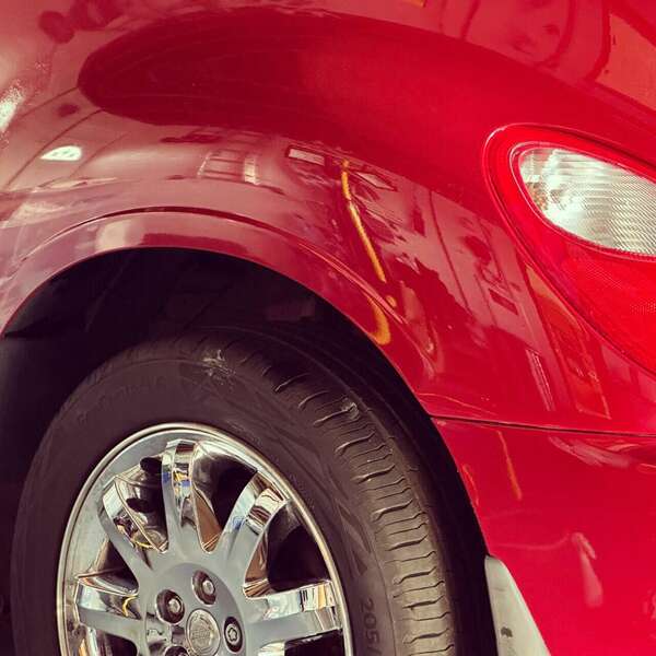

Chrome wheels are NOT fun to clean.

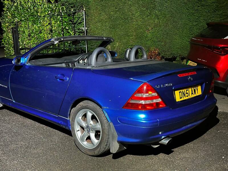

The balance of it in a brown paper envelope still on the desk covers a delivery from @Agila...
Which after chatting I figured I would have a look and if I didn't like it would just roffle as planned and not lose any money, also avoiding a trip to the bank. I checked insurance quotes first. They're fine.
Once I saw it and looked it over, I'd say it's better, really, than my yellow one was when I got it. I say that because when I got it, the owner sent me pictures of the rust on the rear arches, and them repairing the rust, so I knew what I was getting. This is pre-repair level but still good. Front wings are very good. Didn't dig super-deep but underneath is good, including the torque links. Interior is good and has electric seats. No AC, no problem. Roof works and is smooth, no clatter from the parcel shelf, no squeaks from the windows.
Gearbox/clutch feels good, steering is nice, nearly new Uniroyals on the front, decent history file, two keys.

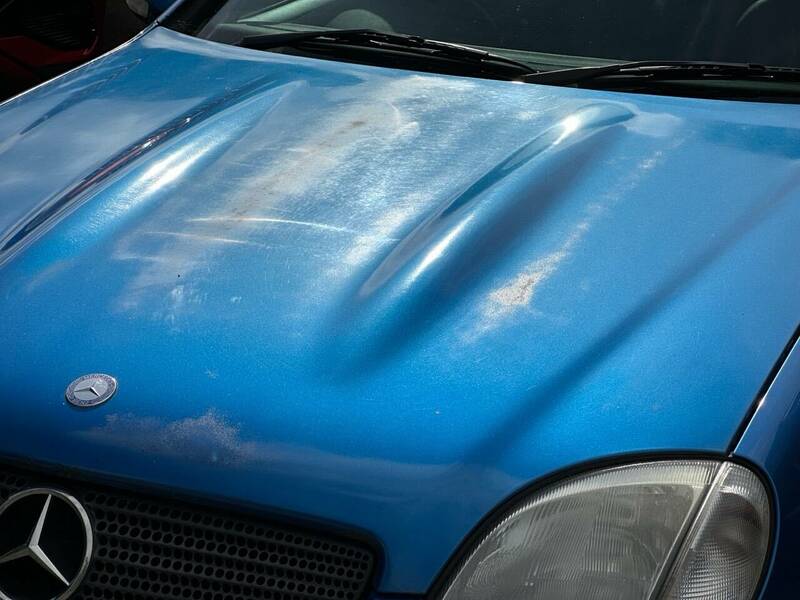

Downside, the paint. Who cares. Paint doesn't stop it from working. But you'll see if I can make a difference to the overall ambiance of it anyway with a bit of attention...

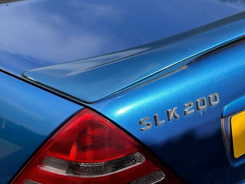

That Carat Duchatelet rear spoiler is subtle and really rather nice.

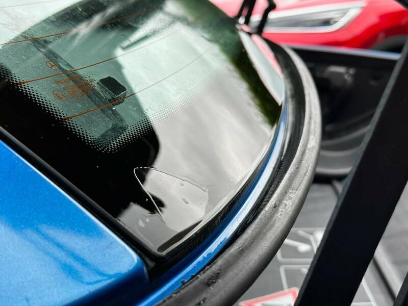

That Carat Duchatalet spoiler is as rare as rocking horse s#/t apparently. It had paintwork done by mercedes under warranty before my ownership. It also had horrible massive alloys on it without any stagger which made it handle like a scared antelope. I'll try to dig out a picture.
I installed the extra bit of wiring loom between the cam magnet and ECU. This is an official Merc part and prevents the ECU filling up with oil - which is nice 🙂

I looked for the interstitial loom mod - the cam magnet is leaky, it'll be getting a new one (hope they're still reasonably priced - it's a decade since I last swapped one though!)...
