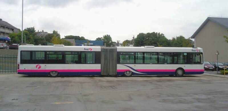

Speaking of, I can now confirm that the B7LA I was referring to earlier is Y148ROT.
One of very few buses I've driven that I honestly didn't like!  I quite enjoyed the bendies, even though the whole experience of driving a vehicle where the engine is in the trailer is a little strange at first...that particular one however just had something far wrong with the braking system I feel.  The B7LAs First had all seemed to have hair-trigger brakes, but that one was an order of magnitude worse.
Probably a stupid question, but do the rear most or middle wheels drive those bendy buses?
1 hour ago, Barry Cade said:
My old roadrunner had air brakes, and you either crashed or went through the windscreen if it wasn't loaded.
Glad it wasn't just mine then...
Engine is in the back. Rear wheels are driven. The rest is witchcraft
The engine is hung right out the back, rear wheels are driven.
The results on an even vaguely slushy road in the winter is predictable...
It's downright creepy as in the cab you honestly can barely even hear the engine...
Some of the larger coaches used a conventional front/mid engined coach with an unpowered trailer...Know Stagecoach Bluebird had a couple of them, but sadly I never had a chance to travel on one.
I believe the reason for having the "trailer" powered was something to do with driver licensing rules...if the front part was powered it was classed as a vehicle & trailer so you'd need a D+E licence...whereas if the trailer pushes the front it's not considered a trailer so you can drive it on a normal category D licence.
