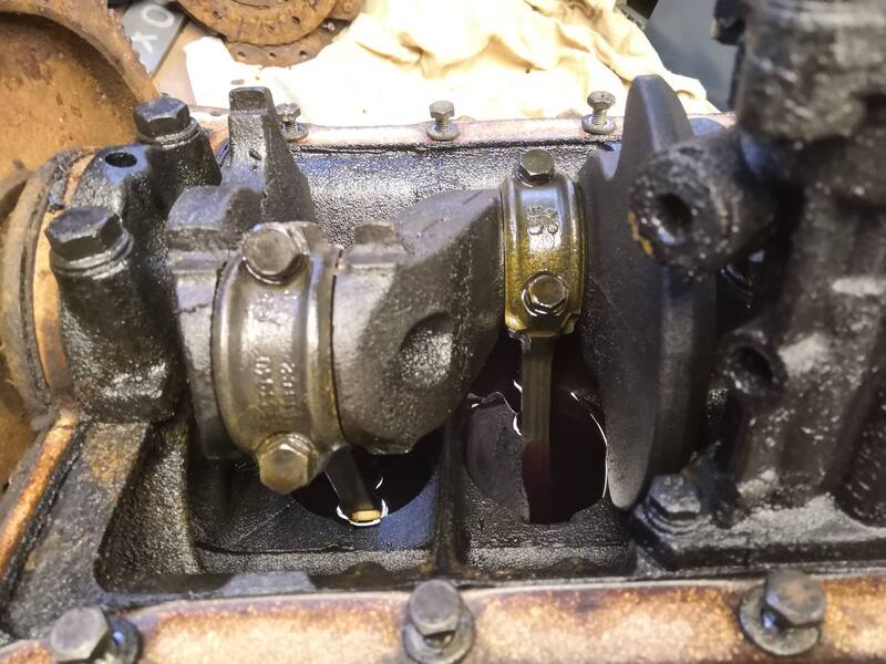

So here we are, another weekend and a little bit of progress. Main bearings and big end shells are all now removed.
Unfortunately I can't remove the crank because you have to take the timing chain off, and to take the timing chain off you have to remove the cam chainring, and I haven't got a gear puller. I'll have to get one this week.
The cam is moving a little bit more freely now, and the oil  pump/dizzy drive is moving as it should. So that's good!
There is some scoring on the big end shells but I'm not going to worry about that for now. Hopefully between these and the engine from @Slowsilver I can make a full good set. Although this is all a huge pain in the bum, it is kind of nice to think that some of Bob's original engine might end up in this one.
I think you are doing fine.  Will the timing chain come off if you remove the tensioner first, and then you can leave the sprockets in place?
Alas no. I did try that but it's been cunningly designed by a French man so that there's not quite enough slack to remove either sprocket.

I don't know the specifics of Cleon lumps but are the big end caps marked up for position and orientation? Wailing and gnashing of teeth may occur on reassembly if not.
