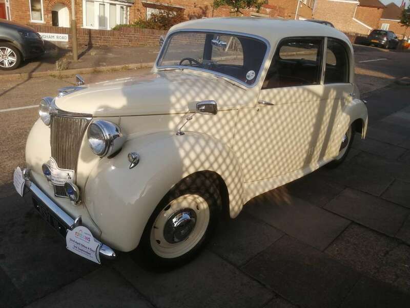

A gratuitous LD10 pic or two. This car and vulgalours are responsible for me joining AS. Andy round the corner, aquired it from someone who realised he'd never finish it and got it into this condition over a good few years. Probably started from a similar position to yours though. Thought he'd get it on the road fairly easily, but ended up a complete restoration. Can't quite forgive him for changing the colour from black, but it does look good. Just completed a coast to coast run in it. His LA10 isn't such a happy tale. Big end failure resulted in it being recovered and it sits waiting attention. It did do a run to the Netherlands a few years back, though. IMG_20230909_175241.thumb.jpg.278b7af853d3a79b9b6998d082634c7d.jpgIMG_20230909_175110.thumb.jpg.4eac326fafb0fdbceb0426dbf71536f6.jpg
