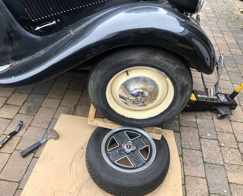

DSdriver Posted March 28, 2021 Posted March 28, 2021 On 7/4/2020 at 10:37 PM, Three Speed said: My Herald is currently wearing 5.5J steel wheels but it is supposed to be on Avon Safety alloys. The reason it isn't is that they're a bit scruffy and the tyres are seriously old. I have started cleaning them up with a glass fibre brush. I plan to order some new tyres but I don't think tyre fitters like these Avon Safety Wheels. I have heard the ring is hard to fit and remove. So, I thought it would be a good idea to take a look inside and see what I can do to make it easy for them. I've never taken a tyre off any kind of car wheel before. First challenge - break the bead. I tried the trolley jack method - using a ratchet strap and a couple bits of wood. Result? One broken ratchet strap. So I tried something more substantial which was more successful. The first one I tried had an inner tube fitted - and no metal band covering the well inside. No rim tape either. I don't know why it had a tube - I hope it is not because the wheel is porous. And why no band? Maybe the band was not fitted because the fitter didn't think the tube would last long if it was. But I'm not sure it would sit well on top of the exposed well groove either. And it seems a bit odd having a tube in a Safety Wheel - blowouts and all that. I wonder if my uncle (whose car this was) knew about this - he was very particular about things. I wonder if I can get another band. I tried to get the tyre off the rim but gave up as I didn't want to cause damage. The other three wheels don't have tubes - so I had a look in one of them and found the band in place. To get it off you "just" have to loosen the screw - it's not that easy to get too with the tyre in the way but I came off in the end. I assume the other two wheels have them fitted so I'll get them off too. So, now we know what the inside of an Avon Safety Wheel looks like. Handy tip: Use your DS suspension to break a tyre away from the rim Three Speed 1
