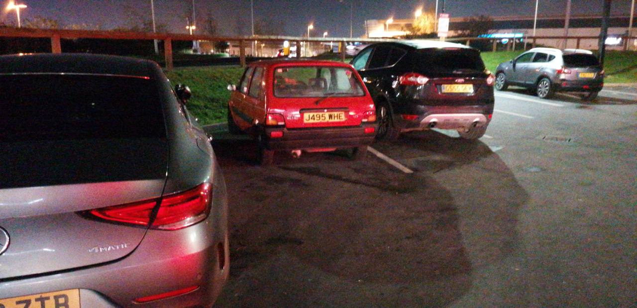

It's back now.
Had to stop off for a wee on the way home.at Lakeside Maccys
Happy with the clutch feel now.
However - I did get a whiff of gearbox oil when coming to a stop at one point, and I swear it's not as smooth when letting the clutch up, like a bit 'grabby'. Am I imagining things? Will the clutch be a little harsh feeling until I get used to it? Might the mechanic have just shoved the old gearbox oil back in - worth draining and refilling?

Clutch is always a bit different after it's been changed, I would think they'd have just topped up any oil lost taking the box out so might be worth changing it.
There's probably a bit of spillage of gearbox fluid from doing the job that you're smelling but worth checking in the daylight I would think

quite possibly the clutch just needs to "bed in"- plus what it feels like now may need an adjustment in your style as the biting point is bound to be mahoosively different to what you have got used to
gear oil stinks even if only a thimble full has been spilt

New clutches always feel mega grabby especially when you're used to nursing a broken one for ages. It will bed in, but you'll probably adapt long before that.
Gearbox oil sticks to everything and absolutely reeks. Might want to get under it with degreaser and clean the box - if it's fill to overflow it will have just ran down the side when they topped it off.

Have a look under at the driveshaft seals.. its very very easy to nick one when refitting the driveshafts into the box and they can leak. Would cause a whiff if near the exhaust.
