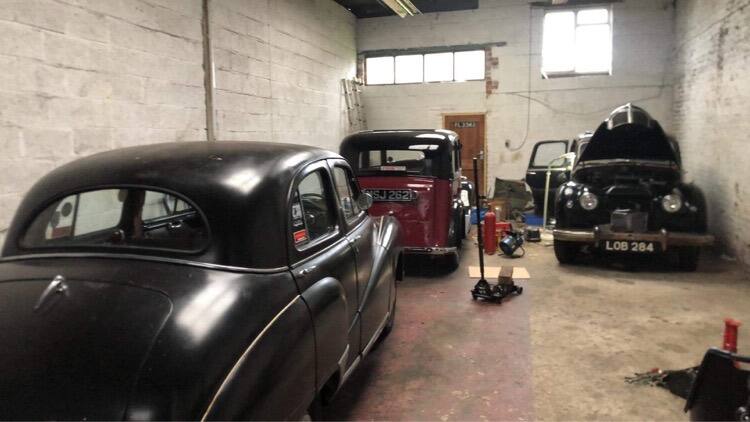

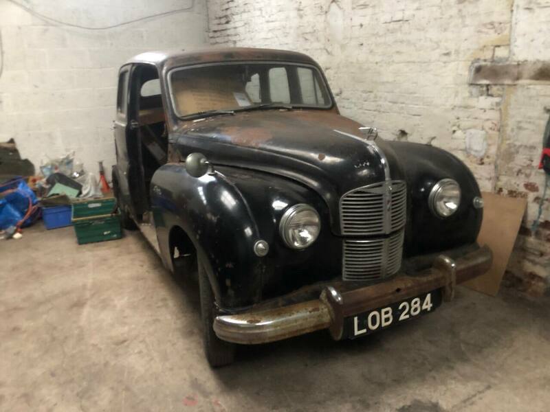

Having got the Hampshire up on the ramp and had a proper look under it for the first time (without lying under it) I'm going to have to admit defeat on this one.
The chassis has gone in several places that will be hugely difficult to repair, plus most of it is so deeply pitted all over it's clearly lost a lot of its structural integrity. It's gone all around the front suspension mounting including right up the inner box section of the chassis which you can't get to to cut the rot out without cutting out most of the outer chassis, the steering box mount (including both sides) right down the side where the master cylinder is attached, and where it loops over the rear axle.
I can buy a good chassis from the club but there's a huge amount of work to swap everything over, plus the entire body is so rotten it would need substantial bracing, then I've still got to tackle the incredible amount of rust in the body. All inner wings, bulkhead, sills, floors, even the roof has rotted through.
I need to stop being too sentimental with hopeless old wrecks, those who said it was too far gone were right. I'm a brave restorer but this chassis rust was the straw that broke the camel's back for me.
I was quite upset at first, but then I spoke to my Dutch Austin mate and we have come up with a solution, which is what I should have done from the start.

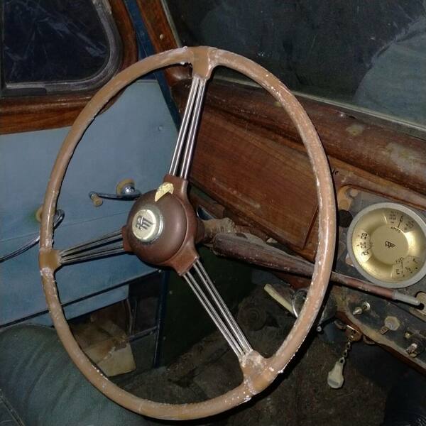

He has a Hampshire in his barn, bought as a spares car for his Atlantic restorations. It's a left hand drive Dutch export model, but has been off the road since the 1970s with the engine dismantled. Good news is this one has been dry stored so it's not too bad.
He wants to keep the engine and box, the dash plastics, the rear anti-roll bar, and the steering including the rare left hand drive specific steering idler which he needs for one of his Atlantics. He also wants my spare Atlantic diff I've been tripping over for the last ten years, and the brown front seats out of LOB. The rest he's offered to me for a reasonable price.
LOB has a good low mileage, running engine and gearbox which I can swap over, along with the other parts he's removed.
The good news is this one appears fairly solid from the photos he's sent - all the doors are good, as are the floors, A posts and rear wing flanges.
It needs welding to the backs of the sills and a bit on the strengthening brace behind the front panel. He reckons the chassis is sound.
One rear wing is patched up, but I have a new wing to fit and the wing mounting flanges look perfect from the photos he's sent inside the boot.
The interior looks quite good, the mice have got at the headlining unfortunately, but the blue leather seats look alright. It's got a good steering wheel which is a £300 refurb saved straight away.
These cars were made so they would be relatively straightforward to convert between left and right hand drive with the instruments in the centre.
He wants me to fly out to Holland and take a look but I don't know when I'd get the time to do so. He's going to get it out of the corner of his barn and take some more photos for me, but it looks pretty solid from the photos he's sent already.
I think this is a good solution, making one good running Hampshire out of two knackered ones.
What do you think?
