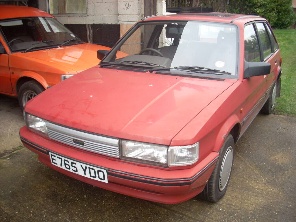

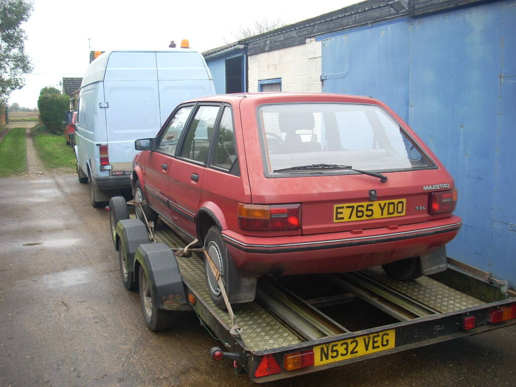

However, the real reason for this post is that this morning the first collection of 2020 occurred.  A quick 20 mile blat up to Holbeach, and I returned with this:

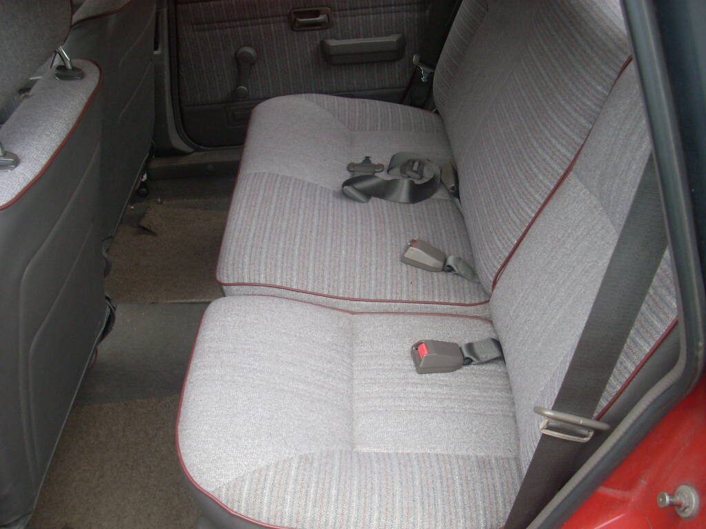

I do like the interiors in these (rear seats photographed due to grubbiness of fronts!)
Owned by a 96 year old since 1998, he took it to fill up with petrol in the Autumn and it wouldn't restart.  Garage reckoned it had 'lost compression' and (allegedly) took the head off, fitted new valves etc, put it back together and it still wouldn't start! Hmm, it's an A-series that was running two minutes before it wasn't.  Anyway, grandson persuaded Grandad that it was time to part with it so here it is.  Has Grandad given up driving?  Oh no, he now has a Micra!  And I just hope he didn't put diesel in the Maestro...

If I can get this one running it will be up for sale ?  Still has MOT to August and apart from the nsr arch seems a solid old thing, even if a bit scabby.
That looks a lot better then I expected, a two bucket wrong un session should see that looking good.
Fingers crossed for the fix. Does it look like they took the head off?

I suspect not.  Appearance and odour of the coolant suggest no antifreeze (just rust), and the rocker cover gasket is clearly very old and leaking the usual copious amounts of oil.  If it has been off I really hope they didn't re-use the head gasket as well!

A-series models did have the auto* choke as well, but as with most this one has had it replaced with a manual set up at some point in the past.
Will hopefully get some time on it tomorrow (although should really finish the Allegro first), starting with my own compression test.

Back to the Maestro; I can't work out the seller's story.  But for the fact his grandad has apparently now got a Micra I'd think they'd cooked up something with the garage to get him off the road.  The head definitely hasn't been off but the starter was dead; two separate faults, a non-functioning solenoid and very lazy motor.  Luckily a friend who stores some of his spares here, including a Maestro starter was staying last night (he should be on here but isn't).  Swapped over and it started up a bit reluctantly and somewhat smokily.  Compressions are tolerable on all cylinders; typical of a slightly worn a-series really.  Drained the excess oil which has helped a bit and had a quick fiddle with mixture and idle speed, both of which are obviously way out.  More fiddling and a service planned, but at least it now moves under its own steam ?

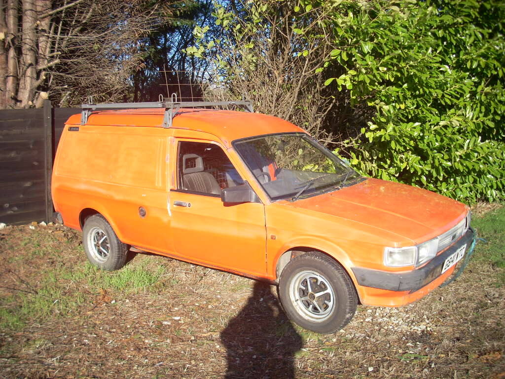

Any excuse to add a photo of my Prima engined Maestro van ?
Is there a thread where I can read about this and perve at more pics?
