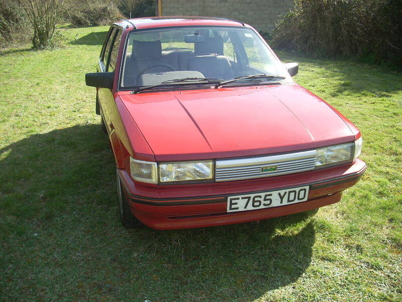

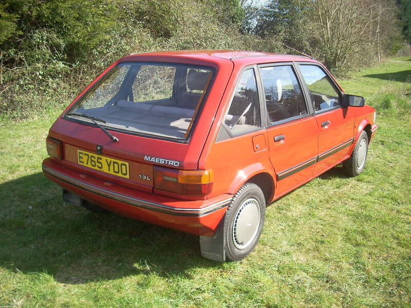

With wonderful timing the Maestro is finished (well, as finished as it will be in my ownership) and ready for sale!  It ended up having a new nearside rear arch welded in as the original predictably fell apart when I took the underseal off the visible bits.  The interior has cleaned up really well, although the outside of the driver's seat bolster is a bit squashed, presumably from the 96 year old former owner levering himself in and out.  I got hold of a second hand carburettor from a friend and it now seems to run well, although the plan was to tax for April to do some on road testing before passing it on.  Suspect I'll end up having to re MOT in August now, so I just hope that doesn't throw up any nasty surprises.

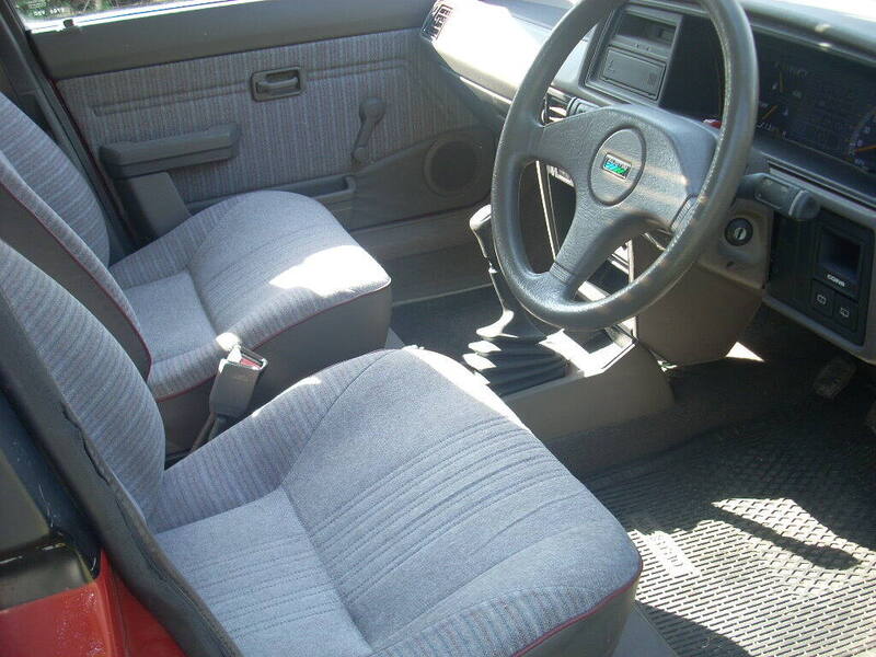

The photos flatter a bit as usual (the paint on all arches is imperfect), but here it is now:
If anyone is actually interested in buying it (I'm looking at @aldo135 in particular) then please get in touch and we'll see what can be arranged for when circumstances change.

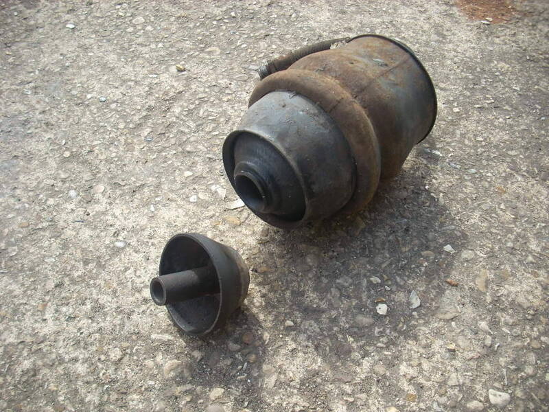

I will write an update on my (currently losing) lockdown battle with the green Austin 1800 at some point.  But for a taster, can you spot anything wrong with this displacer?
Going by the picture title, it's a blown displacer. ;)
Hose split? Or internal rubber diaphragm has gone?
The cup and tube thingy should be inside the displacer!  When reinflated the diaphrapgm (although it's less of a diaphragm in hydrolastic cars compared with hydragas) thought about if for a bit then gave up with an almighty bang, forcing the aformentioned cup thingy through the much smaller hole in the rubber end of the displacer (the hole you can see in the photo).

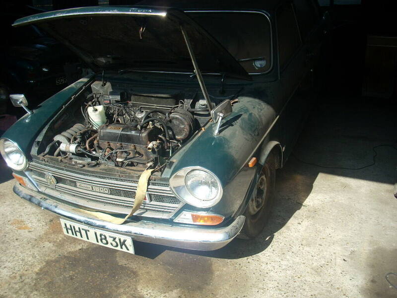

So, the story with the green 1800...  I bought it in 2006 when living in Bristol.  It was a local car, bought new in 1972 by Albert Eustace MBE who kept it for 20 years.  He was presumably responsible for the colour change from Wild Moss to Mallard Green (possibly even done by the supplying dealer as Wild Moss must have been very old stock by that point) and for the hand controls it had fitted.  The mechanism for the brakes is still in place, other than the lever on the steering wheel (see photos below).  The second owner had it from 1992 until I bought it.
I used it quite a bit for 18 months then laid it up, mainly due to the oil consumption!  After moving to Norfolk I had it MOTd again in 2009, but a few miles later both front brakes started sticking on badly; it just about achieved 40mph with a horrendous smell of burning brakes getting it back from Wisbech.  So it got laid up again.  In the intervening 10 years both sides of the suspension went down.
Fast forward to Covid-19 days, and I've dragged it out to give me something to play with.  Both sides of the suspension were down due to corroded pipes, so when I found the club spares chap sold flexible pipes at a good price I jumped at the chance.  Unfortunately both leaked under pressure from the base of the schrader valve (which with the new pipes screw into an intermediate fitting between pipe and displacer) so have been returned for replacement.  Unfortunately as my pump connector leaks a bit anyway I didn't notice until I'd put a lot of lovely fresh fluid in.  And as covered above, the rear displacer on one side then went bang quite spectacularly.  So a new displacer should be accompanying the replacement pipe fittings.  I should probably also mention that when removing the displacer one of the bolts holding the cradle sheared.  Ho-hum...
So that's about it.  Brake master cylinder has been removed and I have a repair kit to fit.  Both rear brake hoses have collapsed so replacements are on order.  Front brakes are next on the agenda.  Most brake pipes (and the front to rear fuel pipe) need replacing, but that will have to wait until the local garage re-opens; they make me up pipes so cheaply it's not worth trying to do it myself.

As it's slumbered for the past 10 years:
In the workshop with it's rear in the air (rubbish photo, sorry):

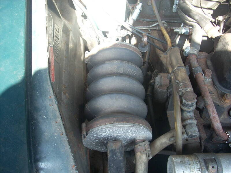

The vacuum operated bellows for the hand-control brakes (where the battery should be).  These literally pull a rod which is welded to the brake pedal (so the driver would have been able to watch his brake pedal go to the floor when he pulled the hand control).

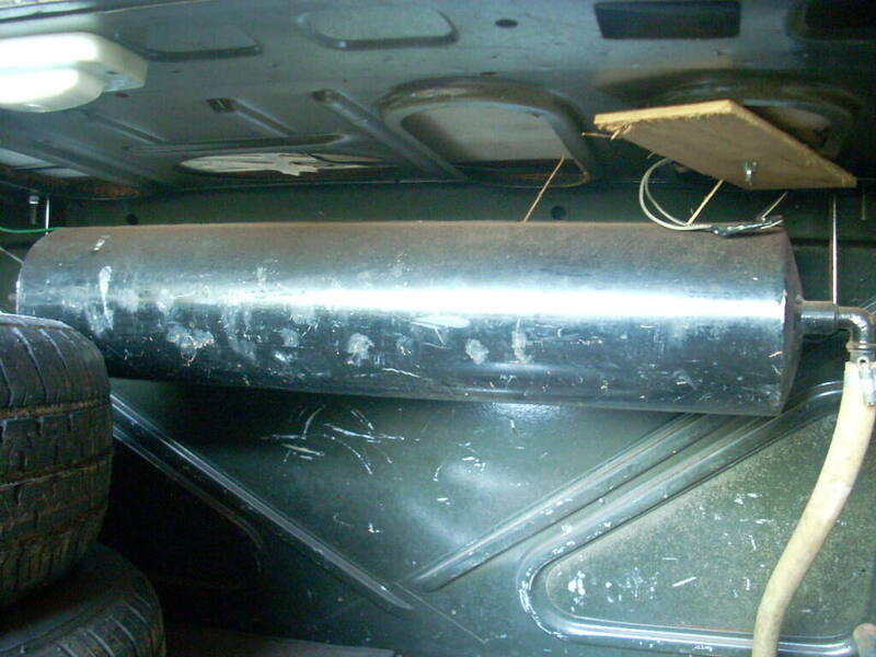

Also in the boot, the vacuum tank for operating the brakes:

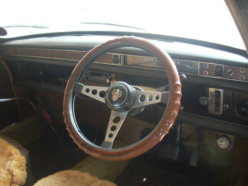

The dash and steering wheel (which it has had from new):
Indicator/lights multi-switch cranked presumably to clear hand controls (admittedly this is a guess):

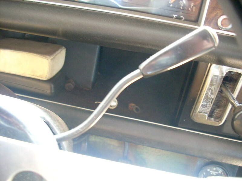

That is the best auto-box lever ever, no contest, and a large part of why a LandCrab-O-Matic is still in my "Lottery-Garage"
I imagine it probably would have had a giant flappy paddle like so  :)
Maybe, but because the vacuum system is doing all the work I'd imagined something somewhat smaller!

indeed I do find the whole vacuum operated thing a bit unusual!
I know the Model 70 does not have such a setup for its hand controls, but the Model 70 was a vehicle specifically designed and built for the disabled with such controls in mind
(well the Model 70 pictured above does have a vacuum brake booster fitted, but that's not because of the steering wheel hand controls, that would have been fitted for the previous user I suspect to make breaking as easy/light as possible, for im guessing the person had weak arms)
I have not had much close up experience with an adapted normal car of the time, so im not sure how they are setup! but i am bit surprised to see vacuum operation id of expected just a serise of linkages, linking the hand operated brake to the foot brake!
are there any makers markers anywhere? Reselco was known supplier of hand controls for adapting normal cars

I'll have a look tomorrow and try to take some more photos to show how it works.  Although as a non-smartphone owner using an old digital camera focussing on text on objects is tricky!

Sorry for the slow reply.  The only markings are on the bellows, 'F&J No 1, Made in England', but I assume this just refers to the bellows and not the rest of the system.  It's operated by a standard bowden cable, the remnants of which are still there.  This operates (what I assume is) a valve below the bellows which has two pipes, one to the bellows and the other to the union to the right of the bellows in the photo above.  A further pipe from this union goes to the tank in the boot, along with the blanked of remains of what was the pipe to the manifold.  Hope that makes sense; it actually seems quite an ingenious set-up.

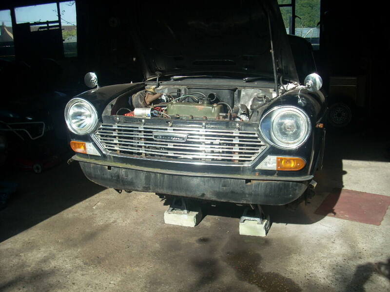

More progress on the green landcrab.  Following fitting of replacement valves for the hydrolastic pipes and a new rear displacer, it now looks like this; much happier...
The radiator, which I removed to make fitting the new suspension pipes easier has been flushed and replaced, rear brake hoses replaced (fronts seem fine) and remaining MOTable electrics fixed.  Wipers only work on fast speed but that will do for the moment.  Just need three brake pipes and fuel pipe replacing, then I can refill the braking system and see how sticky the calipers are.  Other than that, a MOT and a bit of local use later in the year beckons.  Attention will now return to the Antique gold Allegro, as I've created a new list of jobs and would like to have it ready to go for MOT as soon as the local garage re-opens.

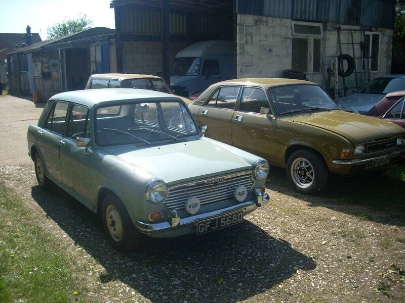

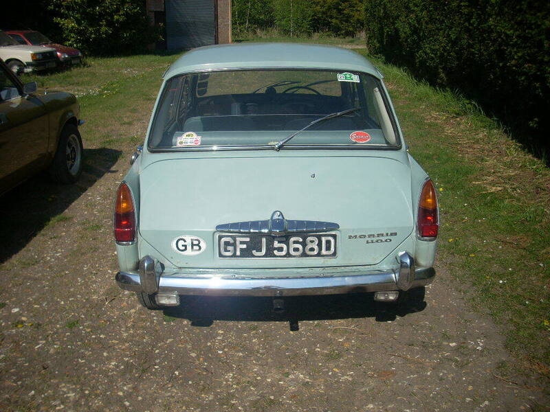

To complete the comings and goings, yesterday this arrived.  Does seem genuinely solid, albeit a bit more battered than the photos made out.  Any solid ado16 with full MOT is worth what I paid though, so not complaining.
Rear wiper bad (but interesting), as are the reversing and fog-lamps. This ain't no 1300GT!
GB sticker and flat grey-blue paint good. Headmasters at both my schools drove these, in this  colour.
I've only ever driven one 1100; it was on cross-ply remoulds and therefore did not impress!
Actually closer to a 1300GT than you might think!  1275 engine, twin carbs, LCB manifold, large bore exhaust and high lift rockers.  Has been used for historic rallying.  Appearance wise, I agree with you though.  Not sure yet which bits are staying and which are going...
