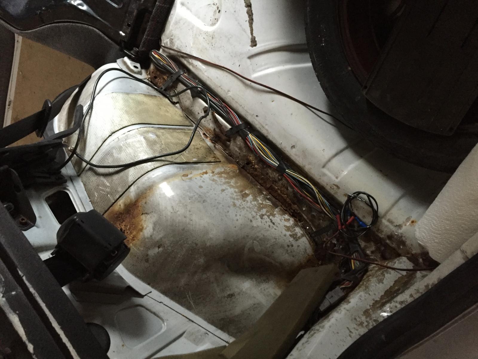

A few more pics of the rust and the start cutting out and making pieces to fit.
Have also bought a welder... though a friend is much better and more experienced so I may just stick to the very simple arch repairs to start with. Removing the old factory applied under seal stuff has taken many many hours but does result in some very good metal and some just with surface rust which is easily treated.
post-27066-0-17219700-1547673761_thumb.pngpost-27066-0-77395000-1547673778_thumb.jpegpost-27066-0-04876600-1547673792_thumb.jpegpost-27066-0-82559400-1547673806_thumb.jpegpost-27066-0-81327900-1547673825_thumb.jpegpost-27066-0-91175100-1547673836_thumb.jpeg
Refurbished rear callipers and new discs in place with new brake pipes all the way to the front. The old ones just sheared being touched. Had to take the fuel tank out anyway to be able to do the boot floor/inner arches without melting it or worse...
post-27066-0-82824700-1547673978_thumb.jpegpost-27066-0-12152600-1547674037_thumb.jpeg
Some very weird shapes!
I then made the mistake of taking the plastic side skirts off... more welding needed on the near side footwell! The black is the sound deadening under the carpet... mainly stemming from what looks like someone jacking it up in the wrong place at some point.
