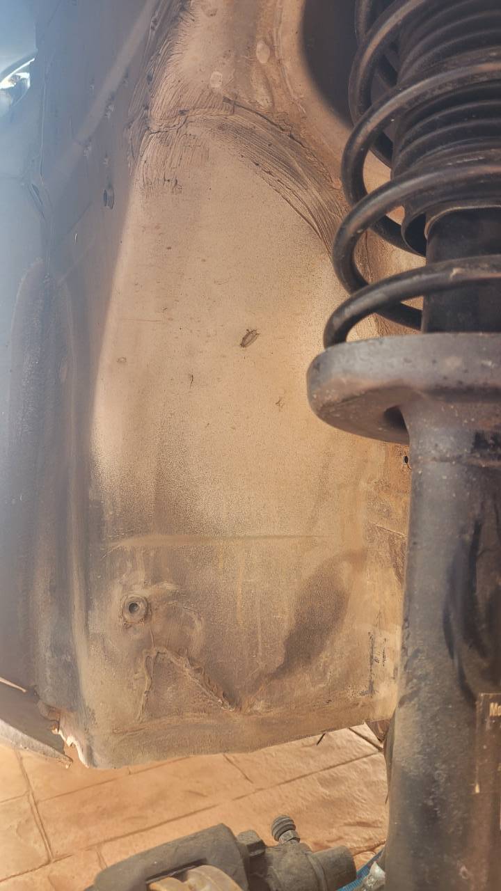

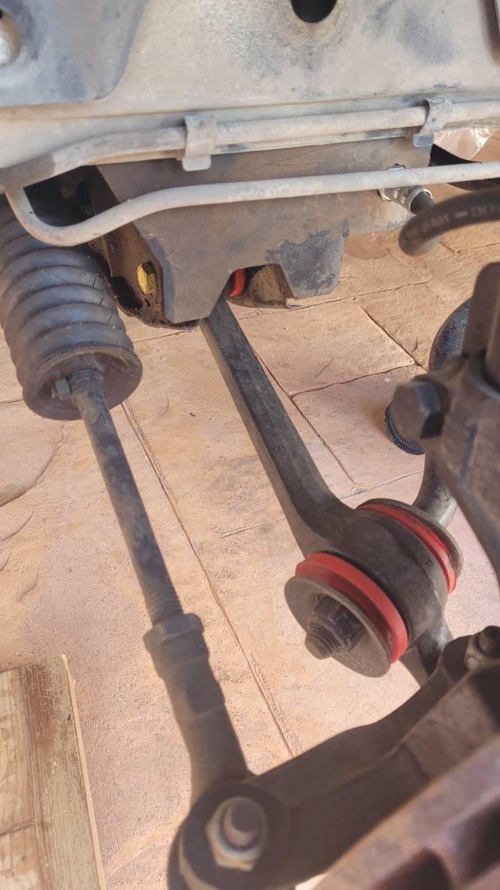

Ianlea73 Posted October 22, 2024 Author Posted October 22, 2024 Pulled the front wheels off, removed the arch liners & checked the condition of the chassis rails, strut inners & inner wings. Took some pics of the polybushes that have already been done & the condition of the brakes. Soooo much rust!!! It's crazy that the chassis is so rust free but nearly everything mechanical is knackered. I started cleaning up the rear drum brake backing plates. I'm contemplating a front brake upgrade to either mk3 mondeo & St disks or mk2 focus st225 complete set up & Redrill to 4 stud. somewhatfoolish, Dyslexic Viking, Coprolalia and 8 others 11

Volksy Posted October 23, 2024 Posted October 23, 2024 Crikey! That is rot free! Even if the mechanical aspects are a bit tired, the fact that you're not battling with rusty bolts/threads etc. must be a win for sure. tooSavvy, Westbay, Ianlea73 and 2 others 1 1 3
danthecapriman Posted October 23, 2024 Posted October 23, 2024 There’s an awful lot to be said for a good climate when it comes to cars! Living in a cold wet miserable shit hole like the UK really does fuck up anything made of steel! I remember working on my Capri before I restored it and having to constantly do battle with rusty bolts, everything being seized, everything being dirty with flaking paint and rust dust etc etc. Then what a revelation it is now to work on it now there’s no rust or dirt anywhere. Everything just comes apart easily and cleanly. It makes such a difference. Ianlea73 1
Ianlea73 Posted October 23, 2024 Author Posted October 23, 2024 Thanks guys, yep it's certainly a treat to work on a car where every bolt has come undone, no heat or chisels involved. Even all the suspension & subframes have no surface rust. A quick scotch pad & ready to remove install. I'm heading back to England this weekend so the Sierra project is passed until next year. Back onto the ltd for the winter ready to sell next year I think. https://autoshite.com/topic/57382-introducing-my-1985-american-ford-ltd-sedan/ bunglebus, Low ontime and danthecapriman 3
2flags Posted October 24, 2024 Posted October 24, 2024 That is surprisingly clean. No rust at all! Well bought! Westbay and Ianlea73 1 1
