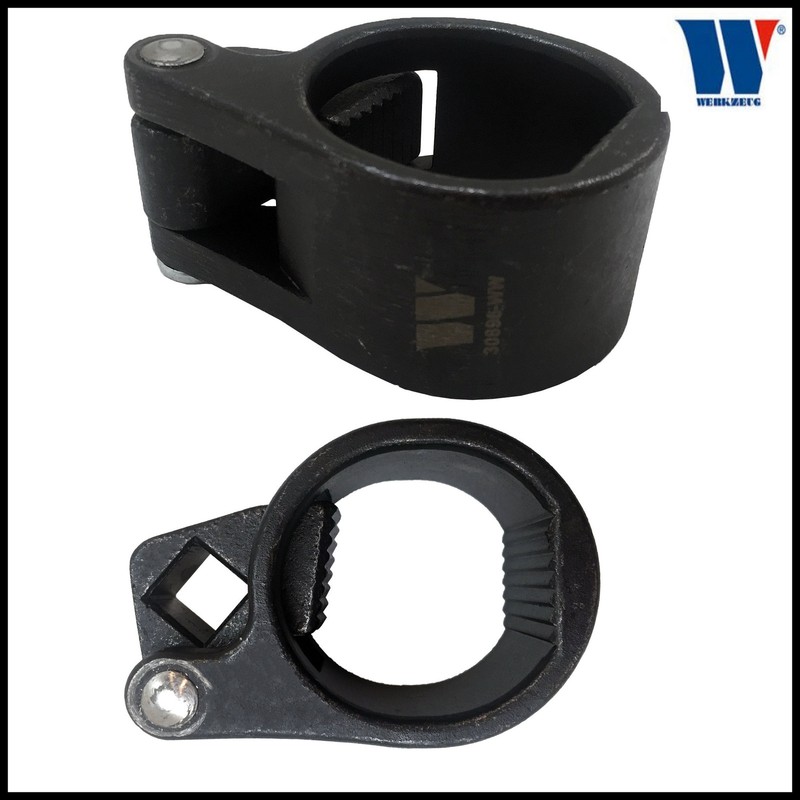

320touring Posted May 14, 2018 Posted May 14, 2018 Wuv, I've had success using a cooling fan spanner like below - they're thin jawed so can get in the gap betwixt rack end and rod - on a BMW E36, it worked superbly. Obvs, check whether the distance between the flats is either 32 or 36mm
Eddie Honda Posted May 15, 2018 Posted May 15, 2018 Yours looks to take a C-spanner, but as twosmoke300 says, you can get a cheap universal tool for the job: https://www.ebay.co.uk/itm/272333923355

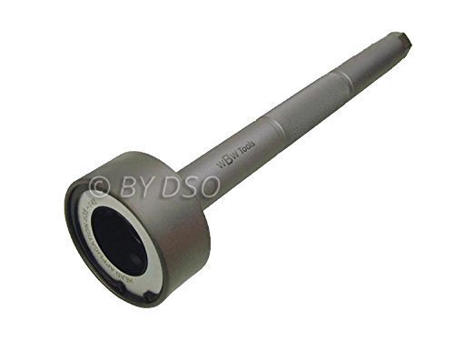

wuvvum Posted May 15, 2018 Posted May 15, 2018 Well I stuck the 205 up on the ramps when I got in from work and had a quick crawl underneath. There is no way in arse I am going to be able to get at the ball joint from underneath, with Stilsons or anything else - I can barely get at it with my fingers. I reckon if I put it on full left lock I might just be able to get my big f*ck off adjustable pliers up through a gap in the wishbone and grab a hold of it, although how much movement I'd then have remains to be seen. This is going to have to be done on axle stands though as I don't fancy driving up onto my flimsy ramps and then full locking it - the car would probably fall off. I will give it a go at the weekend, and if not I'm going to have to give up and take it to a garage - which would piss me right off after the time I've spent, and also put the cost to get the car back on the road way over what I had budgeted, but that's the way the cookie crumbles sometimes.
Eddie Honda Posted May 15, 2018 Posted May 15, 2018 Get one of these type (in the correct diameter range) then that slip over the rod. https://www.amazon.co.uk/BERGEN-Professional-Steering-Removal-Tool/dp/B006B3PT42
