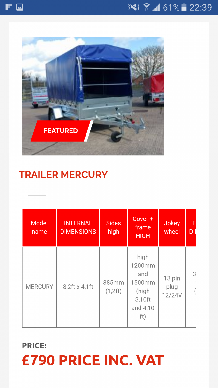

We bought the trailer we used to ship a load of our crap to BG from these guys
http://www.wychavontrailers.co.uk/cover.html
This is the model we got,and couldn't be more pleased with it
We went down with a pocket of cash and got a few extras thrown in for less than 800
Excellent - they do a small trailer for £500 and aren't that far away!
Rocking up with cash in hand the best option then I assume

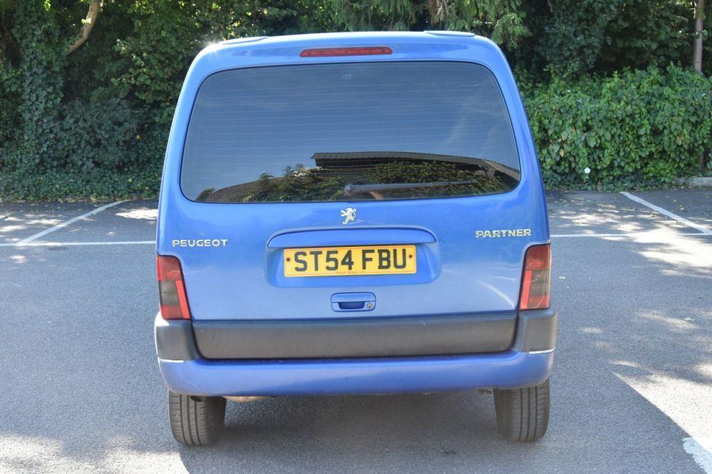

I'm assuming this is a good pictorial demonstration of a fucked rear beam?
Yup.
SIK CAMBA BR0!
We negotiated a free spare wheel and carrier by waving pound notes under their noses..
It's all Polish made,then shipped over and assembled in their yard
