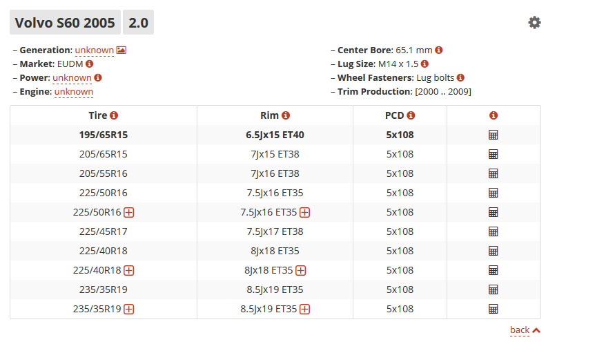

Anyway, I've got another question to those who have gone up and down wheel-sizes on their motors before.
I've found this chart...
This indicates that theoretically I could get 15s for my car, and it would look like they wouldn't bugger up the speedo's accuracy as they compensate for the larger, lower profile 17s I have on now.
I've been repeatedly tempted by higher profile tyres for the slight reduction in road noise and the relatively better ride comfort on the many rural roads I have to travel on for my job every week.
My current wheels are in relatively good condition with decent tyres, although there is lacquer peel on one of them. I'd like to keep them in as good a nick as possible, and the pot-holes and plenty of parallel parking I do makes me desire a cheaper set I can worry about less.
I check eBay sporadically, my budget is £100 for a set of four plus useable tyres which is a little short of wanting the moon on a stick but still quite demanding. However, I'm a bit concerned about 15s going too far the other way; 180hp through skinny front tyres would probably make the handling interesting.
Has anyone done a change from, say, 17s to 15s before? Does it 'work'?
I also just learnt that the alloys on a Peugeot 407 2004-2010 would fit my car, so hopefully this broadens my search a little bit.

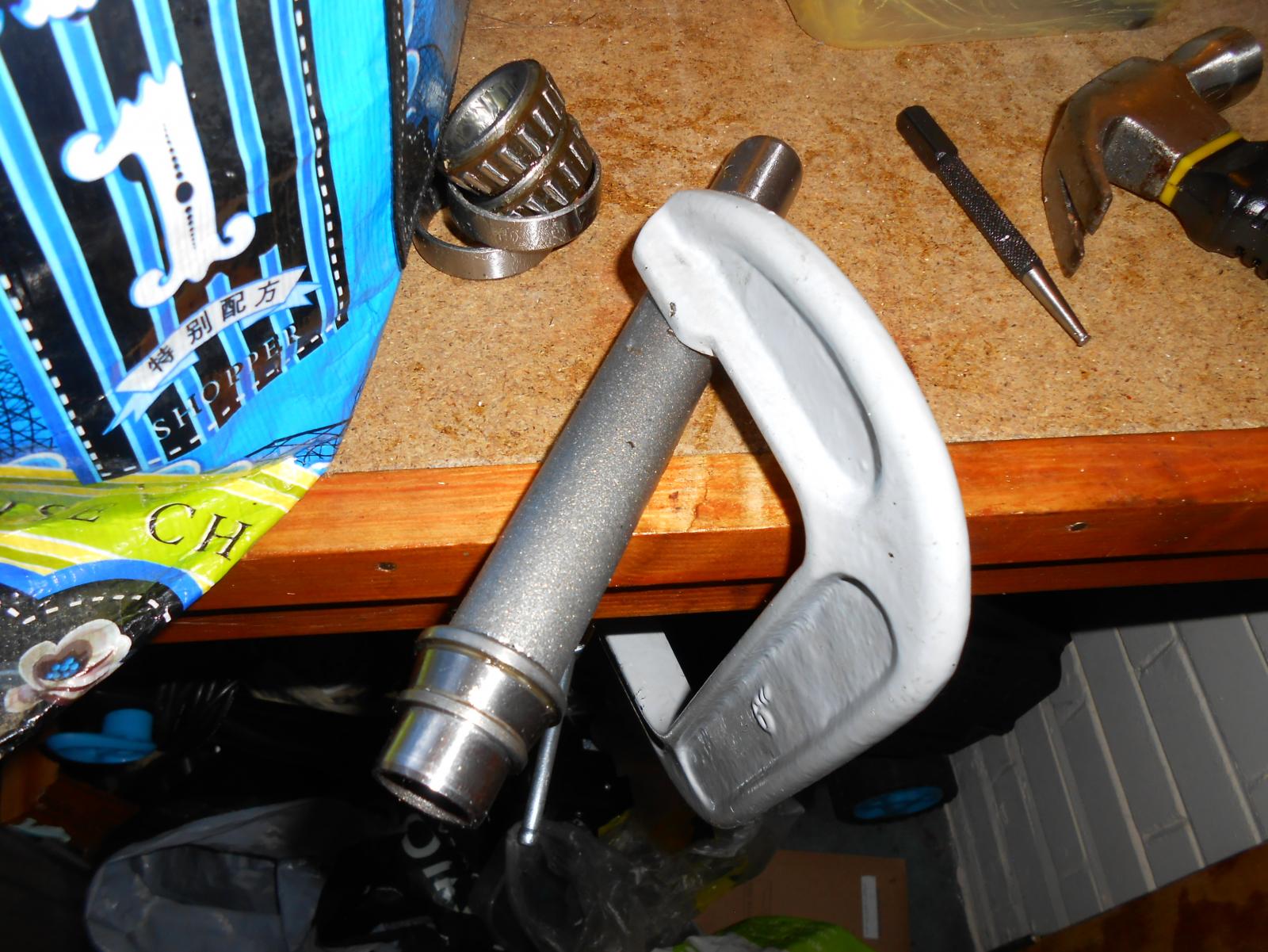

Today I've been trying to fit new radius arm bearings to my BX. Unfortunately it appears the new bearings have all the structural integrity of an egg shell and they've promptly fallen apart upon fitting, leaving me with the remains of two bearings stuck on the spacer tube. Which now refuse to move.
Currently I'm using a drift pin and hammer to remove them with no success, so does anybody have any suggestions short of cutting the bastards off?
Have you tried heating the race up with a blowtorch ? Hopefully it will expand enough for you to drift it off, before the entire arm heats up.
I did give it a going over with a blowtorch earlier with no luck. Although my blowtorch is a bit of a duffer so I suppose I could buy a new one tomorrow and give it another try.
Yes - went from 255/40 19s on my Jaaag to 235/55 17s - and it was worth it - 210ish BHP through the rear wheels.   The grip thing - slight improvement (the 17s) on similar Pirrelli tyres, especially in the wet.  The thing about wide tyres is they grip well in the middle of summer going round the 'ring, not so much in everyday use.
I remember reading an article in CCC back in the day where a guy had put a fast road 1340 A-Series in a Mini Van - he started off with extra wide wheels - then changed to narrower ones as he reckoned it improved the grip.
My Jaag had better ride and slightly better economy too - although the rolling radius was much the same, the smaller wheels weighed a hell of a lot less.
Fancied doing it on my ZT-T - but apparently the 15s won't fit as my front disc/caliper arrangement is too big - something to check.

Volvo S60 going down to 15's, whilst a nice size and cheap as chips, 195/65's don't instill much handling confidence on a powerful Merc W124, and i went the other way to low profiles (i know i should hang my head in shame) which improved it no end.
I was surprised just how comfy my sons S60 was on 225/45 x 17s, and it proved a good size for all purposes giving outstanding grip and handling.
