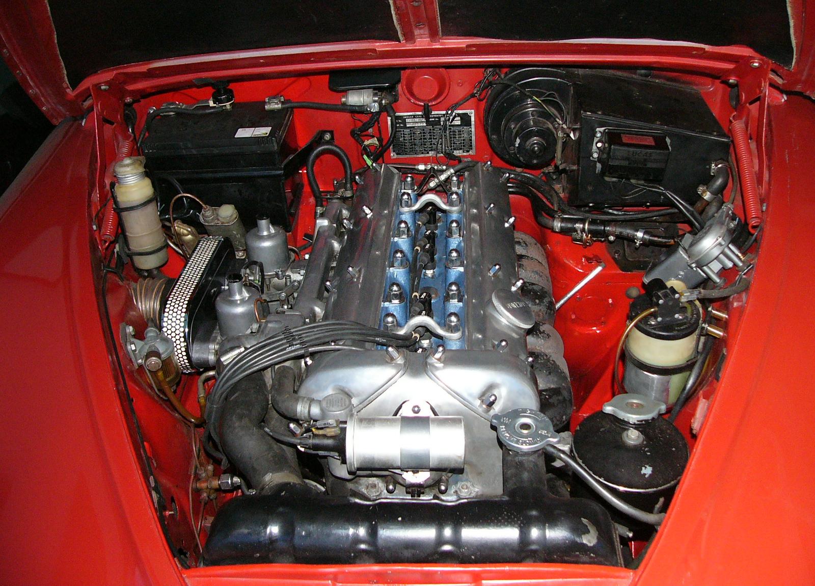

Bfg Posted February 25, 2016 Posted February 25, 2016 Exhaust Wrap - Pros. Last year I had an S-type Jaguar 3.8 ltr (1966) I called 'Flirt '. Despite bullshit, sorry bar stool, advice - engine cooling is fine on these Jags as long as the cooling system is thoroughly cleaned out and then 50/50 glycol antifreeze is used. But that six cylinder engine does heat up the rather tiny engine-bay somewhat. So.., 1. Wrapping the exhaust manifolds keeps the heat within the exhaust system until its out of the engine bay (into the under car air-stream). Less heat in the engine bay = less heat permeating through the bulkhead and gearbox tunnel into the car's interior. Heat is of course nice in the winter months.., but those old Jags tend to be flippin hot in the summer time. Not much aside from the engine like that much heat, certainly not the battery nor electrics, nor even the fluids, nor any of the rubber & plastic parts : 2. six downpipes (or cast iron manifold branches into two downpipes) at 850 degrees radiate a flippin' lot of heat. 6" away from these is the black-painted cast-iron engine block ...perfect for absorbing that radiated heat back into the water jacket. And just 2" away from the rearmost manifold is the passenger foot-well's bulkhead.. toasty toes. Then.., 6" -12" away on the inner wheel arch is the PAS reservoir, wiring & fuse box, etc.. Above the exhaust manifolds is (or rather was on my car) the air filter intake ! Again, just forward of the manifold was its dynamo with the PAS pump mounted onto it ..likewise not liking such excessive heat. 3. those that know better than I say that higher exhaust down-pipe temperatures are better for performance / engine efficiency. So the performance chaps like to keep the heat in the pipes. 4. the exhaust's twin downpipes run immediately (3") below the passenger foot well. These also radiate their heat directly through the floor. Again toasty even in summer time, especially when sitting in traffic. 5. noise through exhaust bindings tend to be less intrusive, especially wrapped around SS exhausts which often sound rather tinny. IMO exhaust note from the tail-pipe is one thing (not least because it's behind me), but I do like a quiet engine bay. 6. I also happen to like the look of the wrapping, when neatly done. Certainly its much nicer than rusting ones (see below). 7. It is very inexpensive, as well as convenient to buy and fit yourself (no send of exhausts away to be coated). Anyone wish to share with us how much ceramic coating a pair of Jag XK manifolds + downpipes cost !? 8. I'm sure there are others good reasons.. You can decide if any of these might be worthwhile benefits on your particular motor.. Personally speaking.. I'll definitely be doing so on my newly acquired car (a 1974 Shitroen) as I recommission her. Re. holding moisture. Your new exhaust should be protected from rust, if not then they can be coated with an extreme temperature paint before you wrap. Even if damp - they dry very quickly !! 'Flirt ' .. my old Jag's 3.8 litre 'slightly revised' engine bay (before lagging) : DeeJay and Rusty_Rocket 2
skattrd Posted February 25, 2016 Posted February 25, 2016 Exhaust Wrap - Pros. 1. Wrapping the exhaust manifolds ... Yes, the manifolds, but the rest of the system? and is it worthwhile on a normal car/diesel ZX?
Bfg Posted February 25, 2016 Posted February 25, 2016 "Yes, the manifolds, but the rest of the system? imo., No to the rest of the system, as the benefits of lagging (on a non race engine) are primarily to minimise the damaging or uncomfortable radiant heat from the exhaust to ancillary components in very close proximity, or the interior. Those components of course being in the engine bay. On the Jag - it's useful to take the lagging back to the first silencer box. Thereafter it's too bloody awkward to efficiently wrap, the exhaust system is in the air stream under the car, and because even the advantages of high temperature gasses being less viscous to push out of the exhaust are nil and void when a silencer box is placed mid-line ..which involves the gases expansion & diffusion within.. and is it worthwhile on a normal car/diesel ZX? " When the jag was built - it too was a normal car.! but.. Catalytic converters are very inefficient until up to their designed operating temperatures, and I understand they don't like cold engine emissions clogging them up, so yes, if the exhaust downpipes are lagged then the system should work more efficiently and cleaner. On your car's engine / exhaust layout ; I speculate that there's not much in the way of ancillaries to damage in direct radiant eye-line.., aside from the engine block / cooling jacket. So, if the engine's water temp has a tendency to overheat, then yes. Otherwise, when sitting in traffic on a hot day - Can you feel the heat coming through the bulkhead of your car ? If so, then again yes. Conversely, you might easily fit a shield between the exhaust and the bulkhead. This can be done with a metal plate (like the E-Type Jaguar had) or with thermo-lagging sheet material. At one time I clipped a welder's asbestos (or similar) pad (12" sq x 1/4" thick) onto my passenger footwell's bulkhead, adjacent to the exhaust manifold. Before fitting I couldn't rest my hand on that part of the bulkhead - even inside the car. Thereafter it was surprisingly cool. Confirming radiant heat to be the problem and not conduction (engine bay air temperatures) nor convection. Finally, the Jag's oil dip-stick was also close under the rearmost manifold. Bastard place to put it if there ever was one.! Lagging that manifold stopped further burns. If your car has anything similarly dumb design layout - then again why not ?

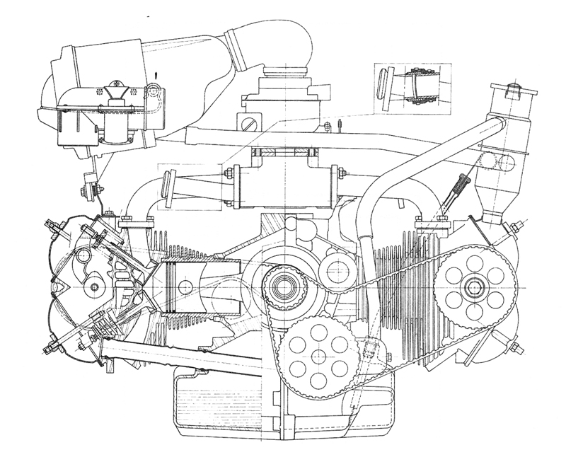

Asimo Posted February 26, 2016 Posted February 26, 2016 Looking at this cross section drawing of the Citroen flat-four engine you will see minimal space between the Closed valves and the piston crown; this is typical of "hemispherical" type combustion chambers. Bad things will happen if the cams get out of phase with the crankshaft.
Bfg Posted February 26, 2016 Posted February 26, 2016 That too was my observation.. Interferance is possibly necessary (?) to achieve an efficient combustion chamber shape with good compression, using this type of valve.. Otherwise it's a nice, tidy and efficient engine design.. shame about the plumbing.! Though twin carbs or fuel injection has been shown to loose most of those pipes. Sometime I'll have a nosey to see how Honda dealt with their Goldwing (similar ?) engine's plumbing. These engine obviously have a very low c of g., and boxer engines are also compact lengthwise. This one, being air cooled / no radiator, allows for a very low bonnet line / frontal area. The crankcases and cyl. heads are alloy, the finned barrels are iron. The front panels of the car are removable and so two people can manually lift the engine with gearbox & anxilleries out of the car. Mine is the 1015cc motor (61 bhp SAE @ 6,750 rpm / 53.5 bhp DIN @ 6,500 rpm) with 74mm bore x 59mm stroke. That pretty short stroke / high revving for a 1970's saloon car ! Max torque @ 3,500 rpm. A bugbear of ownership is that the distributor is mounted directly onto the back end of the LH camshaft - which, with the engine set low down between wheelarches, isn't easy to see into or adjust accurately. So, you take the dissy off and set the points on the bench. There are optical electronic ignition kits now available, but these are expensive. (£240+ for my car). Instead I've bought a Bransden-Boyer ignition unit (under £40 inc. p&p.) which reduces the electrical current through the contacts to mAmps. As the contacts don't burn away or become pitted - they remain accurately set for years. Oil leaks from the oil return tubes is common on this age (42 years) of car, as the o-rings were rubber. Replacing these for Viton pretty much sorts that out, but to do that - the heads have to come off. So then it comes down to cam-belts ; every 24k miles (40k km). The famed areodynamically efficient Citroen GS has hydraulic suspenion ..which seems to scare the b'jeepers out of anyone who's not familiar with the set up. Mine (an Ami-Super) has the beefed up / stiffer version of the 2cv / Dyane / Ami-8 setup, with seperate chassis. Its front brakes are the same as the 1220cc GS model, and the rear brakes are common to the A-series vans. oops sorry.., I'm rambling on here.. Shut up Pete ...go do some work updated 1st March : I've started a new thread re. my Shitroen< http://autoshite.com/topic/23665-yugoslavian-ami-continuing-on-from-now-autoshites-flimsy-bodied-shitroen/ >
