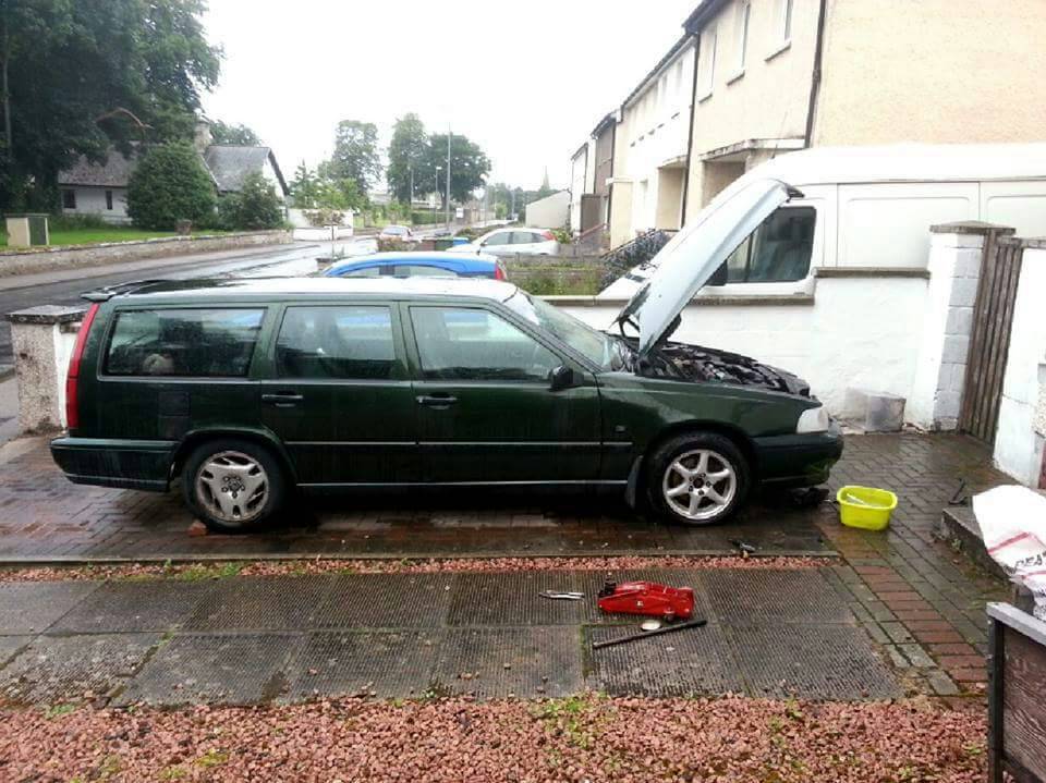

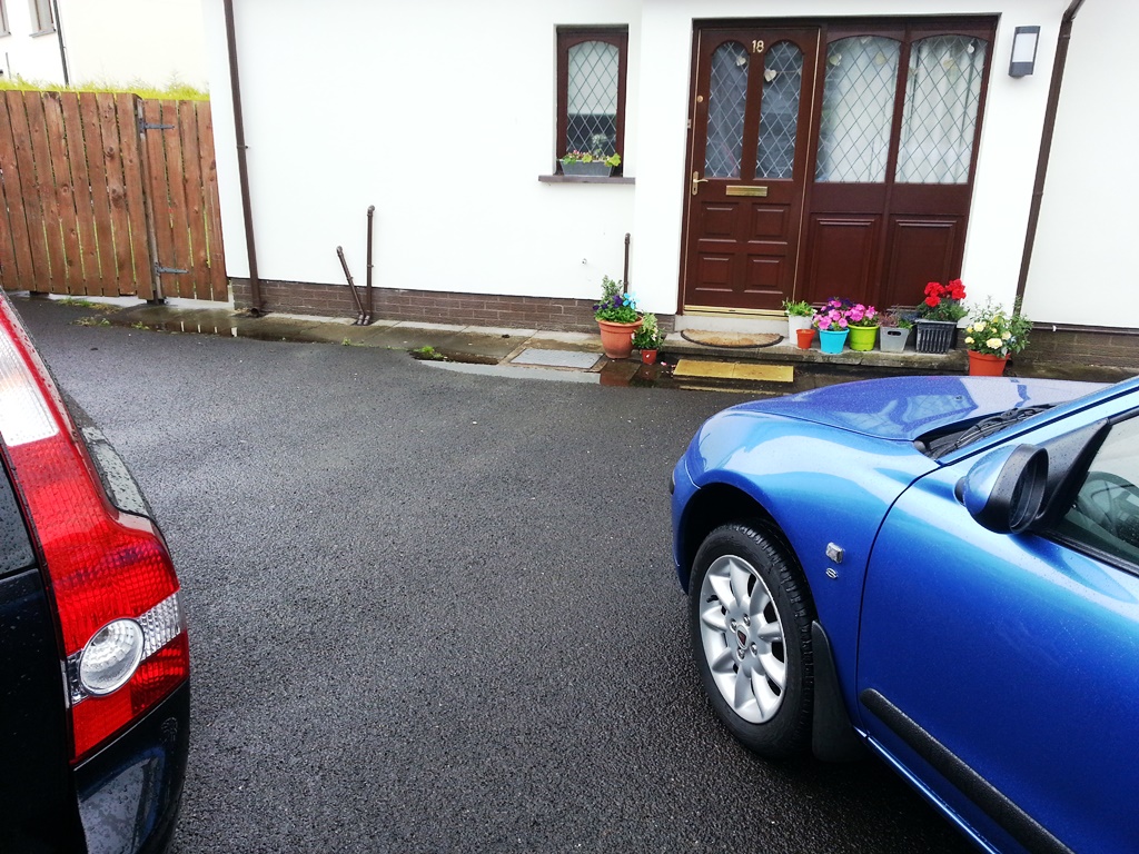

saucedoctor Posted July 11, 2015 Posted July 11, 2015 Having had a swimming pool in the driveway of my previous gaff, I now have a feckin moat at the front of the current one. There is too much tarmac on the surface of the driveway (it has a distinct hump), and the flags in front of the house have dipped adjacent to the tarmac, thus creating a Vee in which the water gathers. I cant put a freshwater gully into the silver-covered drain, cos that's what the downstairs bog empties in to (not allowed, apparently). Any time my sister comes round with her kids, we have to lift them into the house, bless 'em.Short of having the driveway dug up and fixed, no-one knows what to do. Balls.Anyone here got any thoughts?Cheers all.

catsinthewelder Posted July 11, 2015 Posted July 11, 2015 Could you replace some of the slabs with something that would allow the water to drain through, even take a couple up and plant a small bush. It would obviously be very naughty just to drill a hole in the drain enclosure and let the water dribble in. saucedoctor 1

saucedoctor Posted July 12, 2015 Posted July 12, 2015 Could you replace some of the slabs with something that would allow the water to drain through, even take a couple up and plant a small bush. It would obviously be very naughty just to drill a hole in the drain enclosure and let the water dribble in. I like it. Thank you sir. If I drilled into the collar from the inside no-one would know.
saucedoctor Posted July 12, 2015 Posted July 12, 2015 If you wait long enough, and if the slope is in the right direction, you will find that Scotland and northern England are rising compared to the south. Something to do with the last ice age. Might take a while though. The Autoshite Effect in action. Despite there being a tiny bit of Volvo in the photo, I'm not in Scotland. Not far away, though. :D
Honey Badger Posted July 12, 2015 Posted July 12, 2015 I like it. Thank you sir. If I drilled into the collar from the inside no-one would know.Don't do that, the hole that lets the water in will also let the smell of the drain out. You can run some aco drain to the foul waste, it just needs to go through a trap with a wet sump on it, just like the bog. Cheapo option is to drill some holes at the lowest point where the water collects on the join between tarmac and slabs, it will allow the water to drain away. saucedoctor 1
saucedoctor Posted July 12, 2015 Posted July 12, 2015 Cheers, HB. Appreciated. I have a builder coming soon. to extend my back sitting room. He had no useful advice on the drainage problem when I asked him, but I'll put your suggestions to him. Ta.
